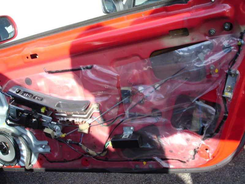

What on earth is this, and where does it go? How does it attach to anything because there's no screw holes for it :confused:
Where does this screw to? It's loose and is the thing that kept banging every time I slammed the door :smash:
A bomb that got disconnected?
Have no idea what the first thing is. The black box at the bottom is a relay for the windows.
Screws into the door below the handle bracket.
Cheers Si I'll take a look when I put it all back together

First pic, It's not a receiver for an aftermarket alarm is it? Just an idea as I haven't seen that before.
Got my door cards off at the moment will have a look see and will report back with pic's
I'm not sure - I'm pretty certain its nothing to do with the system I have installed at the moment, but perhaps its an old alarm or something.

As Si said it is the door relay, searched hi and low with my flexable mirror thingy in the door skin and couldn't find anything like the other pic I'm afraid,
Wouldn't think its after market as the connector looks OEM to me, unless it's unique to the Jap cars?

Alarms siren, original Nissan fit on some zeds, have seen them before but not many.
