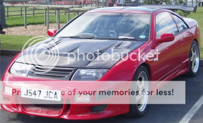

This is how my 'Z' used to look on completion of Phase 2:

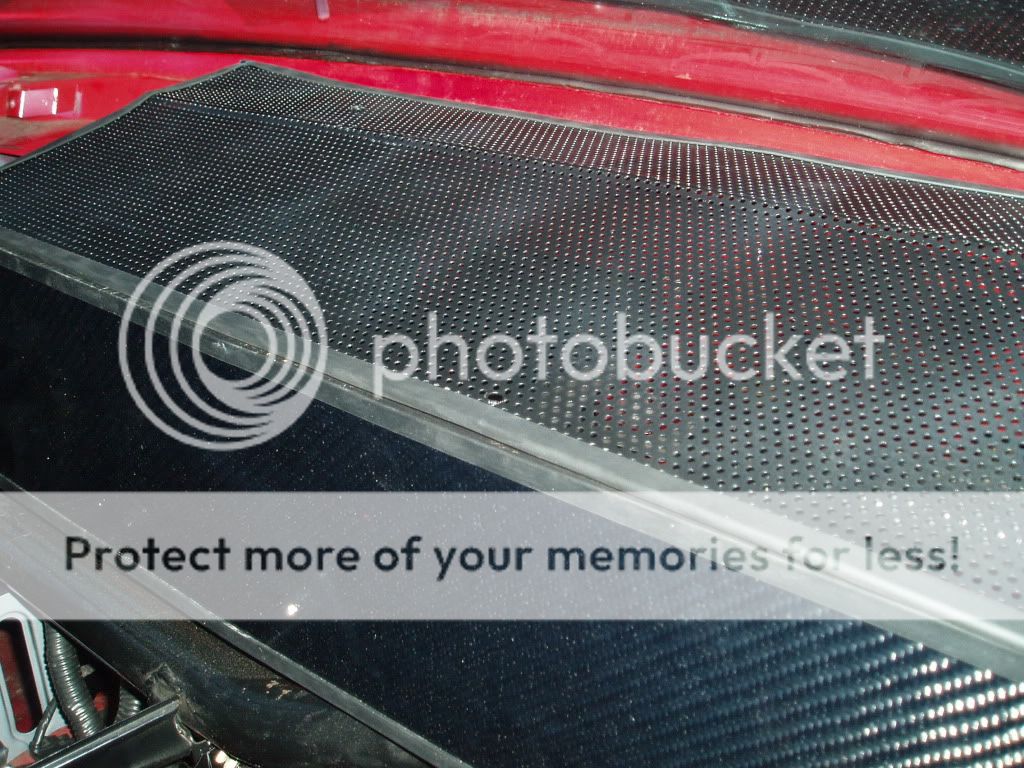

Carbon fibre/Mil.spec aluminium half dash, NISMO GT shift knob, C's JAPAN short shifter kit, the Personal 'OZ RACING' limited edition steering wheel (1 of only 500)was a Christmas present fro my wife.

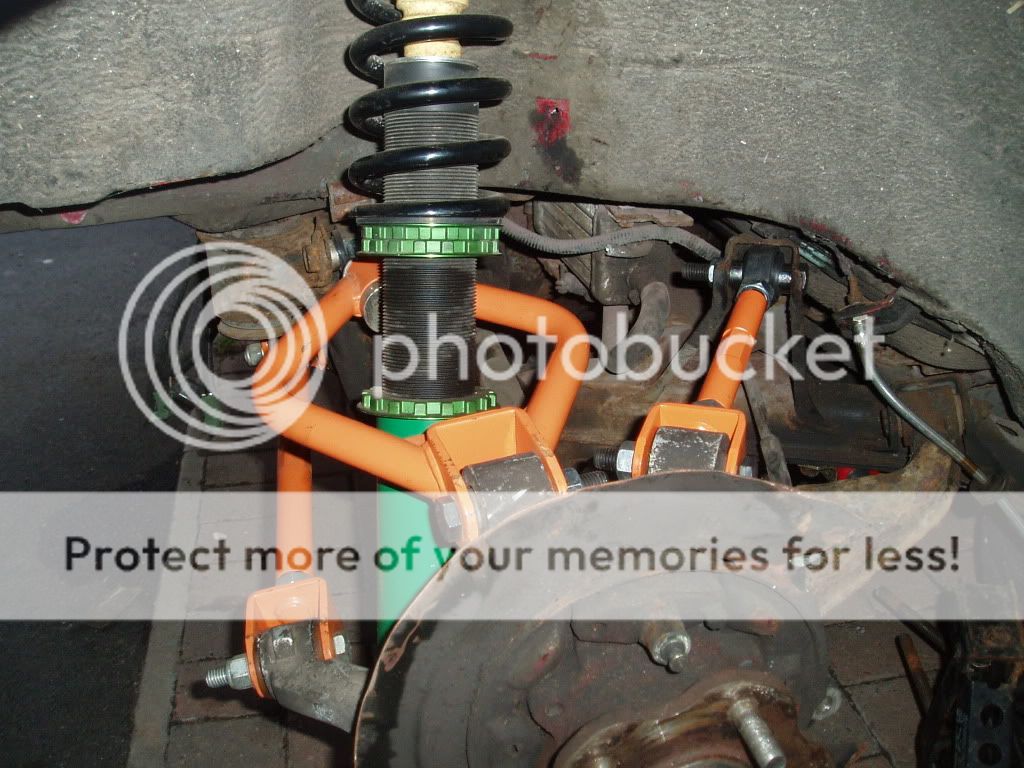

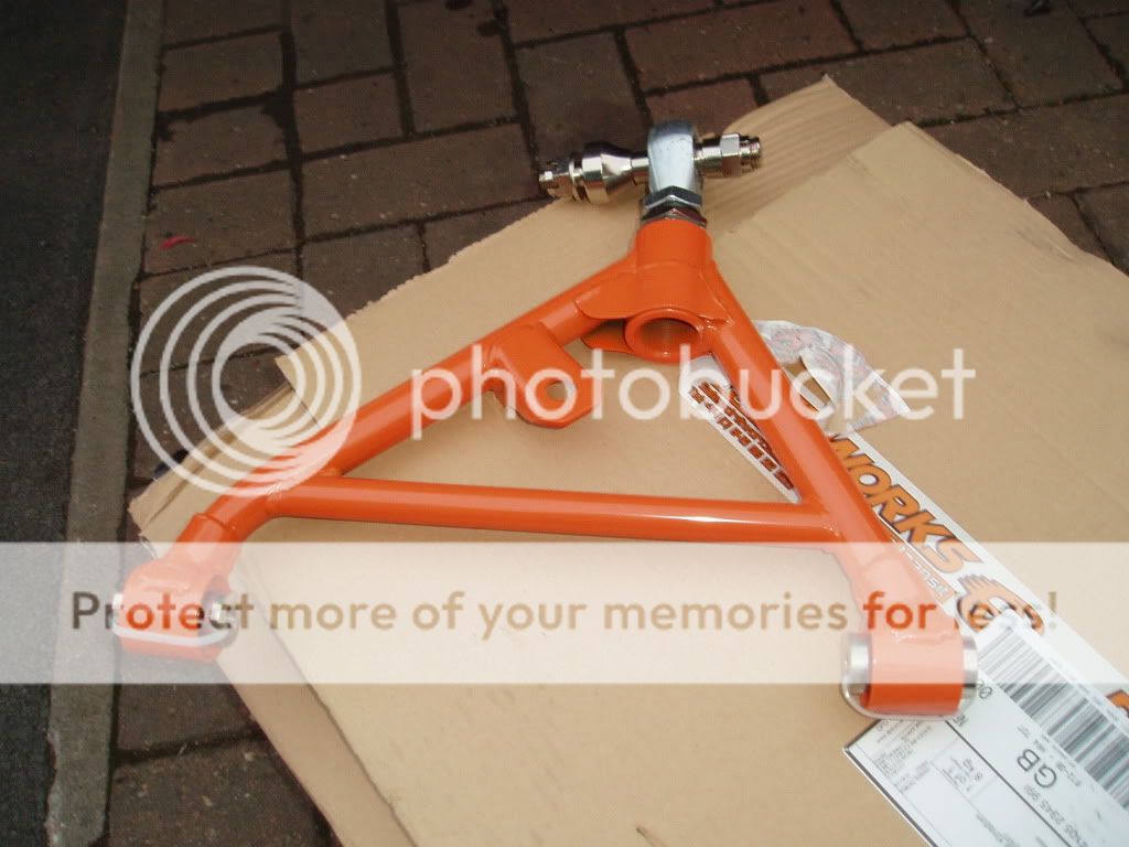

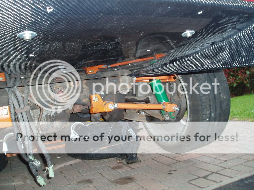

Loads of DRIFTWORKS goodies, TEIN TYPE FLEX coilovers (with EDFC), STILLEN anti roll bars, CZP & WHITELINE droplinks

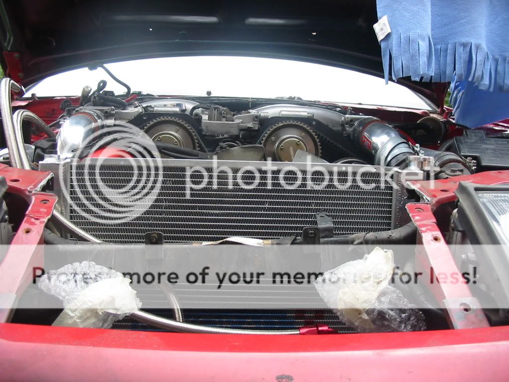

Twin JWT pop chargers and Z1 Doolz kit, HEL 19 row oil cooler, twin Bailey BOV's (some tatty looking SAMCO hose in there at the mo that'll need replacing shortly)

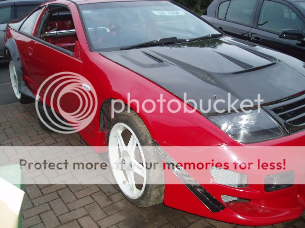

Z32 balancing on 2 x space saver wheels....not really.... obviously just extra safety measure if 4 tonne axle stands don't surfice.
Carbon fibre overfender just tacked on to cut and prepare mould for custom carbon kit.
Quite lucky with the Volks offset, as they are a perfect fit for stock arches, the brakes (not fitted in the pic) push them out a bit but I need to play with the geometry and possibly add spacers on the rear.

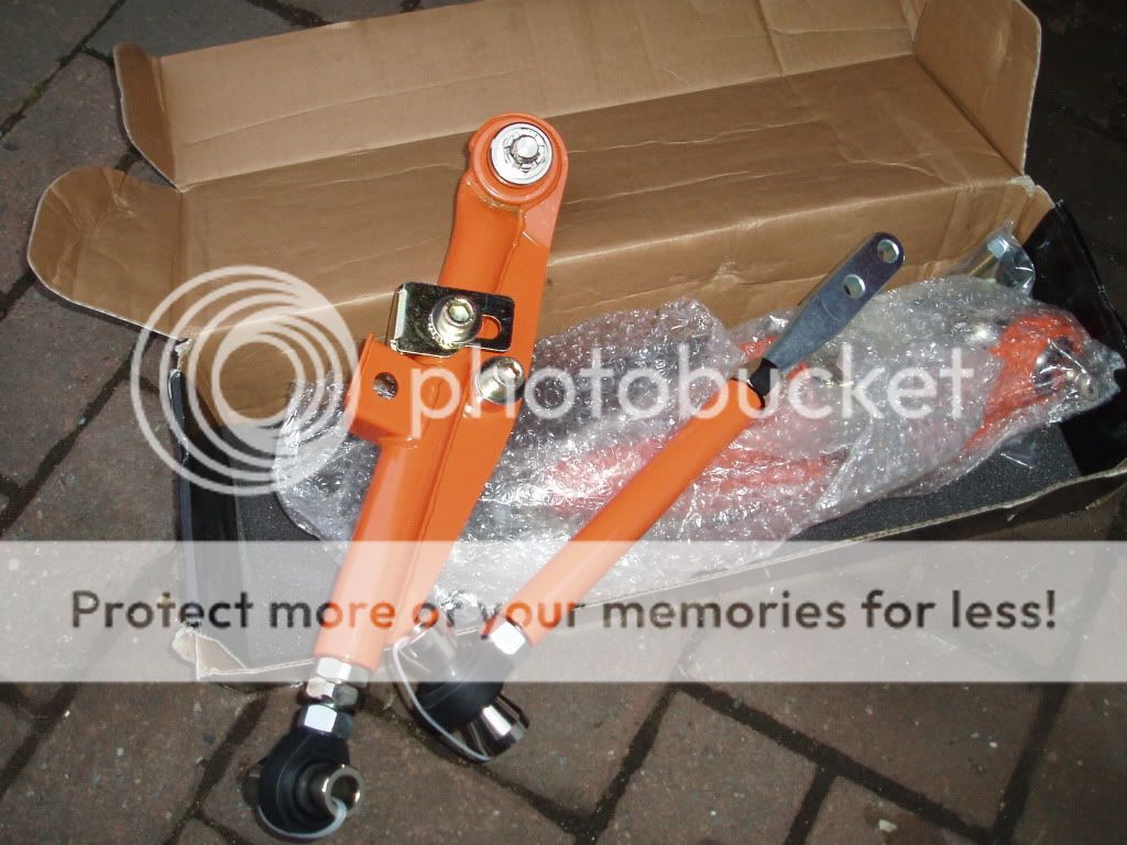

Carbon fibe rear diffuser (I should have all of the front and rear lower arms replaced with the DRIFTWORKS parts within the week)

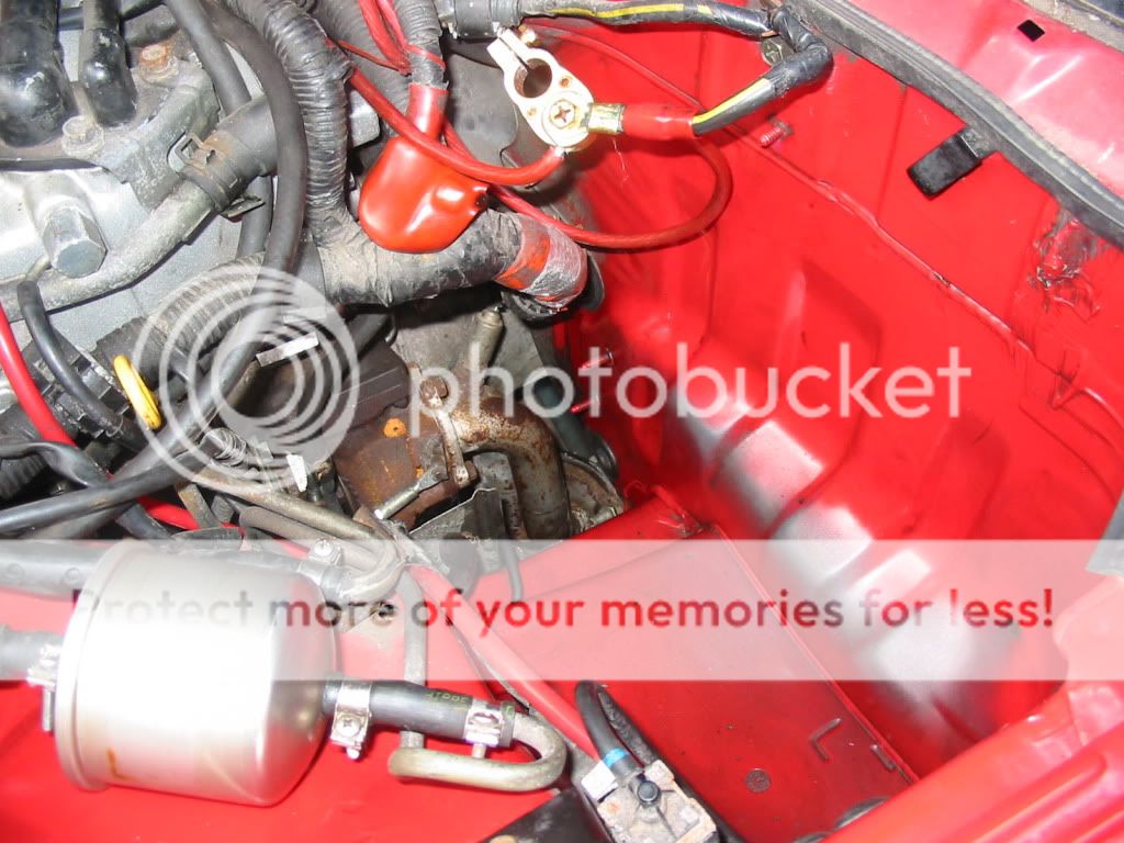

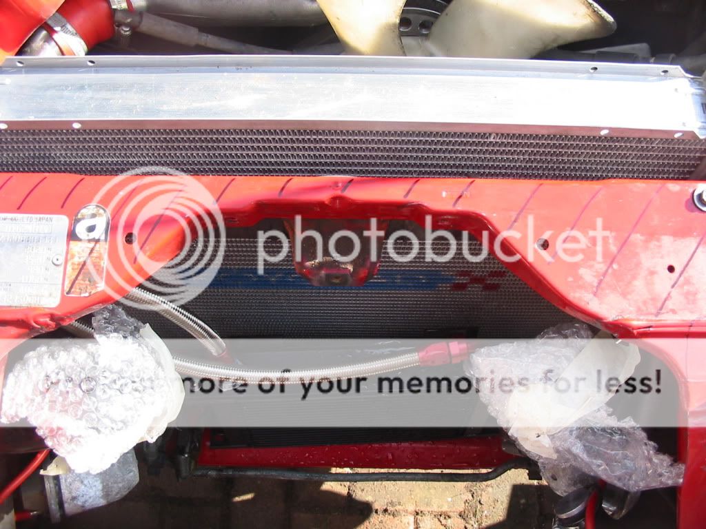

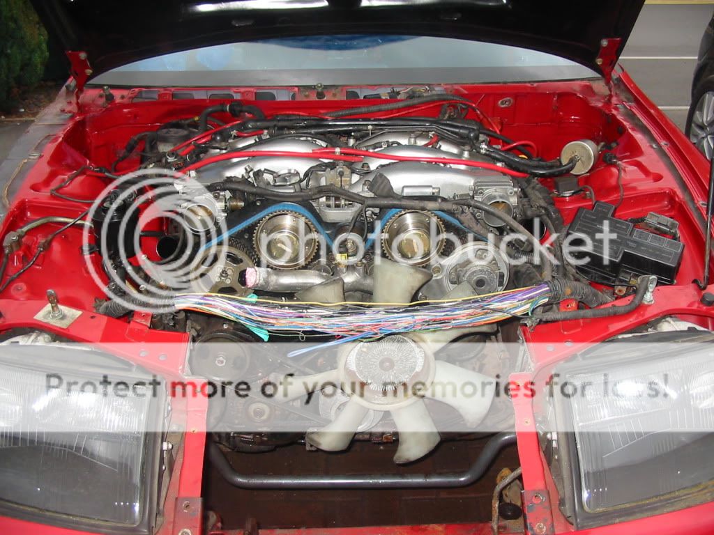

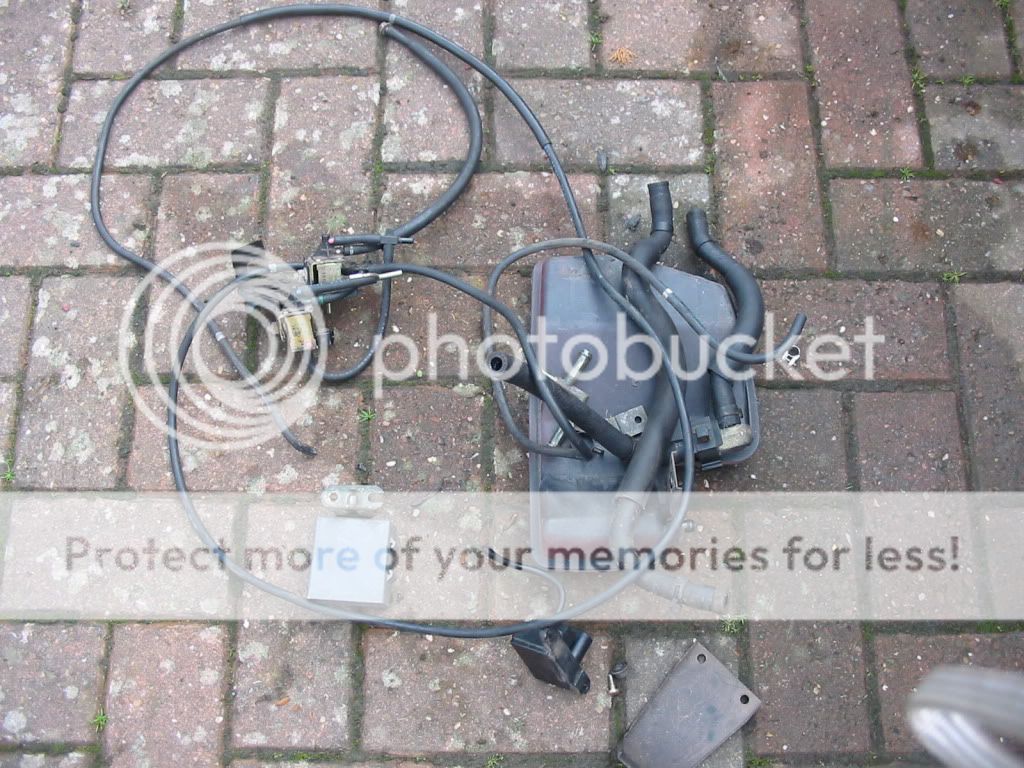

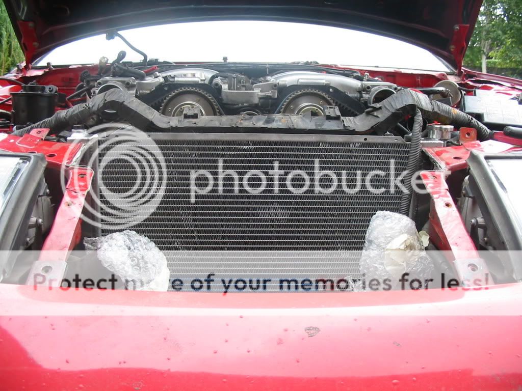

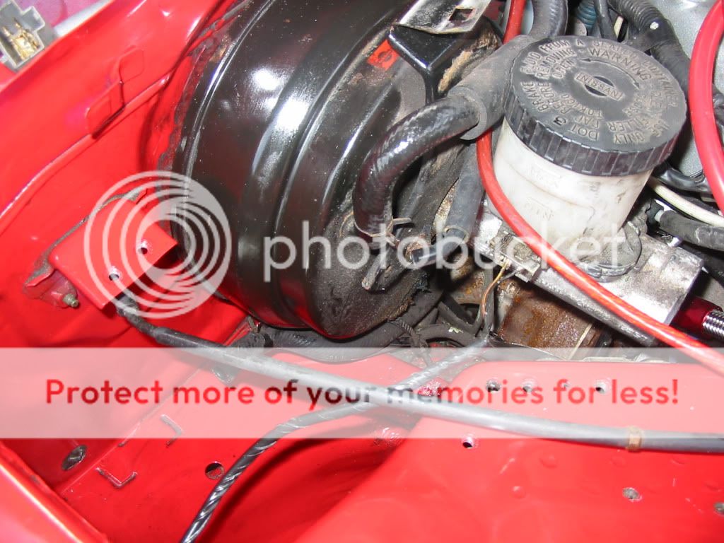

I got up early this morning to get cracking and strip the EGR solenoid, AIV solenoid, clutch and brake booster crap out

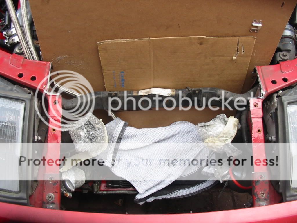

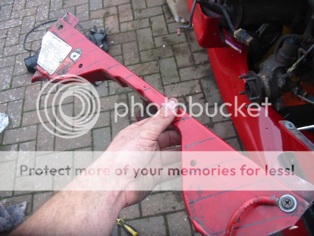

I then marked up the slam panel where I intended to cut it out.

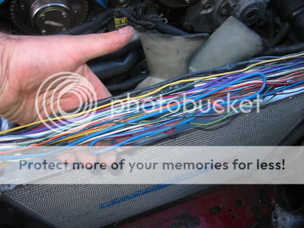

The loom runs under the slam panel so I dropped this well out of the way before starting cutting
The plan is to re-house the mass of wiring inside a new protective sleeve and then run it across the top of the radiator
I was toying with the idea of removing the radiator prior to cutting, but opted in the end to leave it in place but protected.
This worked out well in the end, as it only requires the straightening of a few fins and it will be as good as new.
Shortly after finishing the cutting the heavens opened up and stopped play!
By removing the slam panel and re-locating the loom I've removed 4-5 inches of air flow restriction to the radiator.
Both the fmic and radiator will benefit, maximising the direct air flow supplied by the vented front panel.
The oil cooler/s will now be re-located where the smic's used to be

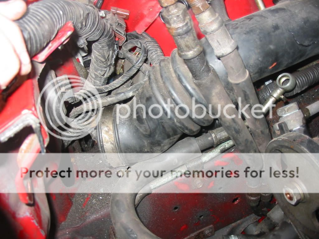

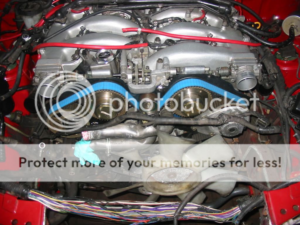

The fun begins!
This lot will now be encased in a protective heat resistant sleeve and tucked out of the way on top of the radiator

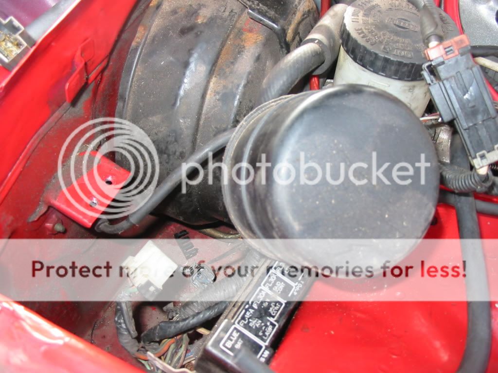

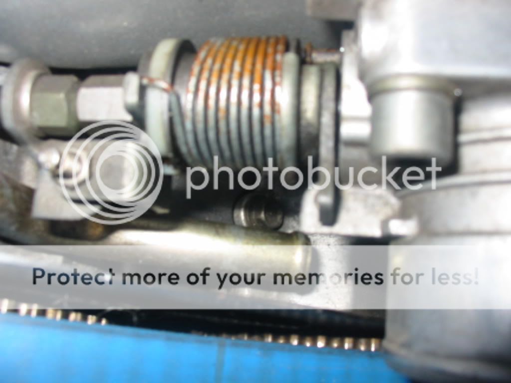

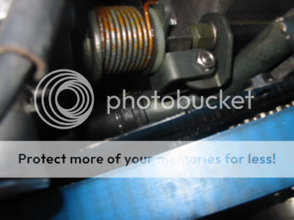

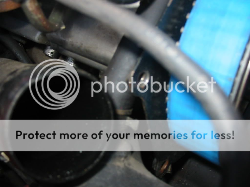

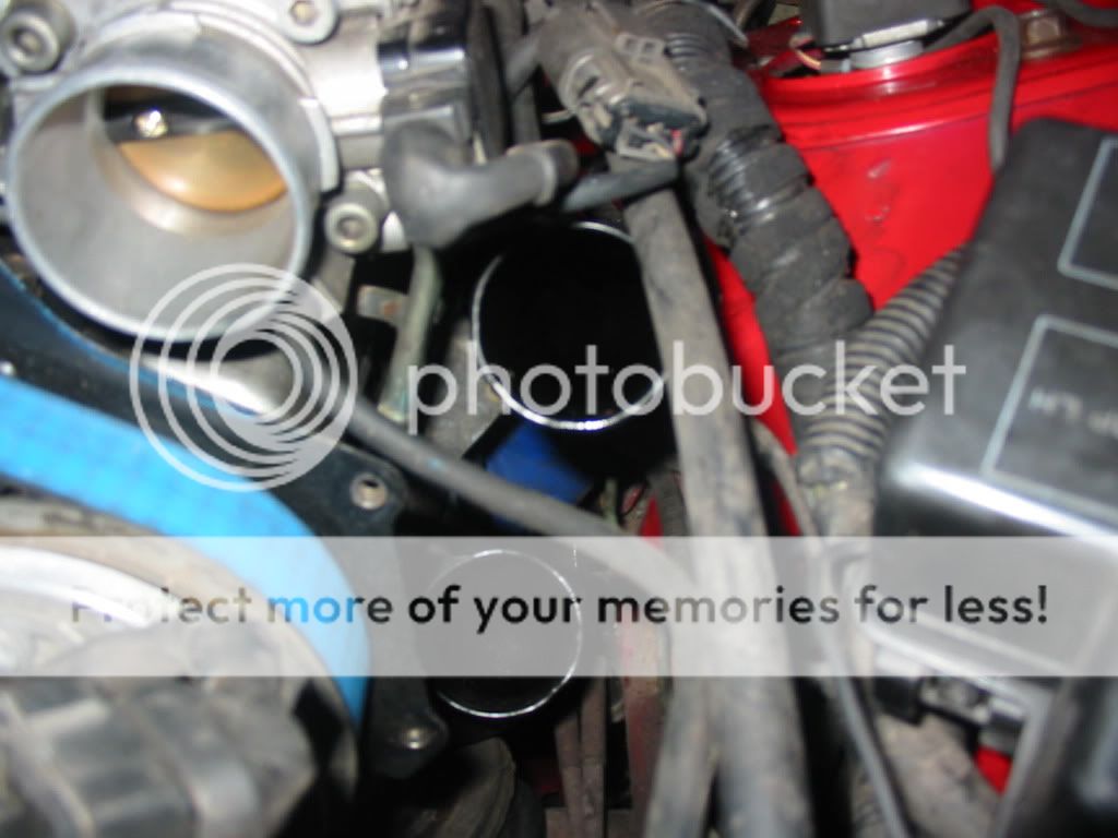

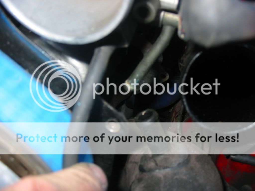

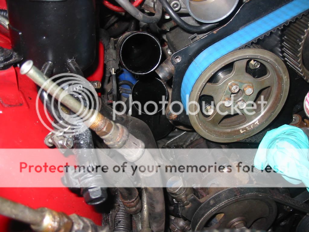

The left hand side intake appears to be connected up ok
Though it would appear that whilst in a rush to get the engine fitted, ***** 'forgot' to connect up the right hand side
Note the connection pipe is completely missing
***as a matter of interest, would the fact that this pipe is missing cause a 'boost leak'?

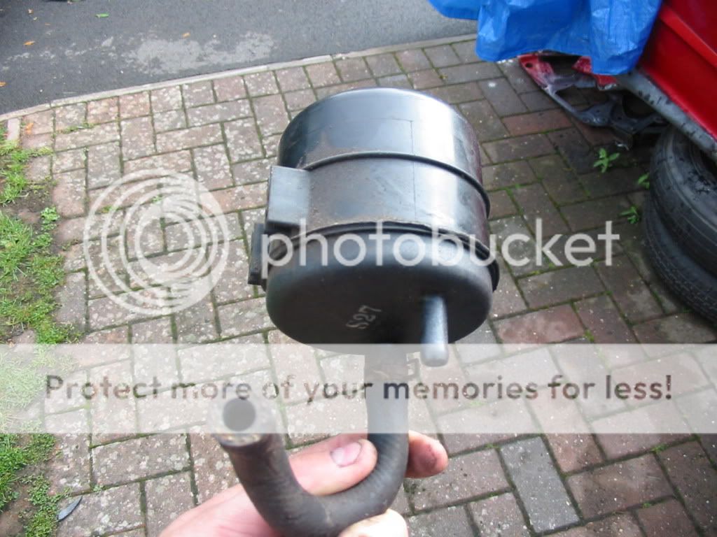

will you be binning the clutch vac tank (large squareish one) if so could i ask how much you would want for it

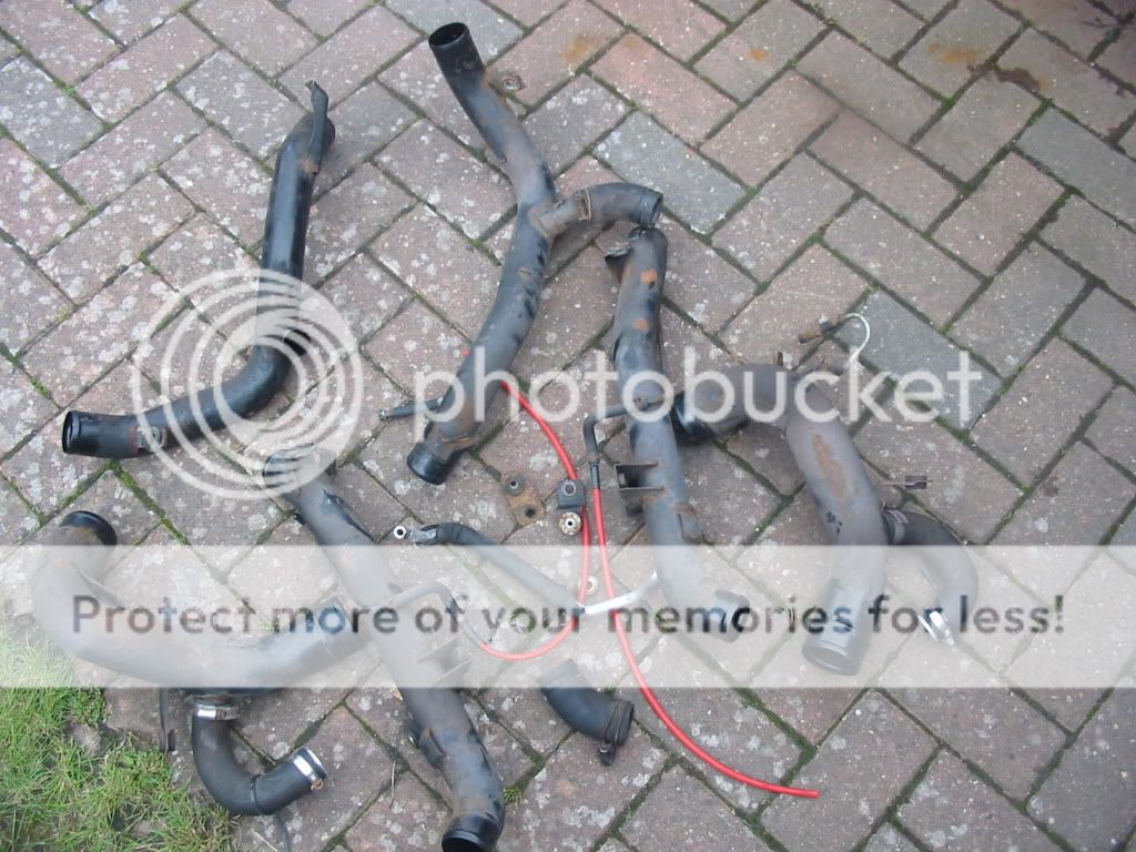

Yet another day of stripping out the clutter from the Z's engine bay
Having seen how clear my mate's PS13 engine bay is I've made it my mission to customise mine and make it equally as simple

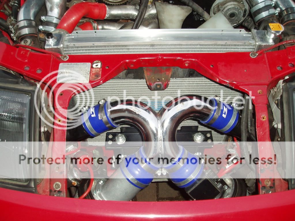

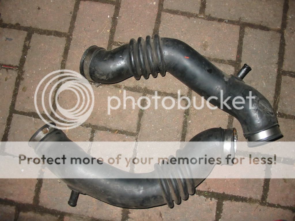

To that end all of the intake/intercooler pipes etc have now been binned ready for a local fabrication specialist to make up some custom pipework.
It came as no surprise to see how much pipework came out of the 'Z'

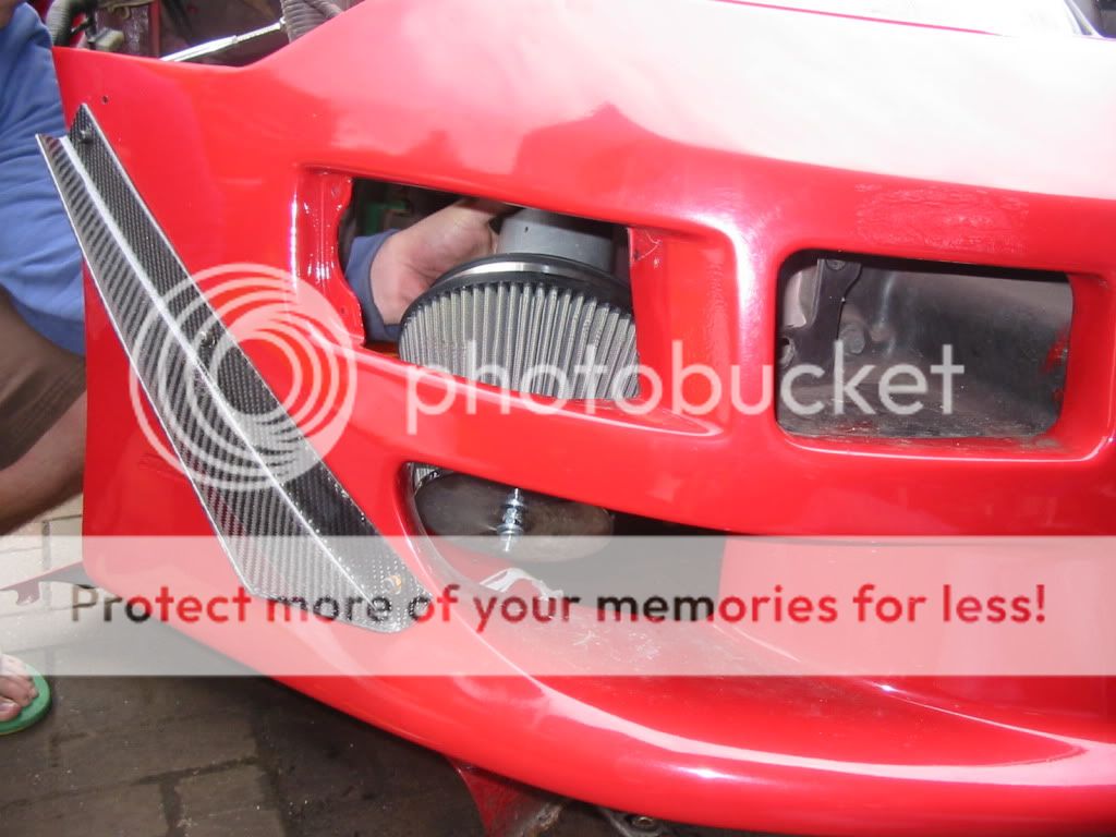

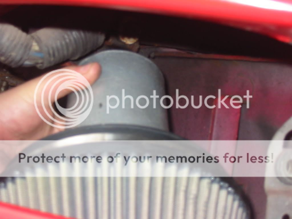

The original idea was to fit the right hand filter in the recess that has been created by removing the battery tray and then try to fit the left hand filter in the slightly smaller recess created by removing the EGR and AIV solenoid etc.
however it became clear that to fit the filters in these locations would require an acute bend in the pipework, not to mention the obvious heat issues associated with being located at the rear of the engine bay.
It was therefore descided to run a custom pipe from each turbo's intake, through the opening at the rear of the headlights and then fix both filters in place underneath the headlights (slightly forward of where the smics usually sit)
The rear section of the stock plastic/rubberised intake pipe will be completely removed as soon as the custom pipework has been made
this is where the two oil coolers were going to be located once the fmic was fitted.
It looks promising that this will still be achievable, with the use of some well placed brackets.
This will ensure that both filters and oil coolers will recieve maximum air flow from the side vents on the front bumper.
All of the stock intercooler pipework has now been removed so that the custom pipework for the fmic can be fitted, the custom pipework will take the most direct route to the turbo's and throttle chambers
Note: the small rear sections of pipe have temporarily been left in place attached to the turbo's, to help protect them from debris and water ingress, whilst work is ongoing in the engine bay.
