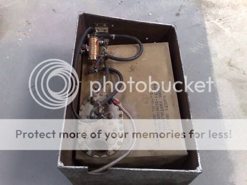

-Fuel system is currently being replaced with a 22 gallon US imported FUAL SAFE fuel cell with built in cut off & fire extinguisher system
-complete fuel system rebuild, twin 044 Bosch pumps utilising AEM EMS/fuel components, upgrading the NISMO 740's for larger injectors

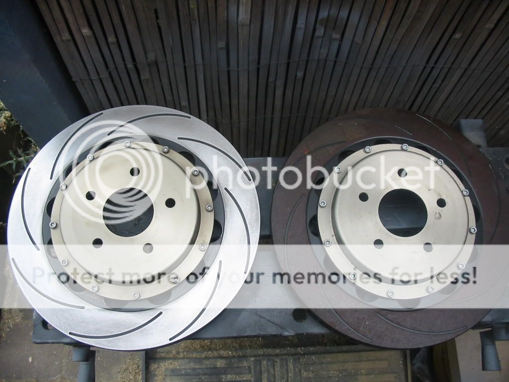

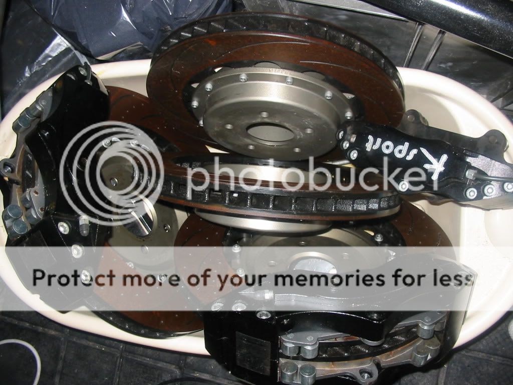

-full brake upgrade 12 pot (380mm) & 6 pot (356mm)

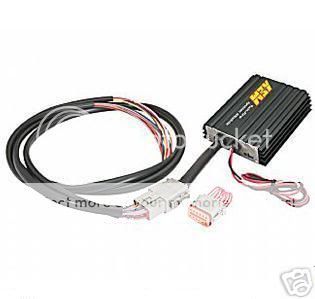

Some of the AEM parts that made it through the 'volcanic ash cloud' (hopefully more to follow over the next few days), TEIN and BLITZ parts = loads of wires = Japanese insruction manual = loads of smacking head off garage door in frustration!!!! can't wait.....

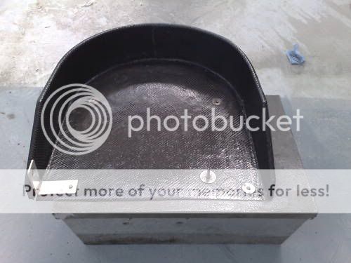

Carbon fibre overfender just tacked on to cut and prepare mould for custom carbon kit.
Quite lucky with the Volks offset, as they are a perfect fit for stock arches, the brakes (not fitted in the pic) push them out a bit but I need to play with the geometry and possibly add spacers on the rear.

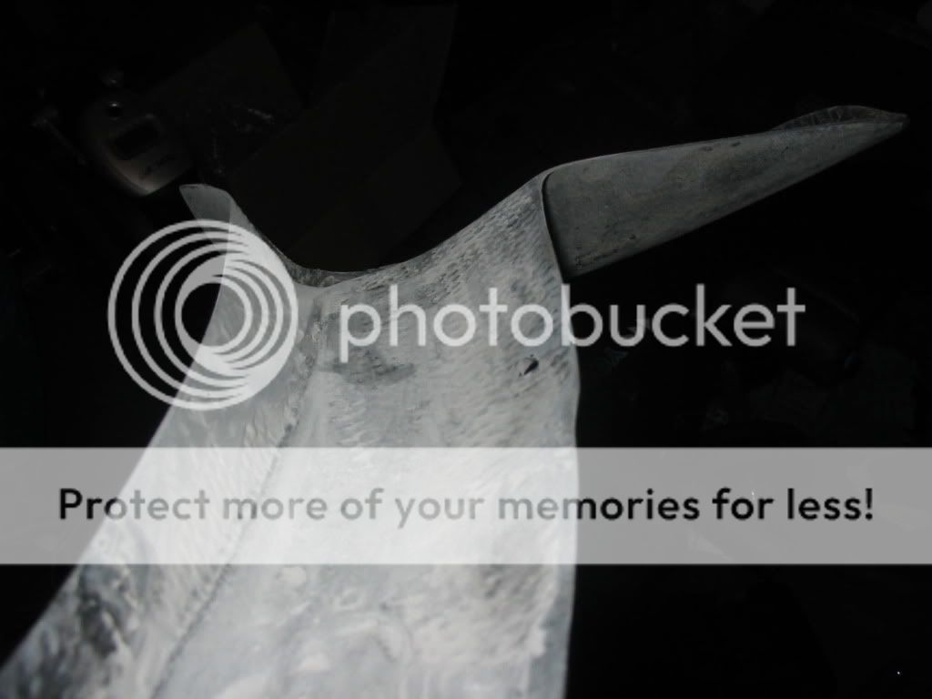

Carbon fibe rear diffuser (I should have all of the front and rear lower arms replaced with the DRIFTWORKS parts within the week)

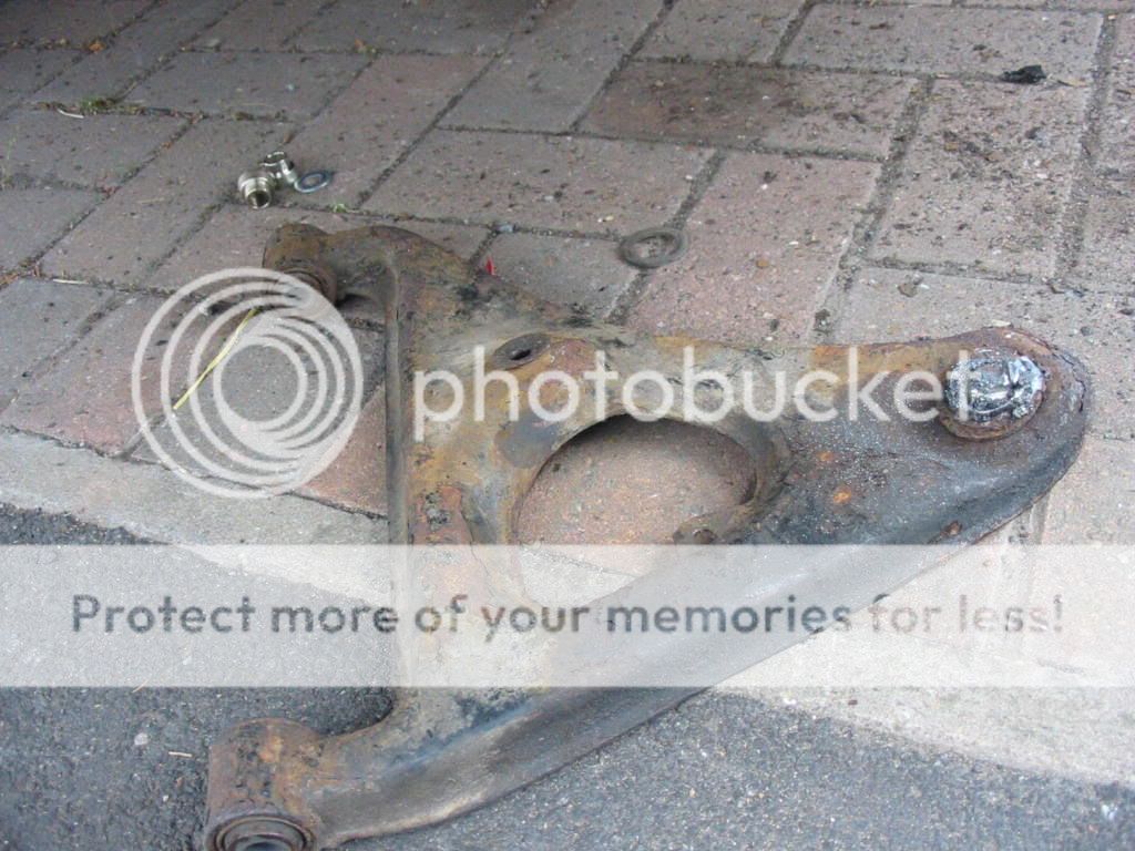

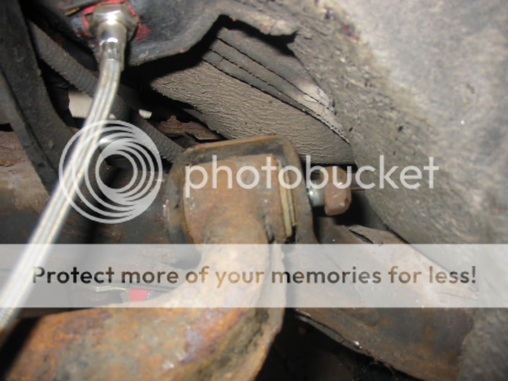

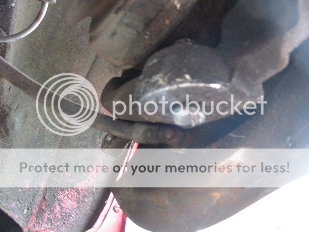

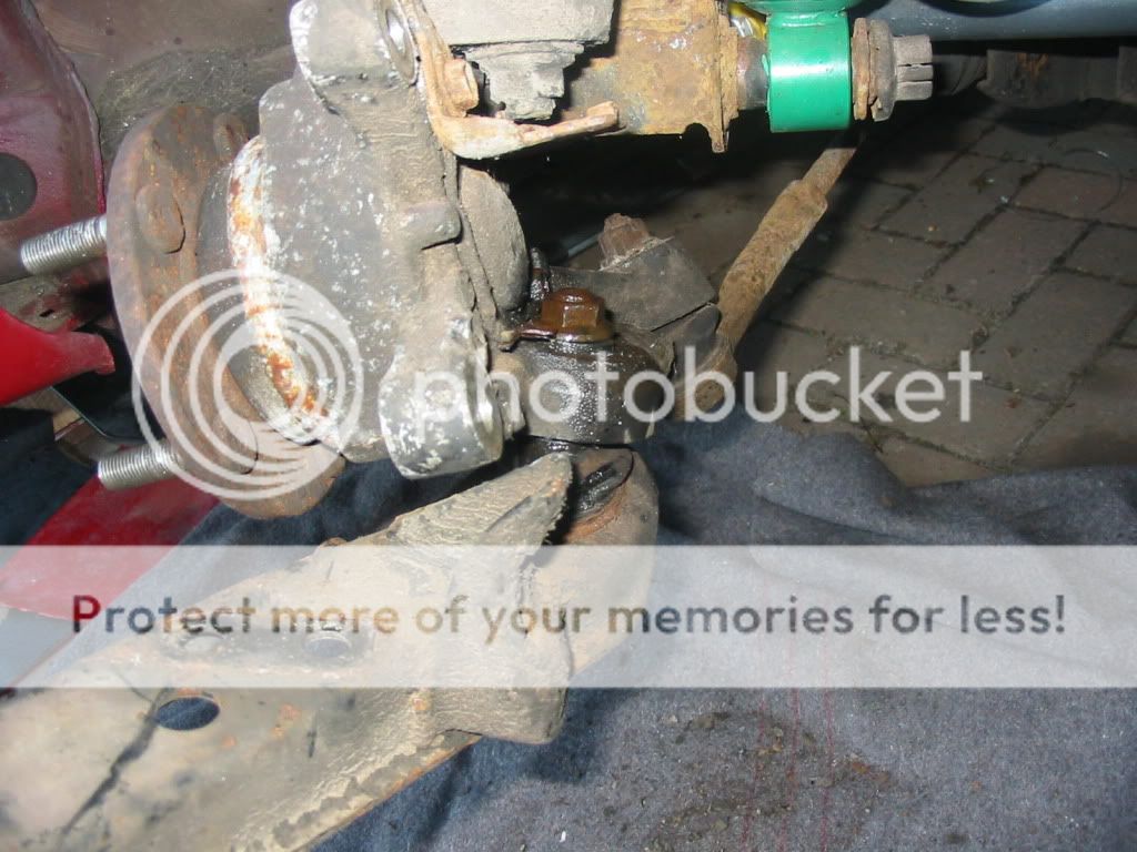

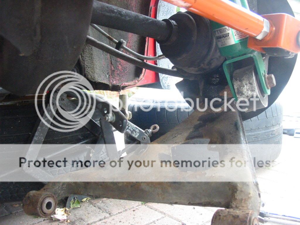

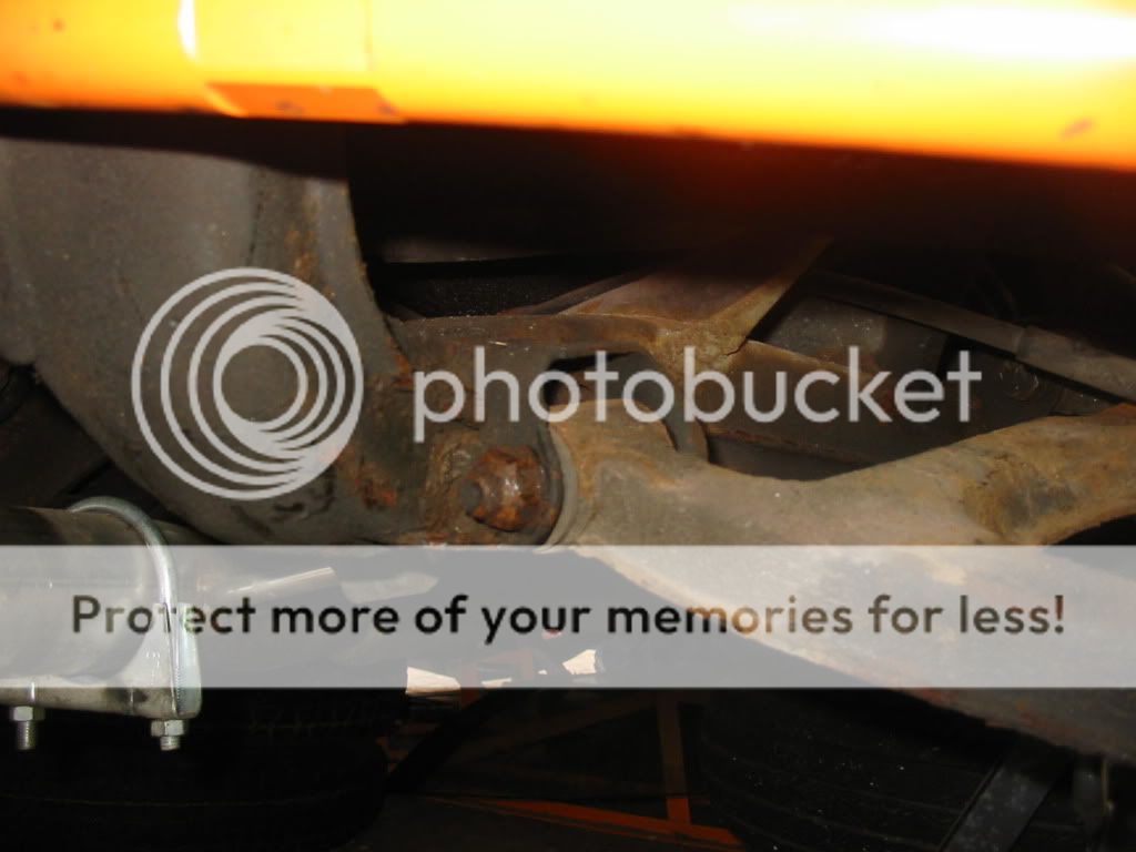

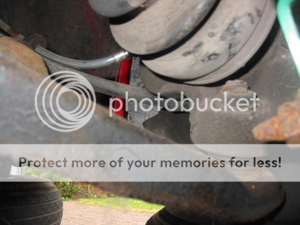

The bolts for the rear lower arms are proving to be a pain in the backside to remove as the cars up on stands.
The bolts aren't rusted, they're just very difficult to get any leverage on
The obvious solution I suppose would be to use air tools, however I can't get the car into work to get it up on the ramps
This one was relatively easy to undo, however......
these two are a nightmare
any suggestions? :hammer:

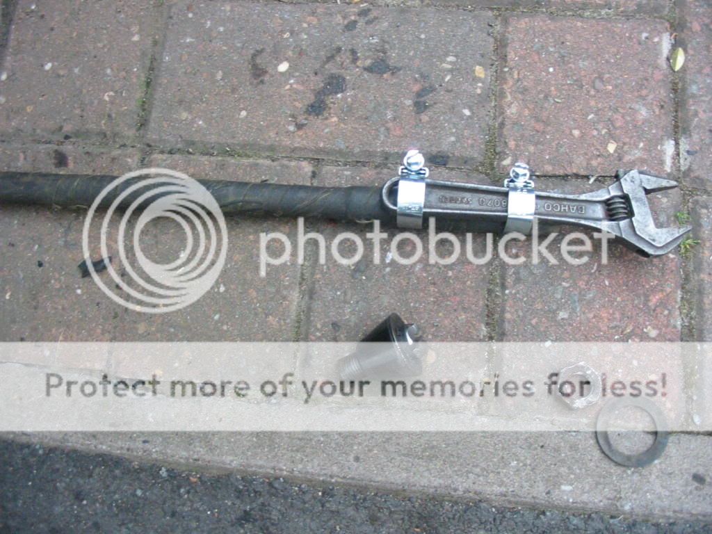

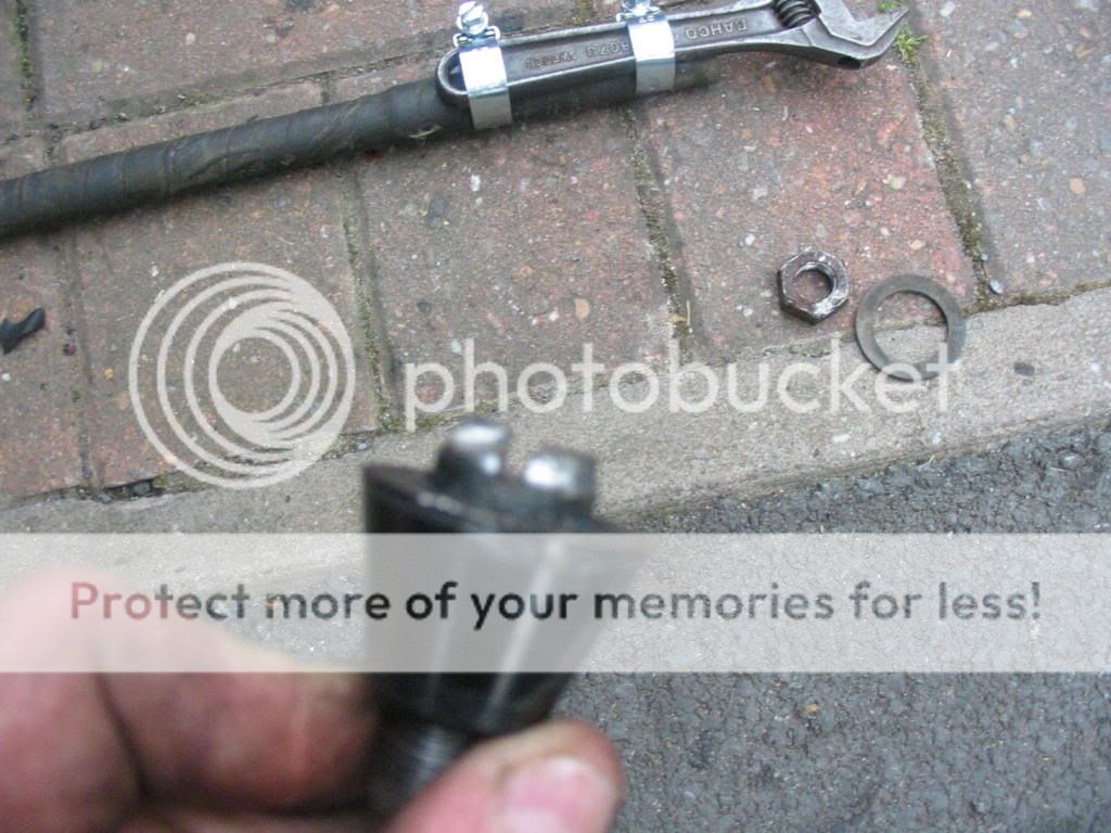

Managed to loosen and remove the outer bolts but the split pin in this one was causing major dramas
After trying every other method of removing the split pin I eventually had to angle grind it and the whole bolt off (very carefully!)
After cutting the bolt with the angle grinder I then set about removing what was left
After cutting the top of the bolt and split pin off I was left with just the top nut, it took a bit to free the rusted nut and as always the bolt turned with the nut!
So I ended up getting the grinder again and cutting a slit into the base of the bolt.
I then propped up a car jack with the lip at the top of the jack sitting inside the groove
Note the 'special' extendable adjustable spanner (a pikey setup....but it worked!)
The DRIFTWORKS lower arms can now be fitted, though I'll have to widen the bracket on the subframe very slightly to accomadate them
Getting there slowly
Will get started on the other side tomorrow and hopefully by tomorrow evening both rear lower arms will be fitted........joy!

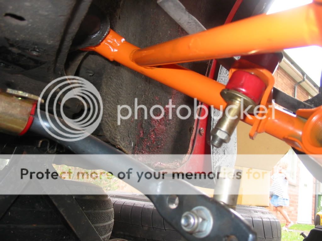

Quick update
After a lot of fookin' about I've eventually got the DW rear lower arm fitted on the drivers side

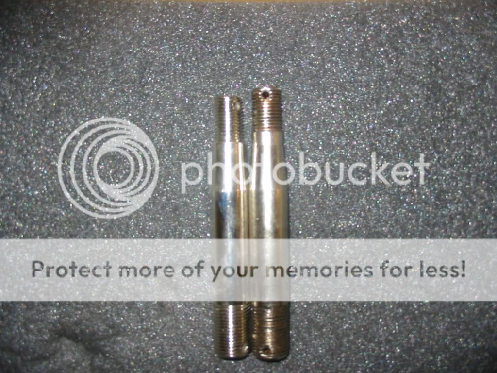

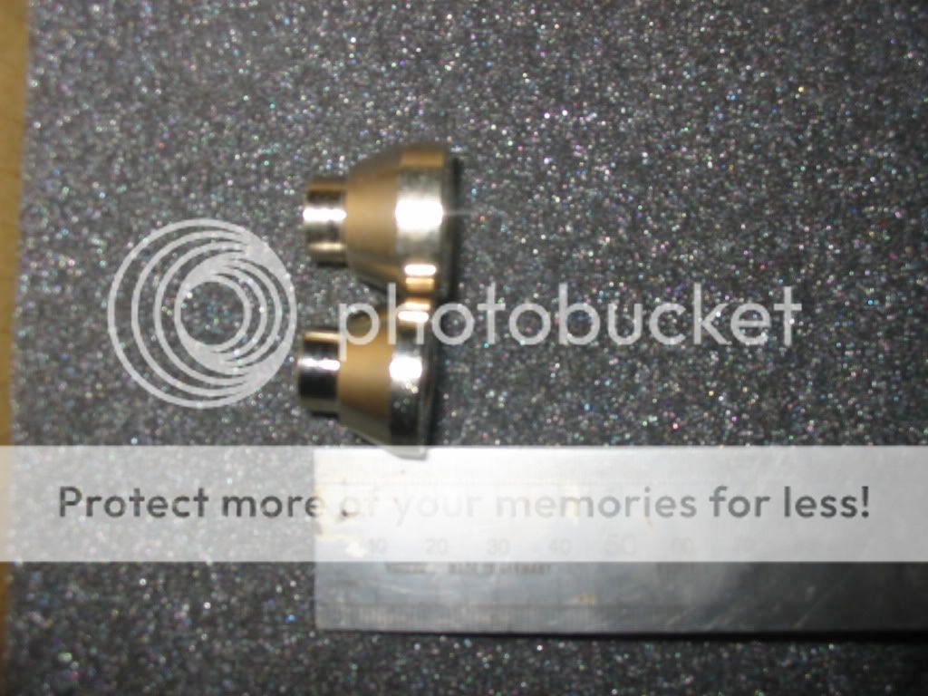

After much scratching of head as to why it wouldn't fit, I found the answer in a small plastic bag hidden away in the bottom of the box.
The bag was marked S13/A31, the joints and bolts were slightly shorter than those that I had been using
after swapping them both over the lower arm went on relatively easily
Re-fitted the CZP rear drop links
and it's all ready for the alignment shop to work their magic

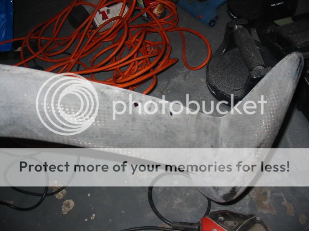

I've been working on the front passenger side carbon fibre over fender
Unlike the other three that are already fitted, this one requires a bit more work to get a nice flush fit
I'll be fitting this tomorrow

Next up was the rear lower arm on the passenger side
This started ok with the two main bolts undoing easily enough
However the last one (same as the opposite side) was a complete fooker'
The split pin had rusted solid to the bolt and wouldn't shift
Heat didn't work so I've had to drill out the centre of the bolt and used a saw to cut through the top

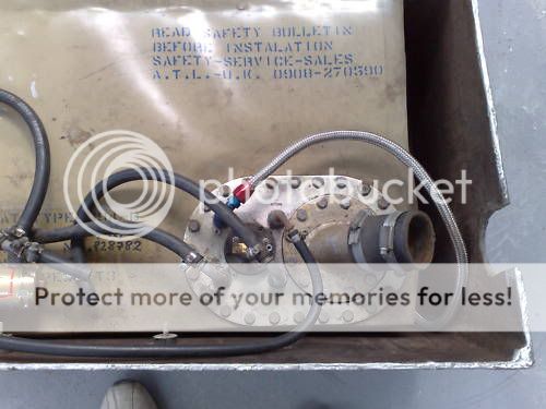

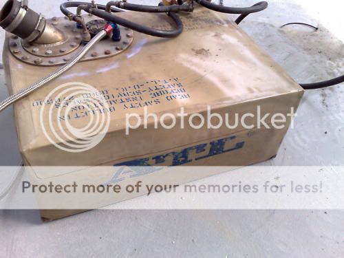

Whilst light levels were fading I had a go at the last bits of sound deadening in the boot
Once this is all removed I'll be able to give it a quick coat and fit the ATL fuel cell
This evening was spent just finishing off the last carbon fibre overfender, which is now ready to be fitted

Brake lines don't look like fully supported and may rub through.

Brakes are not motorsport type and will probably get knock off with big rotors and better to convert to floating hats.
The top front control arms will bind and come lose.
Cheers John

Reference the KSPORT brakes, they've been a topic of conversation with other members for the last couple of weeks and will need to be addressed in the near future

No chance unless you are removing the MAF. As soon as any moisture is detected you'll be limitited to 3k rpm and run like a dog.

Cheers for the heads up on the catch tank, I reckon I'm gonna have to sit down and figure out new mounting points for everything :thumbup1:
