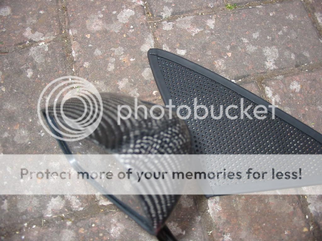

-the dash, heater etc were ripped out and replaced with a custom carbon fibre/military grade aluminium mesh half dash

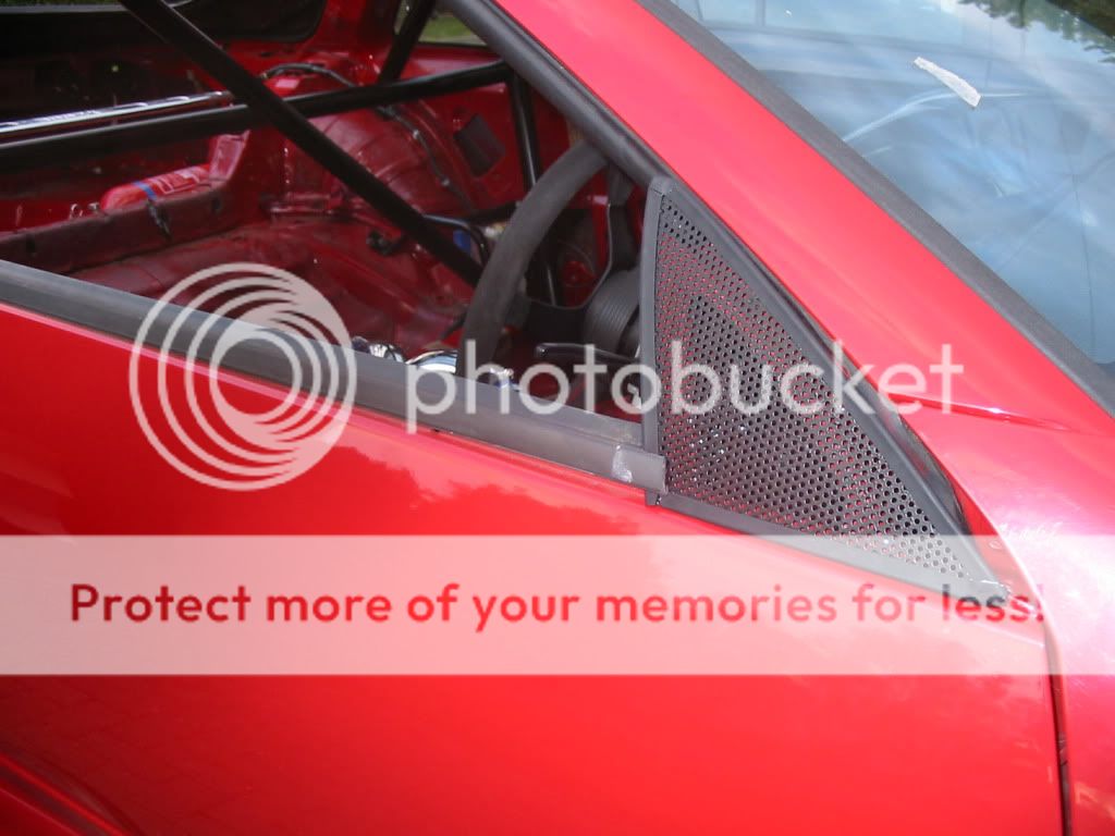

-cabon fibre blanks are being made to replace the rear quarter windows

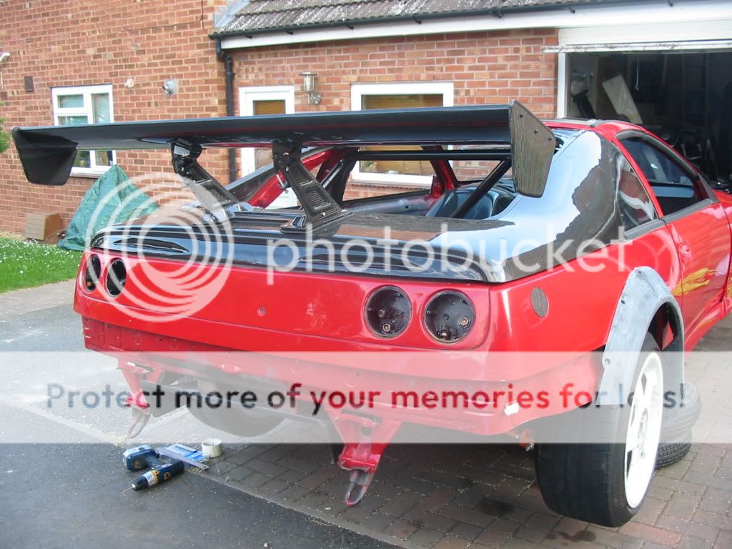

-70" carbon fibre GT wing is ready to replace the old 'small' 60" wing
-carbon fibre rear diffuser has been fitted

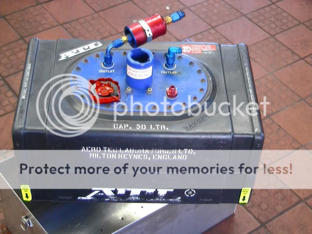

-Fuel system is currently being replaced with a 22 gallon US imported FUAL SAFE fuel cell with built in cut off & fire extinguisher system
-complete fuel system rebuild, twin 044 Bosch pumps utilising AEM EMS/fuel components, upgrading the NISMO 740's for larger injectors

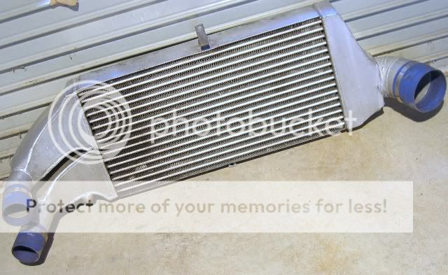

-cooling is provided by AEM water/methanol injection, upgraded PACE side mounted intercoolers, Koyo rad, HEL oil cooler, carbon vented nose panel, carbon vented bonnet, carbon venturi ducts

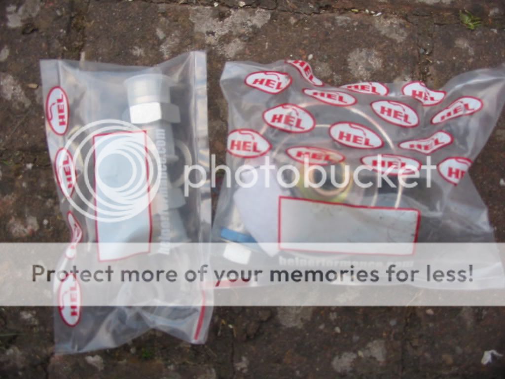

Twin JWT pop chargers and Z1 Doolz kit, HEL 19 row oil cooler, twin Bailey BOV's (some tatty looking SAMCO hose in there at the mo that'll need replacing shortly)

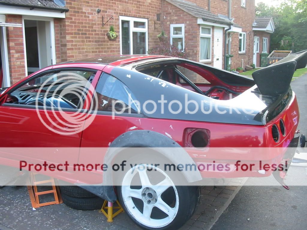

Z32 balancing on 2 x space saver wheels....not really.... obviously just extra safety measure if 4 tonne axle stands don't surfice.

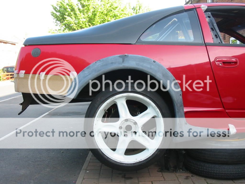

Carbon fibre overfender just tacked on to cut and prepare mould for custom carbon kit.
Quite lucky with the Volks offset, as they are a perfect fit for stock arches, the brakes (not fitted in the pic) push them out a bit but I need to play with the geometry and possibly add spacers on the rear.

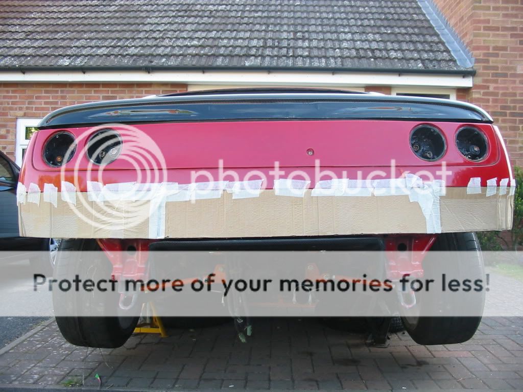

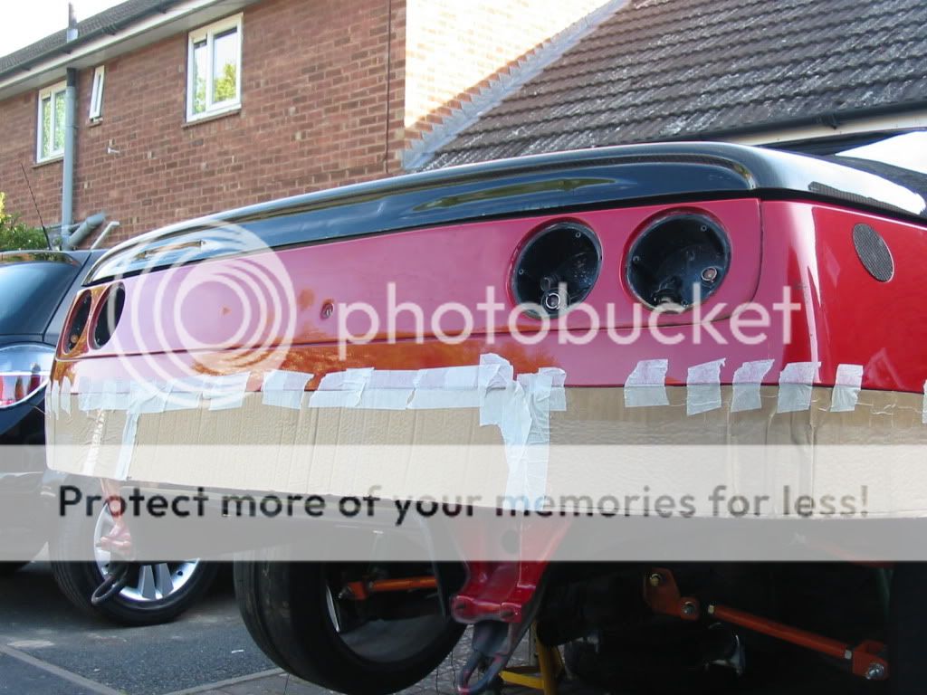

Carbon fibe rear diffuser (I should have all of the front and rear lower arms replaced with the DRIFTWORKS parts within the week)
http://i1034.photobucket.com/albums/a430/azineakinadan79/037.jpg

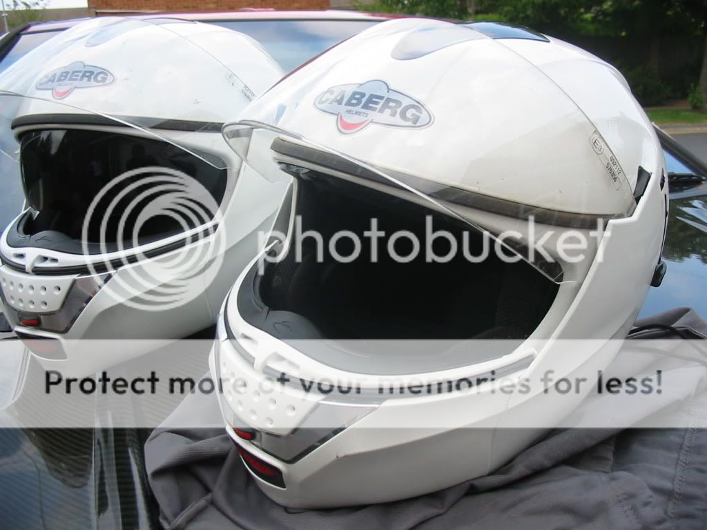

Perks of the job!
These were kindly 'donated' the other day by a mate of mine who I work with, he didn't have a use for them so I got a result and bagged myself a pair of helmets for track days :hyper::hyper::hyper:

any more of those helmets going :) :)

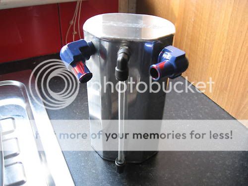

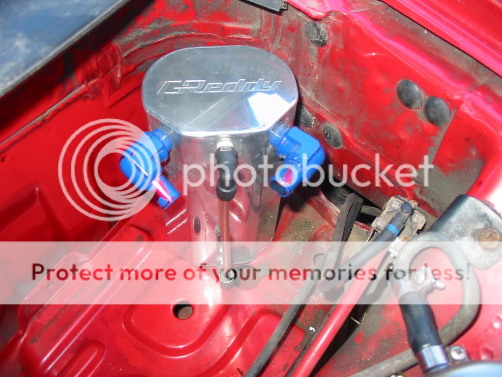

for the oil cooler, do not run it via the catch tank. Any oil in the catch tank needs to be disposed of as it will be contaminated by steam etc.
Ref the helmets, I can ask him in the morning, but very doubtful mate.
I would offer one up if it was spare but as my boy, my two girls and my wife will be joining me on track days, I'm going to need it for them.
I've got this one spare, if it's any use to you :lol::lol::lol:
Cheers for the heads up on the catch tank, I reckon I'm gonna have to sit down and figure out new mounting points for everything :thumbup1:

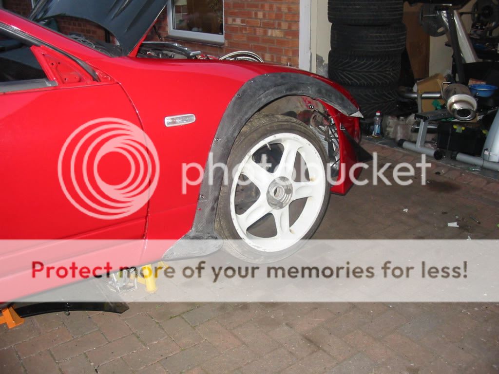

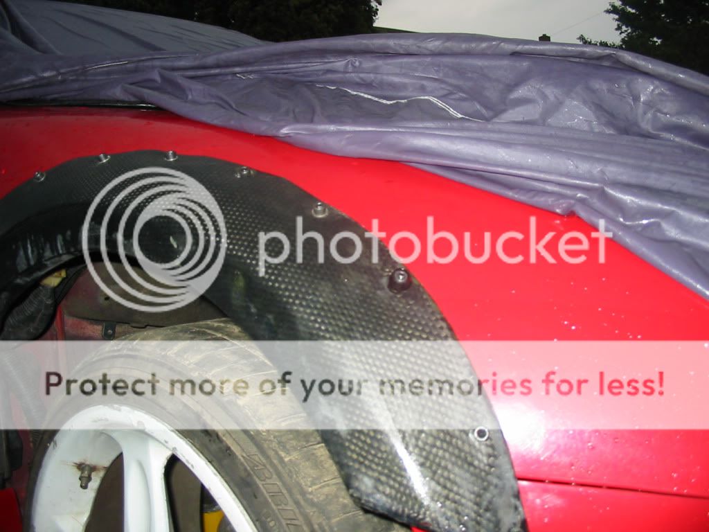

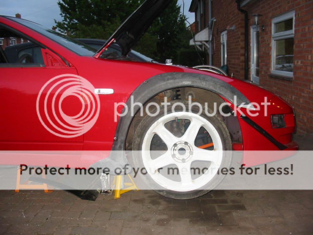

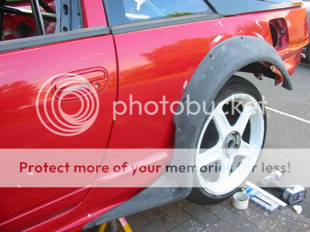

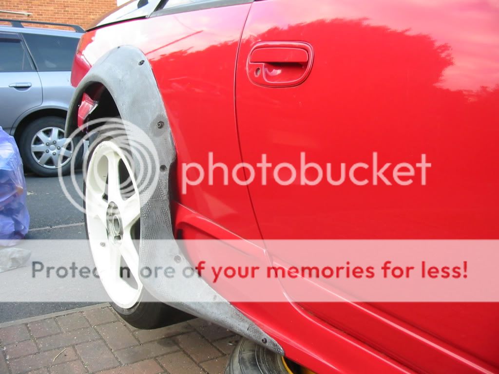

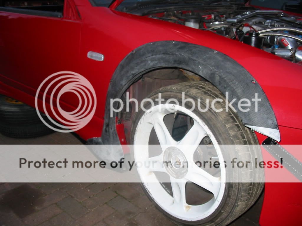

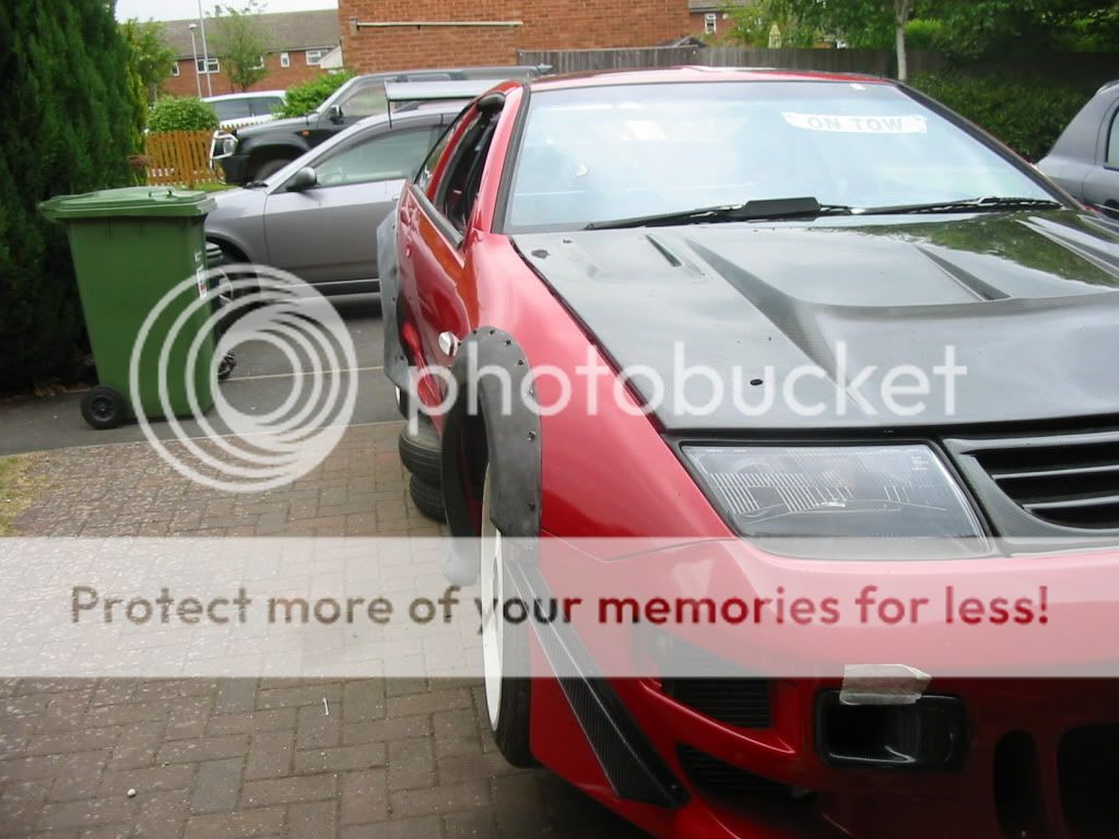

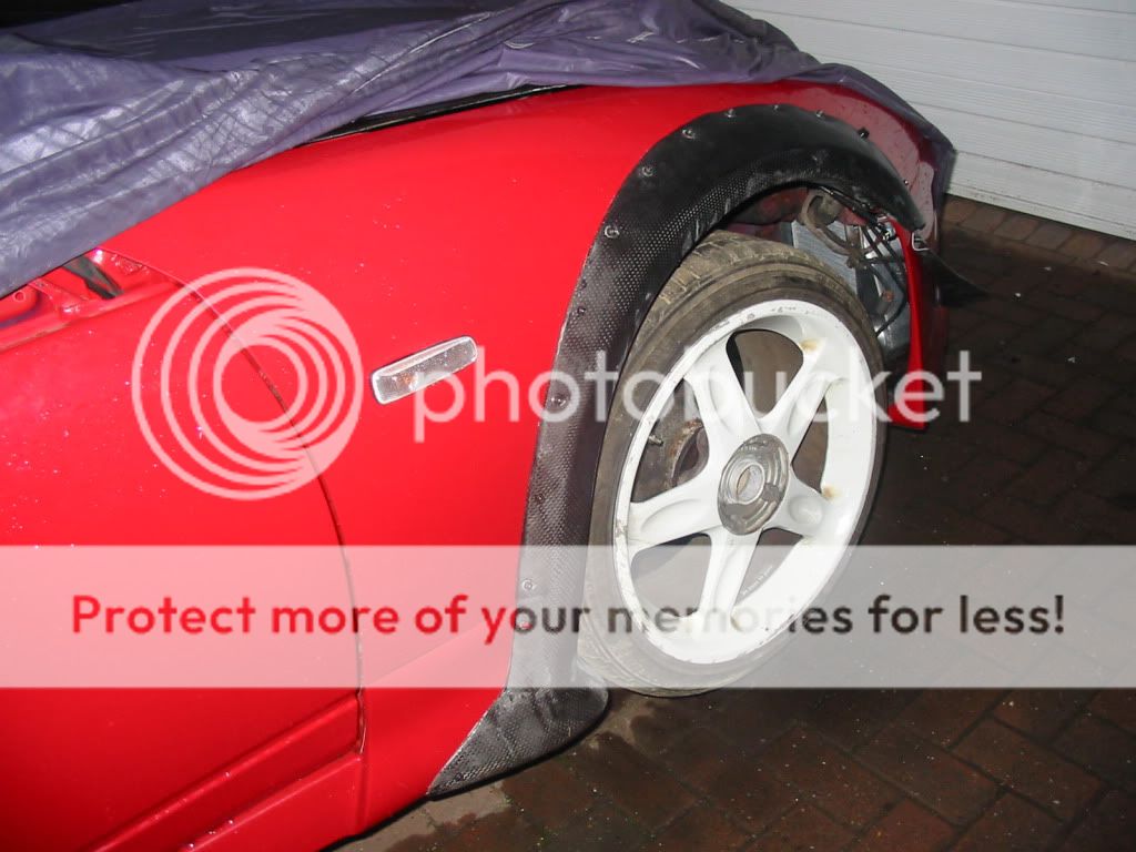

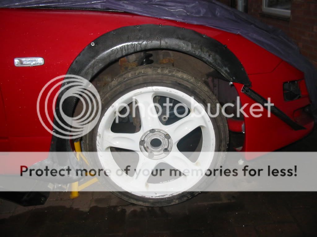

I was test fitting the front carbon fibre overfenders before the battery on my drill died.........bugger!!!
Oh well here are a few pics anyway.........
Obviously they are nowhere near complete as I still need to finish the test fit, remove them and cut/shape/refit etc. before the coat of clear laquer on both the front and rear
The extra width should enable a very slightly wider track at the front end.
Not perfect yet, but they are designed for a Supra to be fair, so don't be too critical just yet :wink:
where the hell did you find carbon overfenders for ANY car lol?
I was chatting to a bloke on the Supra forum about something completely different and he made a random comment about carbon fibre parts and how costly they were.
He was gutted as he'd just shelled out a couple of grand getting his mk IV Supra sorted only to write it off a few weeks later in the wet.
He'd sourced these carbon overfenders; that were now no use to him, and was looking to trawl back some cash so that he could start afresh.
I'd seen them before but only in FRP.
I got wind that envy performance were selling them on their website for £900 and thought that I'd give them a crack on my Z32.
I offered him a rediculously low 'instant bank payment' and his mrs replied to the e-mail accepting the offer.
They arrived a few days later and I got to work sizing them up.
I've seen the FRP type blended in on Z32's before and they looked pretty decent to be fair (better in my lowly opinion than some of the gash FRP wide body kits currently available for the Z32....no offence intended as I know that overfenders are not to everyones taste)
so to get a full set in carbon fibre was a result; and as they serve a purpose (and I like the purposeful 'bolt on' look), they won't be blended in, simply hex bolted on enabling a wider stance all round

I agree mate, the bolt on look isn't to everybody's taste but the way I'm looking at it is....it's a track car (road legal yes but primarily built for track)....if I have a big off on track or get a bit too close to the opposition and damage something whilst getting sideways, it doesn't really matter because I can just beat it out, unbolt the damaged part and replace it with another one (I'll just have to knock up a mould beforehand and carry a few spares in the truck)
To be fair the majority of self funded drift cars are usually held together with plasti' ties by the end of the season.
Not to mention the fact that the final aggressive 'don't f**k with me' look of raw carbon on track animal, places a severe eliment of doubt in the minds of the country's wealthy flash ba***rd drivers :wink:

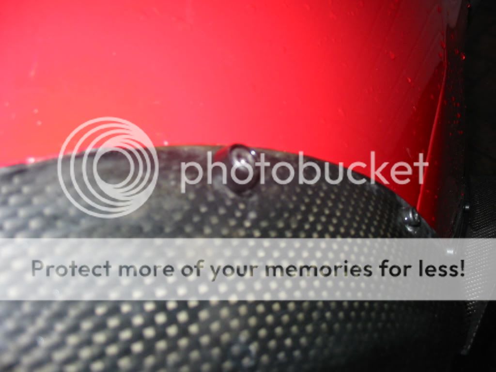

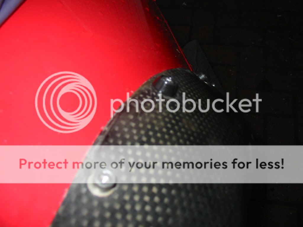

These aren't completed yet but at least I've finally managed to get round to finishing the initial test fit of the drivers side front carbon fibre overfender and its a pretty good fit.
I've always planned to use hex bolts to secure the overfenders in place, but think that standard washers are a bit shite looking, therefore I went on a rummage, looking for suitable alternatives.
I now plan to use the heads (?) from the hex bolts that hold the cam covers in place
I've primered and black laquered one as a tester and think that it's both practical and also adds to the purposeful look of the overfenders
The hex bolt sits nicely inside the 'head'
The only drawback to this is that I need to source '16' heads for each front fender and probably the same for the rear

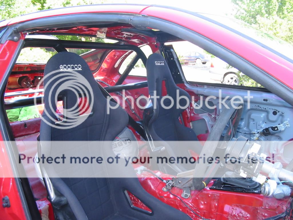

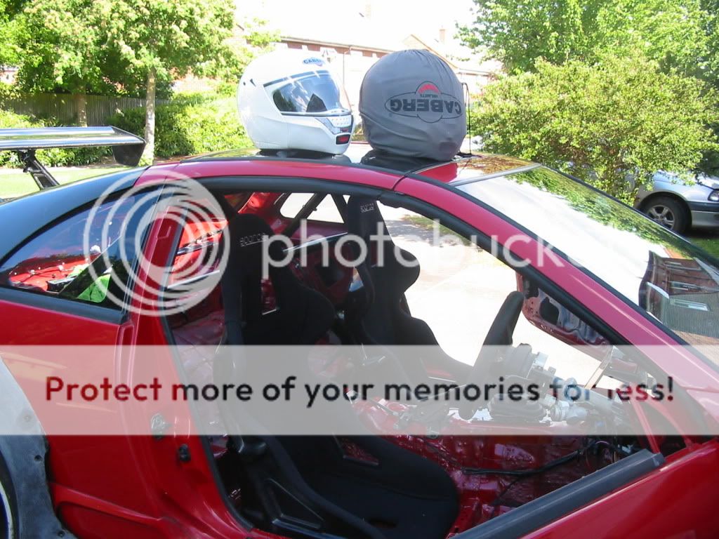

I got back from work this afternoon and found a nice big box waiting for me
Out with the carbon fibre buckets and in with a set of SPARCO's
I just need to pick up an extra set of side rails now, so that I can bolt them in place

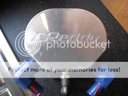

The GREDDY oil catch can arrived yesterday so I'm just looking at options for mounting points.
As the red top race battery is going behind the passenger seat, the now empty space would appear to be an ideal place to secure the can.
As shown previously by Mark's (silverbullet) setup

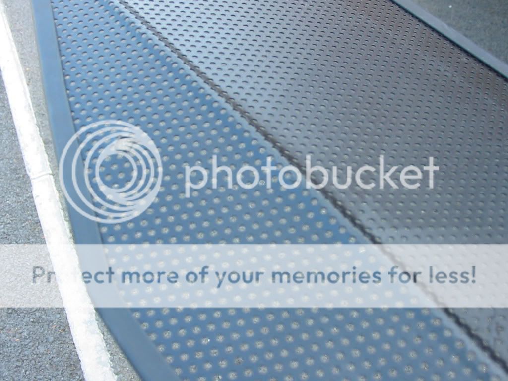

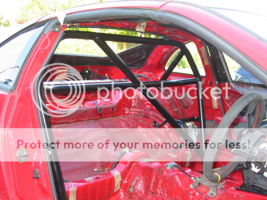

Everything that's not required mate (especially sound deadening!!!) is coming out shortly or has already been removed, I'm just having to work on it whenever I get the chance and just keep chipping away.
If I want to stand a chance of getting the car ready by the end of this summer I need to really pull my finger out :thumbup:
Agreed with the sound deadening, I removed all of mine a couple of months back. Once removed the car is about another 40kg lighter! Only thing is you'll have to apply a lick of paint as yours is exposed, its unpainted under the deadening. (obviously) :thumbup:
iam sorry but i weighted that tar and it is 5 kg drivers side and 5 kg pass side .. and about 4 kg under back seats and boot ..so 40 kg hardly ..
Yep, you can't argue with a 40kg weight loss by simply removing some pointless excess
(Labour have just lost 90kg if that's the case, hey Gordie'.....well, probably closer to 110kg I reckon)
As it'll need touching up inside anyway; once the sound deadening is removed, I'm considering going for a full matt black interior, just to be a bit different
Edited by jap.slapper
I've binned it now... but I had a big bag full of it that was 28kg, that was without removing from the transmission tunnel or anything further forward from the front seats. So a guess that may be slightly out, but that makes your 14kg sound wrong too. :tt2:
How much sound deadening do you need in one f***ing car Mr Nissan?
I'm only half way through stripping the stuff out and still have the rear wheel arches and boot floor to do yet.
The cardboard box of sound deadening that I've already stripped out weighs a fair few kilo's
Once it's all removed, I'll weigh it and see how much excess weight the 'Z' was carrying

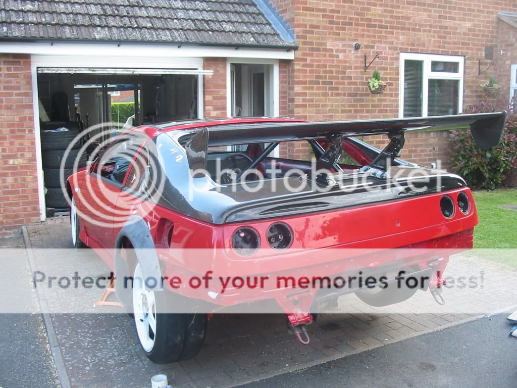

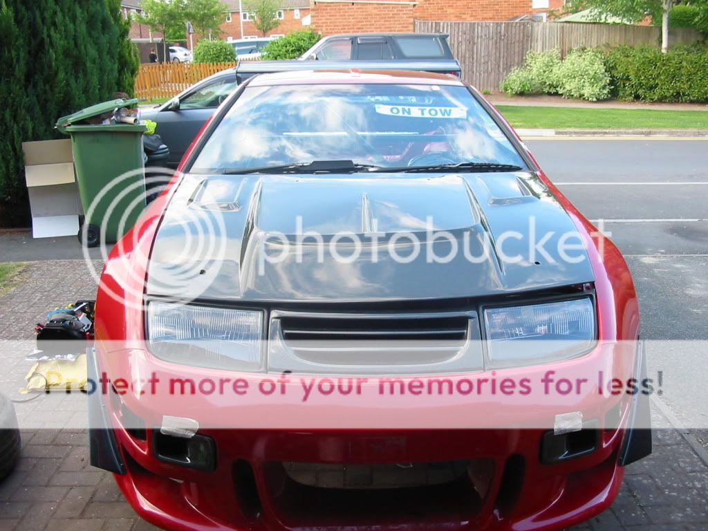

Just going to run an idea past you guys.
I've had a delay with the company that are supplying the polycarb windows for the car; nothing that could be avoided simply a personal family matter on their part, that has halted business for a while.
anyway, I want to get the car water tight as soon as possible, before I start to install all of the electronic bits and pieces into the dash.
I remember seeing a track NSX that was built in Japan a few years back, that offered the driver minimal rear view through the small polycarb rear screen.
Instead the driver relied on a small rear mounted camera with a video feed running into a small LED display mounted on the dash.
I'm considering fabricating a carbon fibre screen (mould taken from the original rear Z32 windscreen) fitted with a custom camera housing which would house one of the 4 high resolution RACE TECHNOLOGY VIDEO 4 cameras.
The VIDEO 4 system allows (4) seperate camera feeds (+ audio) to be recorded on the systems removable flash card for after action analysis.
However the system also offers the added bonus of a seperate VIDEO OUT port.
What I am looking at as a possible option is, as previously mentioned, mounting one of the cameras into a custom carbon fibre rear screen and then will run the additional rear camera feed (via the external VIDEO OUT port) into a seperate 12v DC DVR mounted on the dash in clear view of the driver, this will then effectively become the rear view mirror, with the added bonus of recording the video feed (in addition to the VIDEO 4 recording) onto a seperate removable flash card (if required), the DVR records in FMV (25 fps) MPEG format wth the ability to extract JPEG stills direct off either the removable flash card or via USB (a seperate remote audio option also enables recording of the on board 2 way comms system from the pits to the driver etc)
DVR
The whole system runs via a RACE TECHNOLOGY DL1 (datalogger) to the AEM EMS (which also incorporates a datalogger function) so that all vehicle data; in addition to video and audio data, can be recorded (internally and on external flash card); again for after action analysis, with the added bonus of a back up recording of every piece of vehicle/video and audio data.
RACE TECHNOLOGY DL1
I am looking to upload the AEM EMS software onto a small OQO computer which will be running off 12v DC, enabling continuous access and control over the vehicle diagnostics.
OQO COMPUTER
Rear carbon fibre hatch
I've already confirmed that as long as the rear view is adequate, the car will still remain road legal.
The additinal weight saving over polycarb glass is an added bonus.
What are your views fellas? (bearing in mind that this build is primarily for track purpose)
