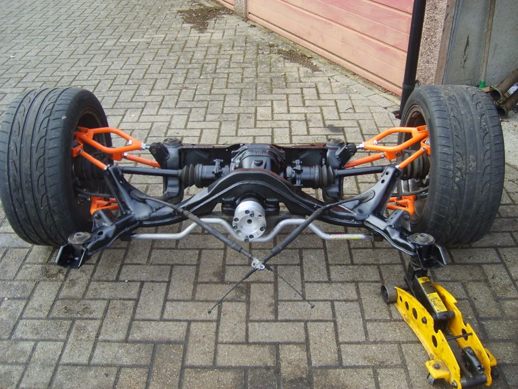

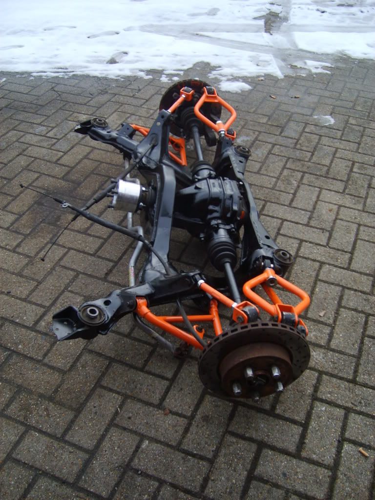

get yourself a driftworks rear end, solid as hell...
oooh i like that, is it just 4 bolts holding the rear sub frame to the chassis?
That would be so easy to work on if you just drop it off the car first, could change everything in one go then and have loads of room, the more i find out about how easy it is to remove parts from this car, the move i love it :thumbup1:
thats exactly it, four bolts and the frame drops ;)
i can feel a lock out bar and my socket set getting plenty of use come summer, think im going to have a bush upgrade time as well me thinks, as well as some hammerite parties...:shuriken:
