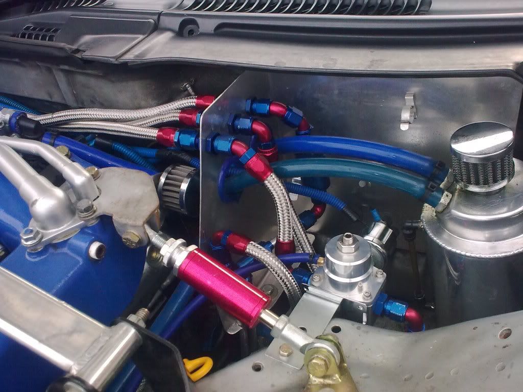

I was hoping you would pop up mark, if its not too much hassle can you draw up a diagram for me as to how you plumbed it in.
one other thing, i see you have a small filter vented to atmosphere, doesnt this release crank pressure? Is this correct? i thought you had to retain some pressure or am i way off?
So i should purchase a tank with a vent then?
i take it you mean the filter on top of the tank and not the cold start filter?

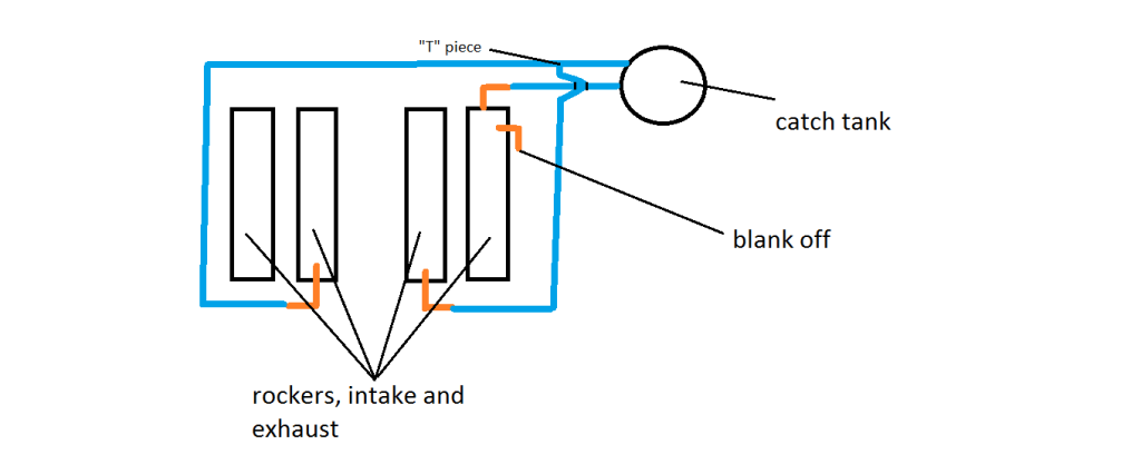

the plumbing is quite straight forward...
blank one of the two breathers off that are on the passanger exhaust rocker, feed the open breather straight to the tank.
at the front of the engine on the intake rocker breathers, connect and route hose to the back of the engine, linking them together with a "T" peice, this then goes straight to the tank. either block off or replace the PCV's with grub screws and you're done.
this will not affect oil pressure and you will find that the engine will run a hell of alot smoother due to only having clean air pushing through the intake.

You dont fancy making up a paintshop diagram of how you set yours up do tou mark :D please?
Should this help reduce the risk of blowing out seals?
i'll go get my easle out now :D
the reason for me fitting the catch tank was that my rear seal kept leaking, since the tank has been fitted, no leaks from seal.
Thats perfect thanks Mark :D So i blank off both pcv obviosly. why are all the breather pipes T'd into both pipes, is that right?
