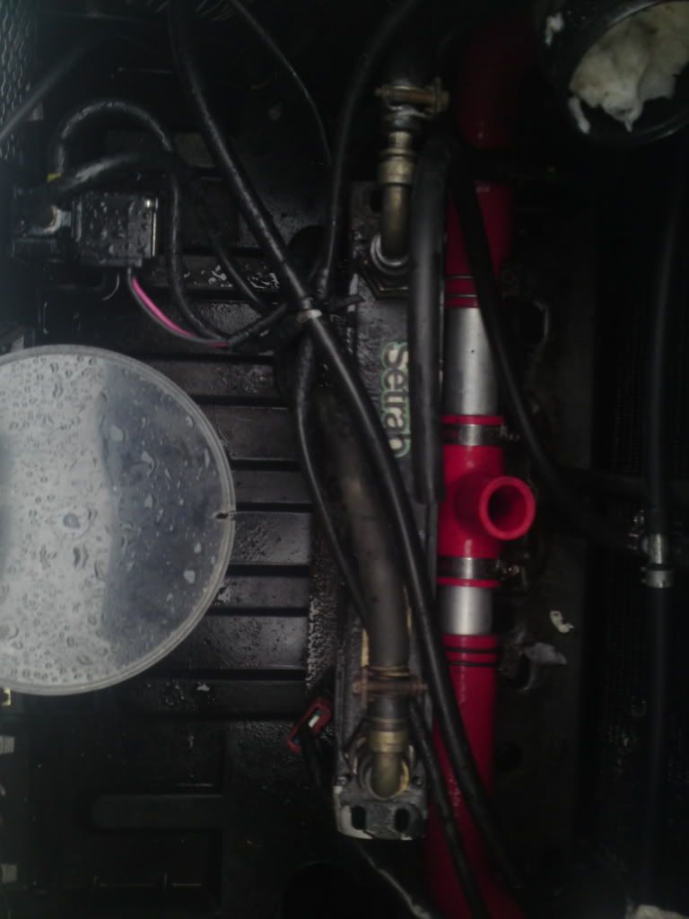

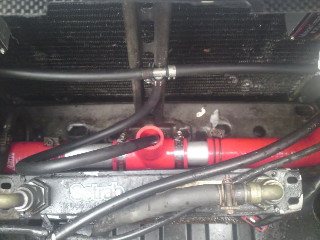

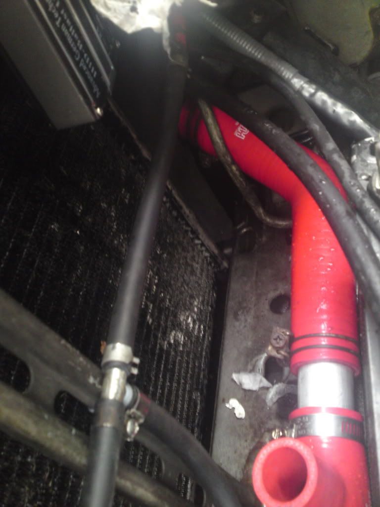

I just bought some chair rubber bung ends and they fit nicely with a little stretch...... cost £2 from homebase.
Anyway here is what i have done so far, Just waiting for the Valve now.......
