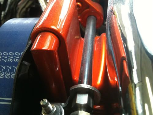

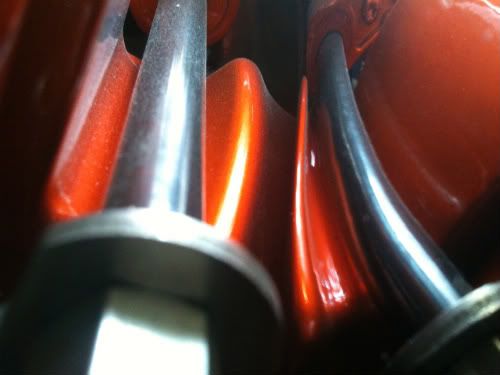

Had a look at mine today. You may have already checked this out, then please tell me to shut up :tongue_smilie: Might be worth checking the clearance between the control bar and the cam rocker covers. Mine looked like there wasn't much clearance betwwen the two. Don't want you to get around to fitting and find they rub with the chrome pipe over them. Fingers cross they are fine.
I checked the tolerances before I did this so should be ok, but I will double check it on the car again and drop you a confirmation photo ;-)
That's fine Andy. Didn't want you to fit it and have problems. It's going look very nice when fitted. Should of guessed that you had checked this before hand with all the work and planning gone into it ;)
Well just in case I screwed up Ant - hang on with yours until I get back to you ;-)
Hopefully get this back together (actually on the car!) next week....
It's all very tight...
