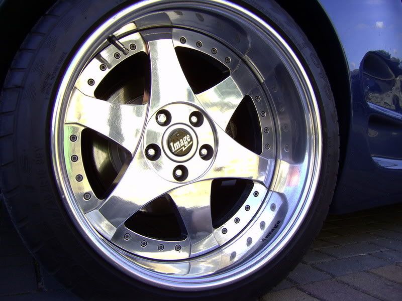

Wider wheels with a lower offset is the preferred option.
Spacers are a cheaper but less favourable way of doing it.
Offset rear wheels, no spacers required

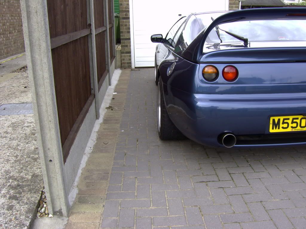

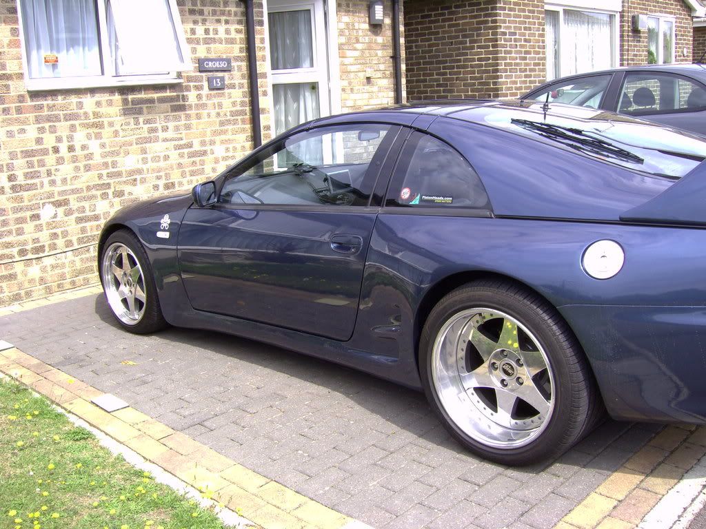

the beast has -1 offset rear wheels with no spacers and they fit the wide arch kit perfectly. the correct offset can fit a wide arch kit easily. some wheels have offsets such as -30 which would stick out too far even for a wide arch kit so its deffinately not hard to fill the arches without spacers.

you can get wheels to fit without spacers but you are looking at well over 2k, buy craigs wheels and spacers to have a gaurenteed fit, i know it will fit cause it used to be my car

That wheel/spacer combo you had did not fill the arches properly, was one of the things letting the look down unfortunately. Spacers would be fine with different wheels and vice versa.

Offset is -31mm on the rear, this size will be order only and is avalible in very few manufactures so will be £££££ around 4k ish for a full set last time I looked
i thought that, but when you look if it had camber arms fitted and brought them out a bit it would have looked better, the correct wheels are better though
Putting the 60mm spacers on with adjustable camber arms will fill the arches much better, and will look right.
