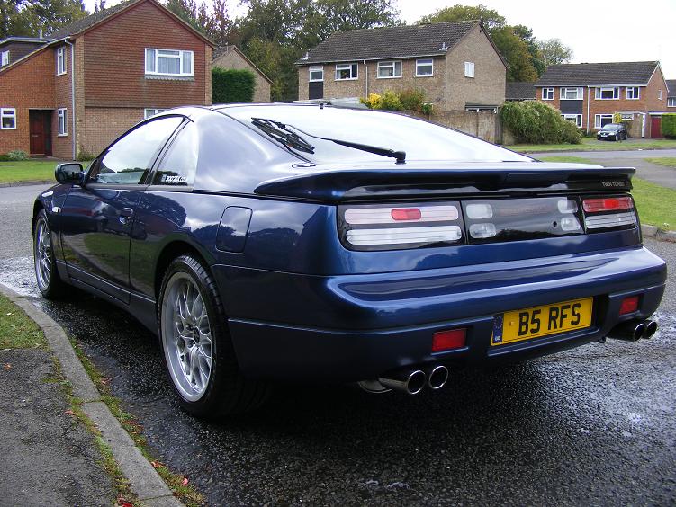

hi everyone, the standard rear spoiler on my car has been removed and replaced with a carbon fibre fin (not to my taste) looks like it belongs on a f1 car, whoever did this has also removed the perspex strip aswell, now i thought it wud just be a case of putting the standard spoiler back on aswell as the perspex strip, but iv seen quite a few spoilers that seem to cover over were the perspex strip wud be, and also a few were the car has both on, can anyone help me by telling me if i need both or just the spoiler please? the cars a 93 tt fairlady import, iv only had her a week and as yet dont really now much about them except ther bloody quick! thanks very much.
if you want the oem spoiler for your model you wont need a perspex strip... only the later models require perspex strips. though of course there is nothing stopping you from fitting a late spec spoiler. the are quite a few options available for spoilers (3 types of oem and many aftermarket) so get googling to find what suits your taste best :D
With the stock (pre 1995) spoiler there is no perspex strip; the spoiler covers the whole area like my car below. I have the fibre glass replica one (see Z Centre) as the foam one gets waterlogged over time.
