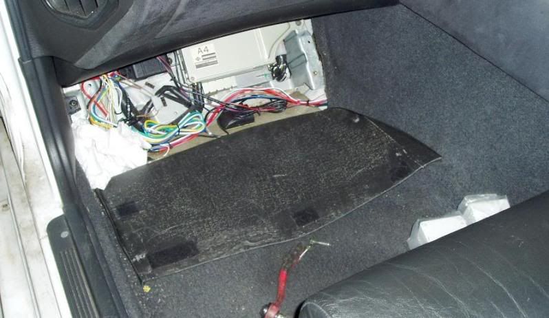

So when we saw a zed with some odd electrical issues and a very wet passenger carpet the taga was an obvious suspect.
But when pulling the carpet back the area below the ecu was very dry.

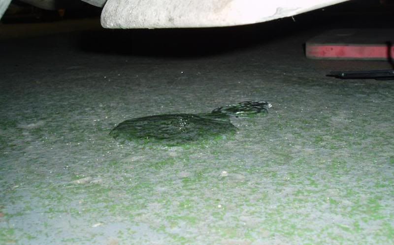

Now what your really want to see is a puddle of water appear on the floor just under the front sill area

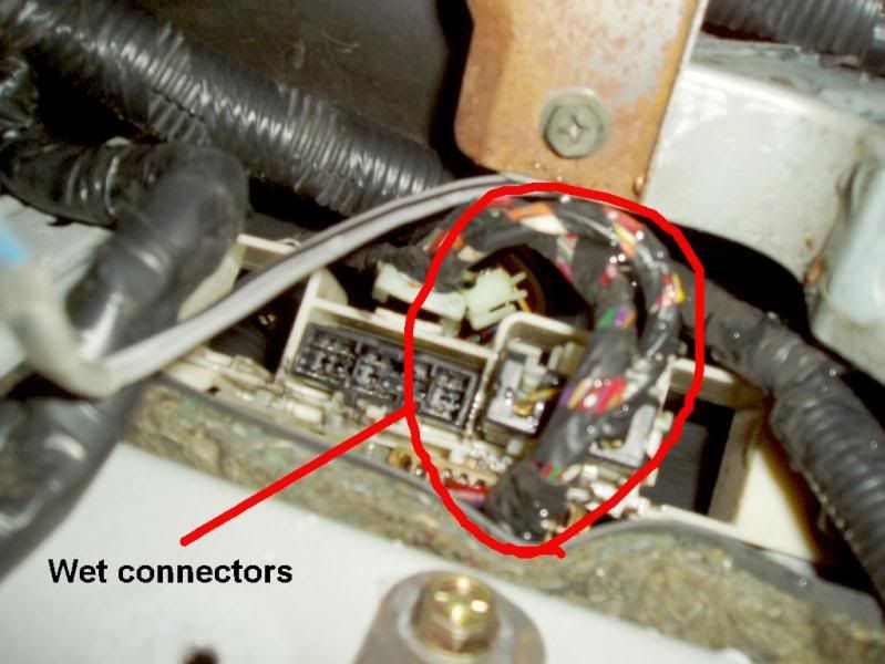

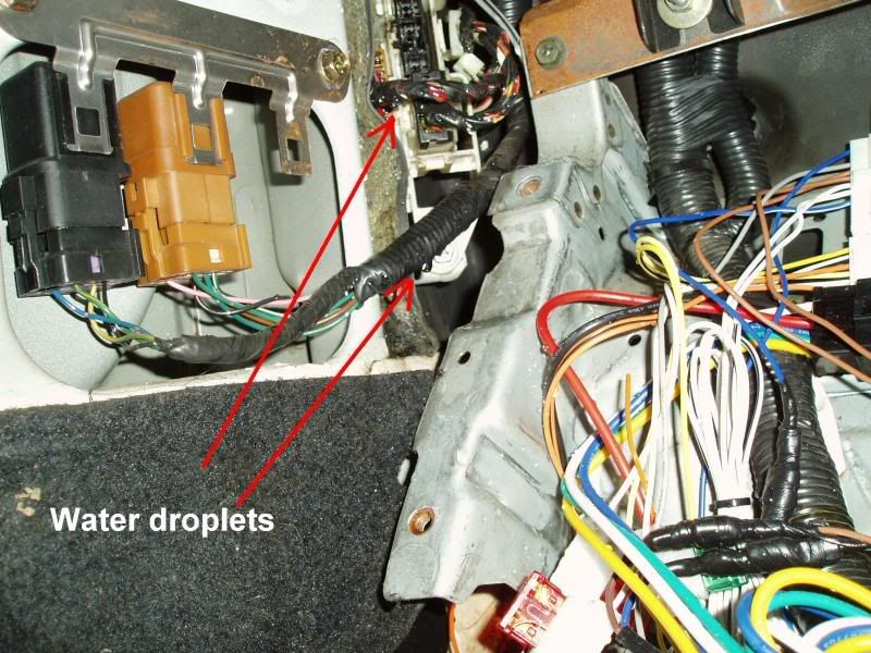

But what we got was very different, , a very wet set of relay and loom connectors

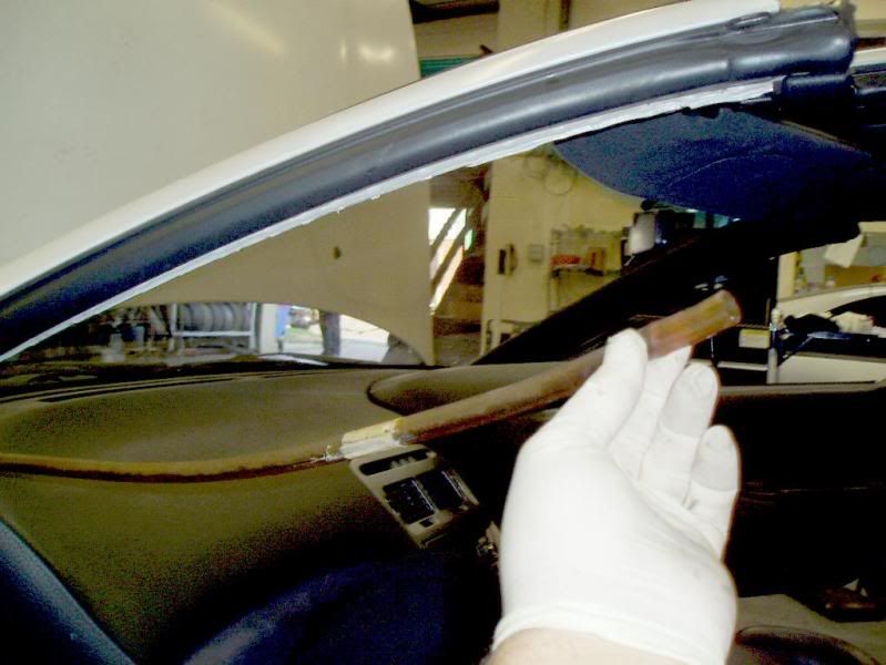

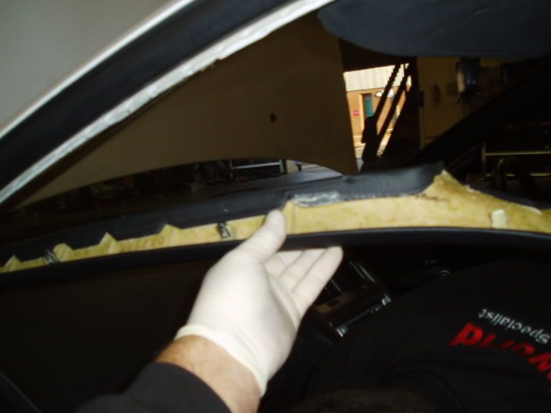

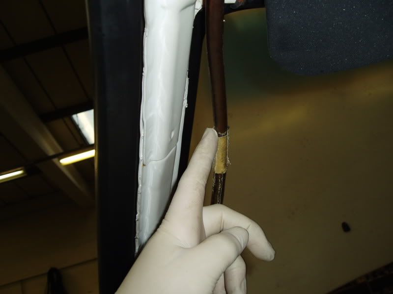

We removed the A post trim and set about checking the drain tubing for any pin holes Pic.5,6,7,

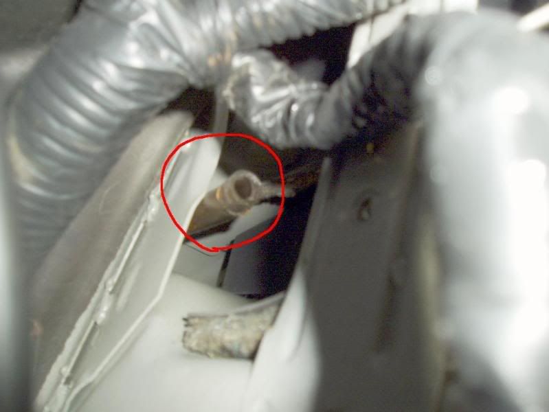

With no issues higher up we took more panels out and eventually found the culprit here, the final stage sill drain pipe disconnected
Quite how this had come detached from the connector to the sill drain is a mystery, however athough a real neck and wrist breaker to get in the deed was done and tested, now all the targa drain water stays where its is supposed to OUTSIDE.

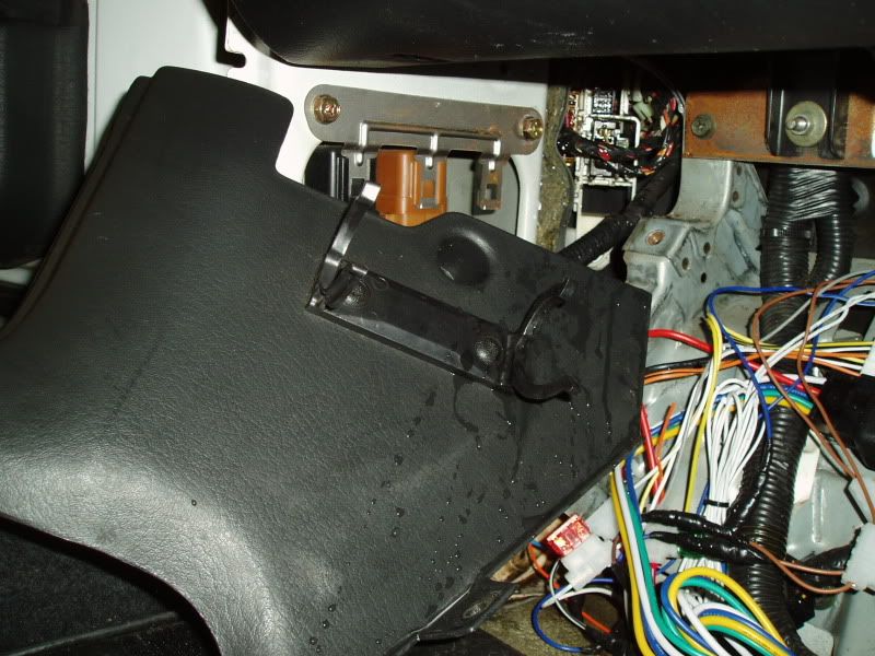

Hi just a quick question what is that plastic holder for on the nearside kick panel ??? Have one on my 93 j.spec and would love to know what its for.
Id like to know too, might check to see if one of them car fire extinguishers fit in it.
Its for a flare. Its only aloud in japan for when you brake down i think?
There ilegal in this country as its class as a fire arm ;)
if anyones interested i still have the flare from my car... forgot to give it to its new owners lol
My old car had one in too... thought it would be safer to set it off than just throw it in the bin :) (p.s. if you do set one off, be prepared for smoke... LOTS of smoke!!)
Thanks for the info Car.Mad dont think I would like to have a flare stowed in the cockpit lol.Think I might try to find a very small fire extinguisher that might fit in the holder.

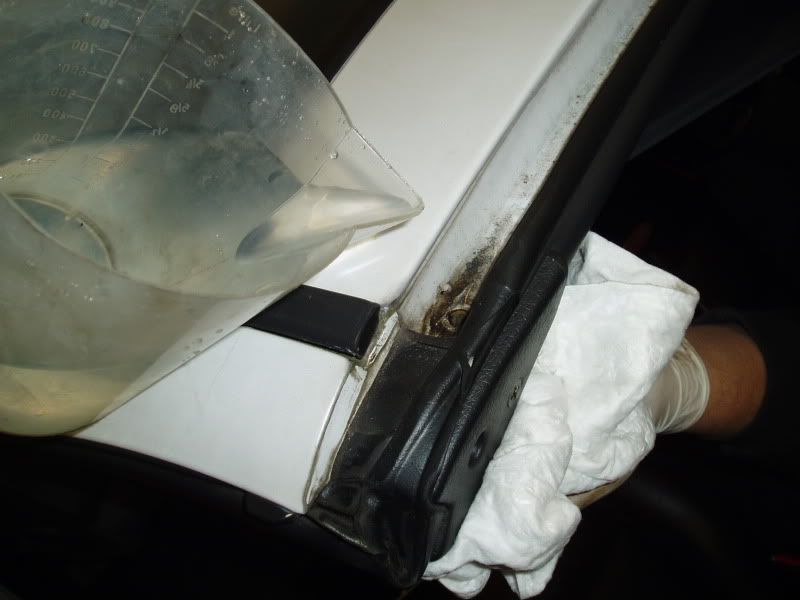

Jeff, im not quite sure where this picture is taken
but how could the water you poured in at the top come out of the bottom if the pipe is disconnected
(I'm assuming this is the same pipe?)
rich
rich
Ok the the picture was taken looking up, I can see how you would mistake it for looking down.
Imagine looking upwards along side of the glove box that where its was.
Jeff TT :D

I 've had the same problem now, can you tell me where that pipe in the passenger footwell goes, i know you said it was a real neck and wrist breaker, but a hint would help.

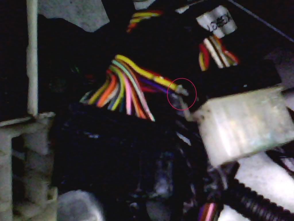

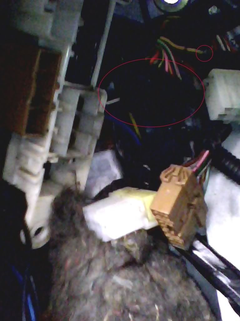

The white connector block houses four connectors, one of which is black, a yellow and silver wire has broken away from the block and theres no room to join it.
Everthing is working fine and I wondered if anyone knew what this wire connects to?
Edited by plazmaduck
Here are some rubbish pics but they may help a bit!!
These are located behind the passenger kickplate.

Update: In addition to the above, when starting the engine, the 'power' light would flash several times. I found the wire next to the snapped one also loose, so checked the whole lot.
I've hardwired the two wires and normality has been resumed! It also occured to me earlier, that running the drainage pipe into the sill wasn't going to help, even short term as the sills are at the same level as the floor :headvswal
