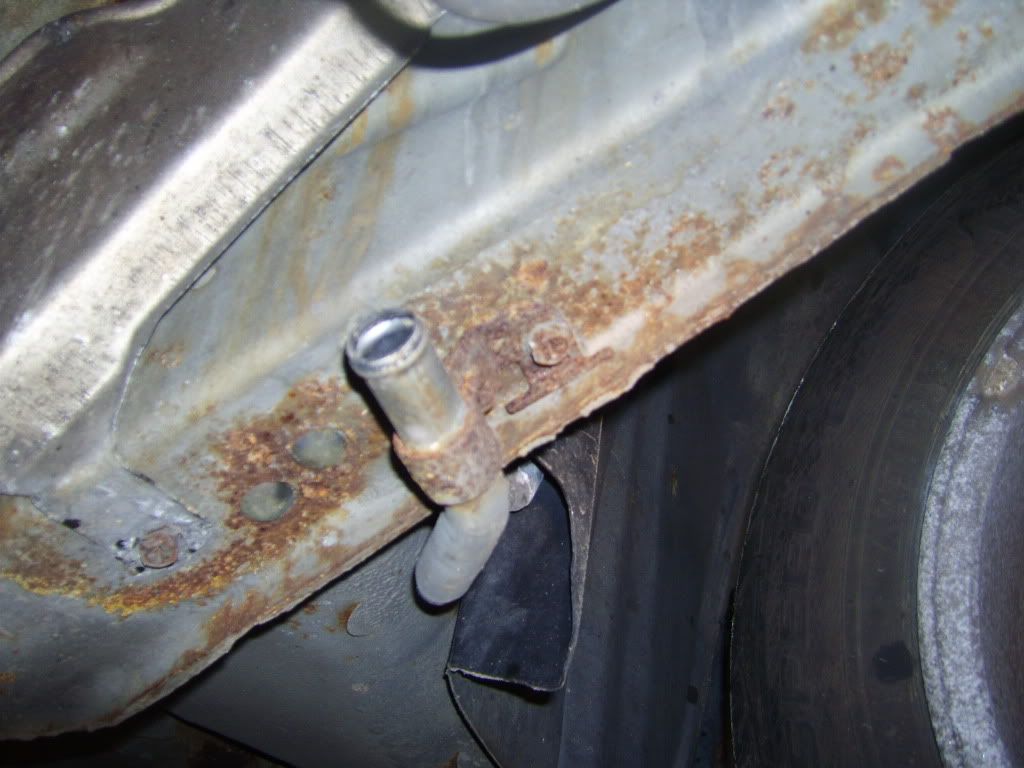

a pipe that goes nowhere? i have one the same on the other side
looking at it, you would think that this engine worked
They are from the Holes in the Targa tops as Drain holes so Water doesnt get stuck in them and Rot the metal! They are meant to be like that :)
These pipe come from the A.I.V system (behind the plastic wheel spats) and conect to the stock nissan exhaust system.
After market exhaust systems dont have this connection so you find these pipes not connected.

on a non turbo that would be interesting.
think you`ll find they`re a.i.v that would be one hell of a drain!
