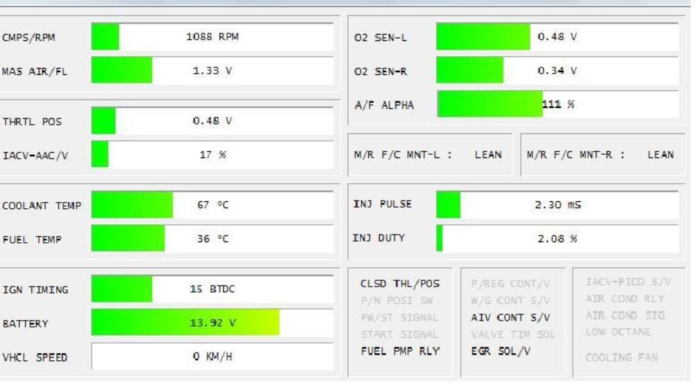

Conzult tomo, what should i be looking for to cure my emissions?
emissions are 6.5% on CO (carbom monoxide) it should be under 3.5%.
(ive sorted all vac leaks before i coudnt remove a pipe off the balance bar ortherwise would cut out)
im suspecting its the Lambda/o2 sensors, but whilst on conzult what else should i be looking for?
Im off down AnthonyDs by the way :duffer:

thanks guys,
the injector connections are brand new.
ECU shows no errors, so im asuming the water temp sensor is fine (if it was broke, didnt think the car would start, due to flooding)
and if the MAF was gone thaught woudnt rev past 2500rpm.
car runs fine, will conzult show if theres any errors with these things?
or do i have to look at the figures it provides me, and then work out which ones are out?
