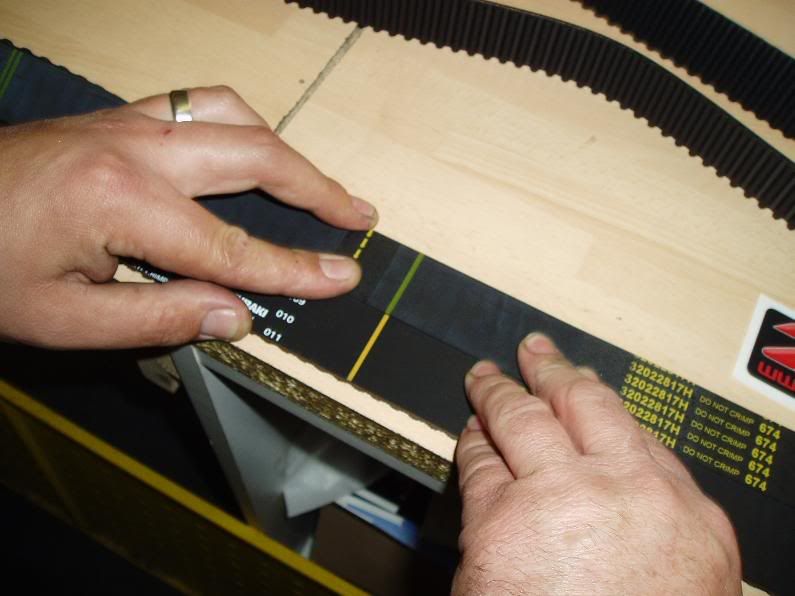

Picture one the start on the left we have a BLUEPRINT belt and on the right a Nissan belt.

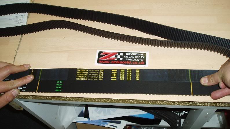

We start by lining up the first set of timing marks, the Nissan belt is on the bottom
Moving along to the next timing marks holding the belts in place the next two timing mark are already not the same on the non Nissan belt, they two mark are showing shortness of timing

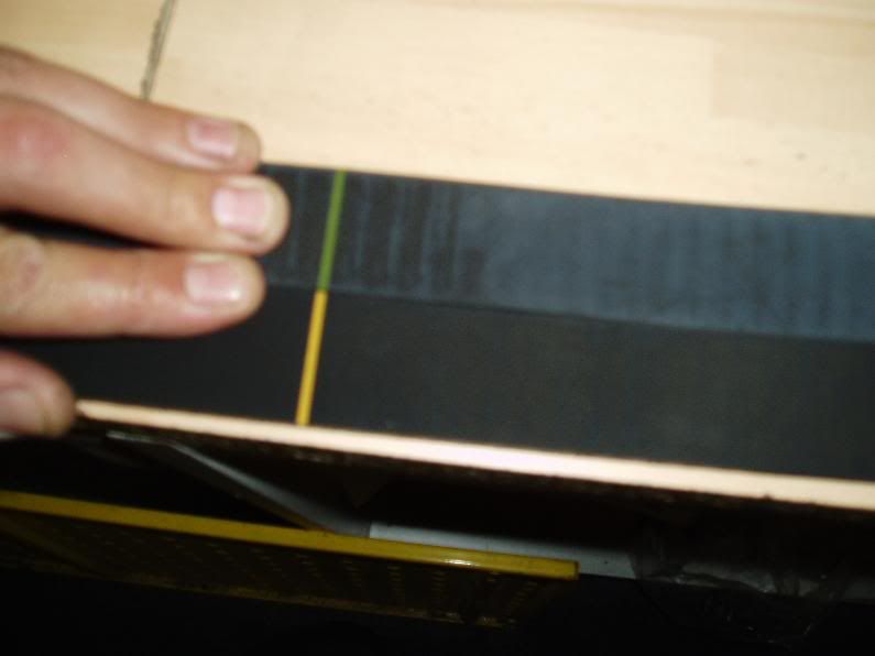

Moving along to the next timing mark holding the belts in place the marks line up

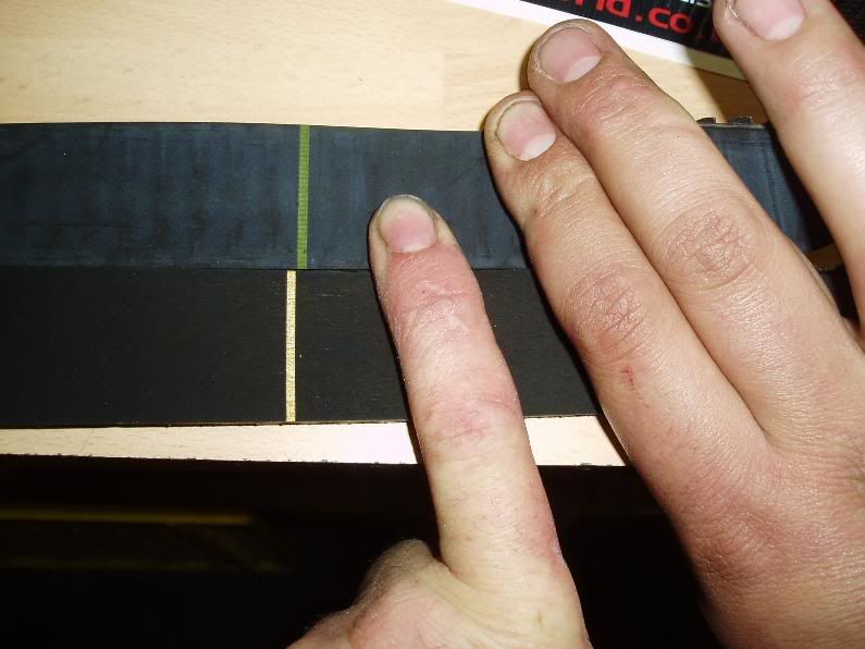

Moving along to the next timing mark holding the belts in place the mark fails to line up again and show shortness of timing.
Moving along to the next timing mark holding the belts in place the mark fails to line up again but this time show extension of timing

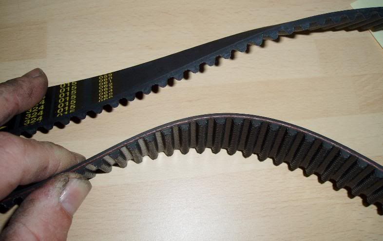

Here we have the two belts side by side with the Nissan belt on the left, the materials are very different, the non Nissan belt is less firm
Here we have the two belts side by side with the Nissan belt on the bottom, look to the belt edge and you can clearly see a red reinforcement line in the genuine belt and non in the non genuine belt.
Also look carefully at the actual teeth shape in the valleys and peaks the non Nissan belt is very different, in fact when wrapped around a cam sprocket the fit is compromised.
As we can clearly see the two belts are not the same, the non genuine belt has compromises that will give poor cam timing, poor ignition timing, poor cam sprocket location, and more worringly the 60k change interval cannot be considered applicable as it can to a Nissan one as the belt strength does not match the Nissan one in material quality or fit.

The amount of difference between the markers on the belt would not lead to the timing being out. The 'step' difference on the sprockets is quite large and you would have to be a plank to get it wrong.
:) Haha, I agree really, i always do it the old fashioned way, i guess i don't trust the marks on the belts, regardless of car or manufacturer of the belt, but maybe that's because i was taught by my dad, maybe a bit old school, but it's always worked for me! But a very important subject/problem explained in detail to us all by jeff, nice one pal, keep them coming!
