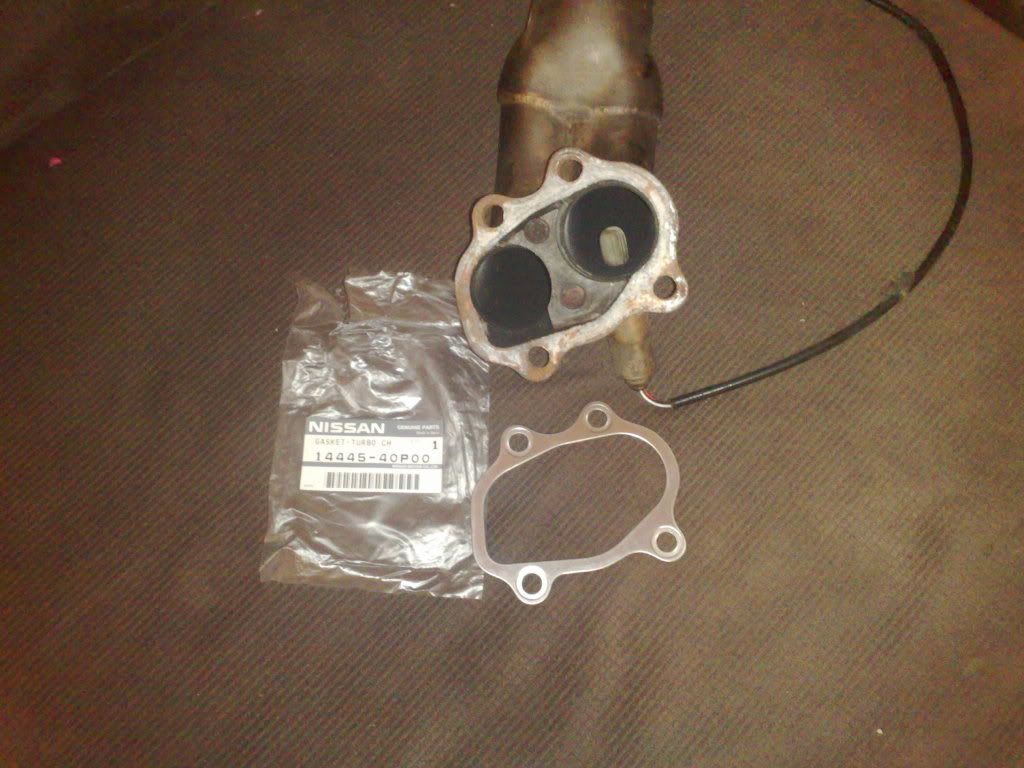

The Down Pipe to Turbo gasket in that picture is incorrect, it clearly shows a center bar, which wouldn't fit because of the separator... see this one, Red for the gasket and Blue for where it is supposed to go!

As you can see from this quick pic of mine, that are waiting to go on, there is NO center bar!
HTH

I think I just removed the centre bar when I fitted mine. Its bolted on and doesn't work with the stock turbos. I think that was the case, but it was a while ago now and my memory sucks. Either that, or it came with both style of gasket. I do remember noticing the issue, but it was'nt a problem, whatever the solution was.
