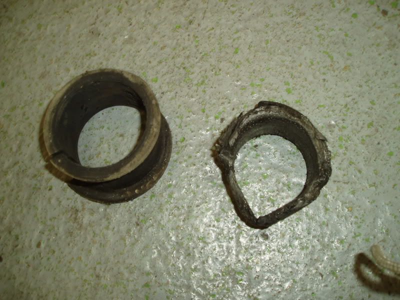

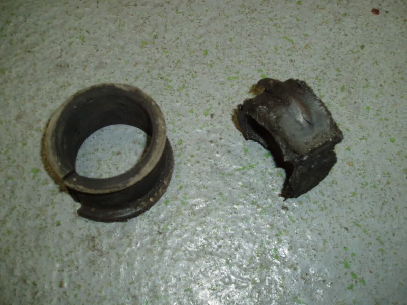

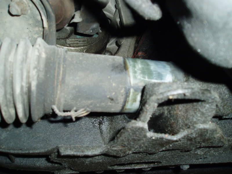

But oddly one area that often gets overlooked is the steering rack bushes, these two rather large rubber sleeves keep the steering rack in position laterally.
Check out the photo's below see the state of the two bushes in particular the right hand one which was completely useless, in the next photo you can see the amount of insecure movement of the rack due to the worn bush, basically when turning at a junction the rack was able to move almost 30mm BEFORE any wheel angle changes started this translated to a frightening ¾ turn of the steering wheel. You can guess my surprise when road testing and encountering my first island! of course a couple of bushes and all was well again, interesingly the car came in for unrelated work!! just shows what you can get used to over a period of time.

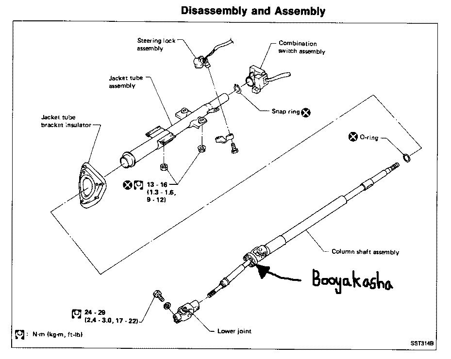

One other thing I found made a big difference was to change out the rubber 'donut' coupling 1/2 way up the shaft in the engine bay. It looks like it's actually designed to give a small amount of slack in the neutral position, presumably to isolate road noise.
I made up a solid s/s replacement for mine years ago and it did improve the feel a lot. I think driftworks sell them too.

Is it easy to change this column bush with the engine still in, whats involved for this job?
yeah its easy enough, just be paitent, and dont turn the steering wheel or wheels once its off lol
Where abouts does it go??
