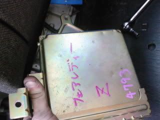

the neg signals come from the ECU. Tested the ECU on anthony Ds Single Turbo Z :bow: it worked.

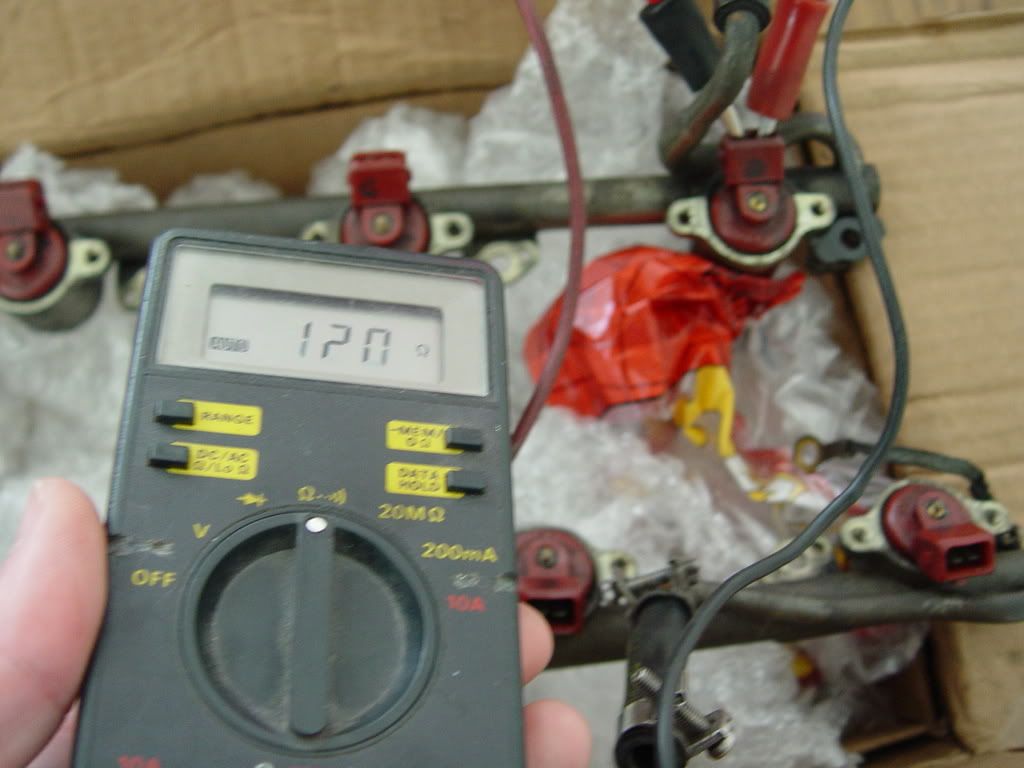

Ohm tested the injecrtors themselves direct, like this....
they were all in spec :)

I hope you didn't use the red NA injectors (the ones shown in the 2nd picture) in a TT-engine with a TT ECU ?
na mate, that pic isnt mine there, just an example od testing the injectors i nicked off the US forum lol
