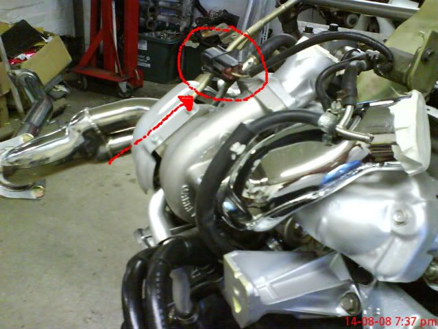

First things first, I pretty sure this is the boost solenoid connection:
Trouble is i can't for the life of me find the other end that it plugs into and with no boost controller my car sucks on the power stakes :(

With no solenoid connected, your turbos will be running unlimted boost.
the car has the solenoids, that pic is the connector coming off it.
think he means he cant find the connector on the loom to plug it to.
it could be a TT engine in a NA car, with NA loom.
the NA loom doesnt have the wire/connector that plugs into the boost solenoid.
perhaps then someone has had a electronic boost controller fitted at some point. but then removed it when sold it.
if you dont have the wire on the loom to plug to the solenoid, you need a electronic boost controller.

That is the wastgate solenoid connector as you said, assuming your zed has all the correct cables/ connectors as it should then the other part of that plug is hanging down below the area your looking at, may need to remove some pipes etc. to access it.

If the plugs have been cut off and cannot be located just apply an ignition controlled power supply to the boost solenoids and all will be restored, note though there will be no det control.

Yes if you power the solenoids you will get full standard boost, as far as det protection with the standard set up if the det sensor detects a problem it kills the power to the solenoids to reduce boost.
With a boost controller most people disconnect the solenoids anyway so this facility is lost.
However the ecu will still retard the ignition if det occurs so a degree of engine protection still exists.

so which end have i got? i thought i have the loom end, it's the other end i can't find, it's all very confusing, especially as i'm not really sure where to look lol. had a good look today with a torch and still can't see anything on either side.
well looks like its the solenoid end,
does it go under by the side of the engine? (where the solenoids are)
or does it actually go to the loom (the big thick black tube with all the connectors for the coilpacks & injectors)
Jeff, does it matter which wire you connect the + to on the solenoid? (polarity sensative)
Goes to the later, the big thick black tube with all the connectors for the coilpacks & injectors
That pic may help though, looks like i'll be getting right under the car tomorrow then.
if its going to the big thick black one,
thats the loom side.
you need to attach it to the solenoid on the side of the engine.
remember, there are 2 solenoids, 1 each side of the engine. so look at the oposite side to check that one too :dance:
