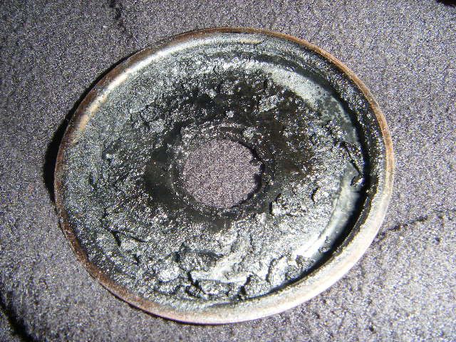

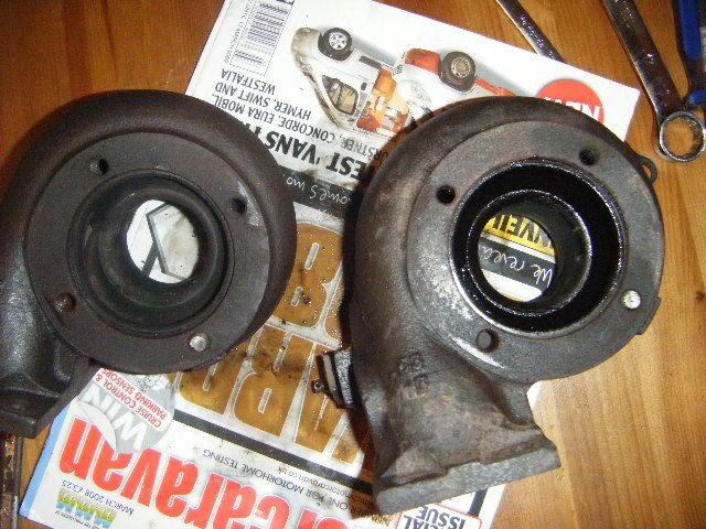

same snapped bolt on both housings
evidence of fooked oil seal
Did you just do the standard drill and retap on the bust bolts?
Well you have to be very carefull how you do it. The bolts are made from INCONEL, a material able to withstand high temperatures and keep it's strength. Unfortunately it is toughed than the cast turbo housing so the drill tends to wander off when drilling out (when drilling by hand).
You really need to take it to an engineering shop who can holt it rigid in a miller to drill it out.

I was lucky I had spare housings with clear holes, just as well.
