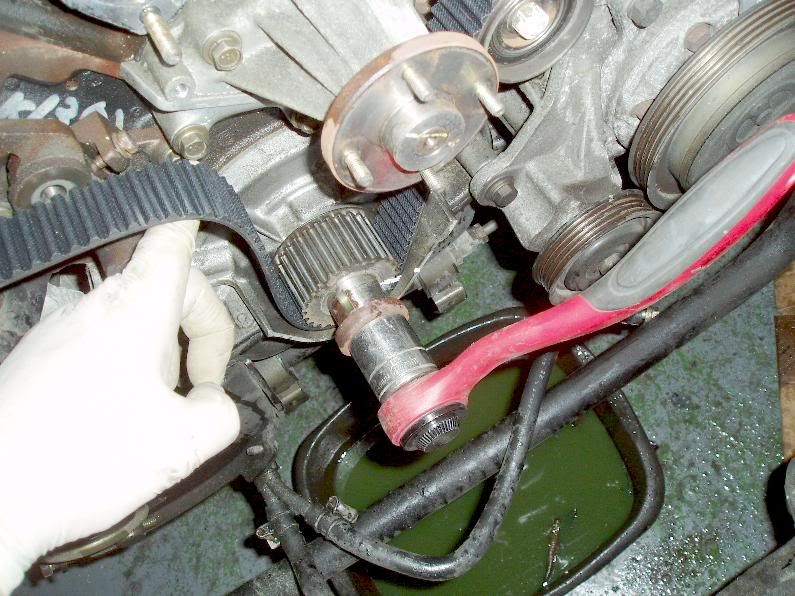

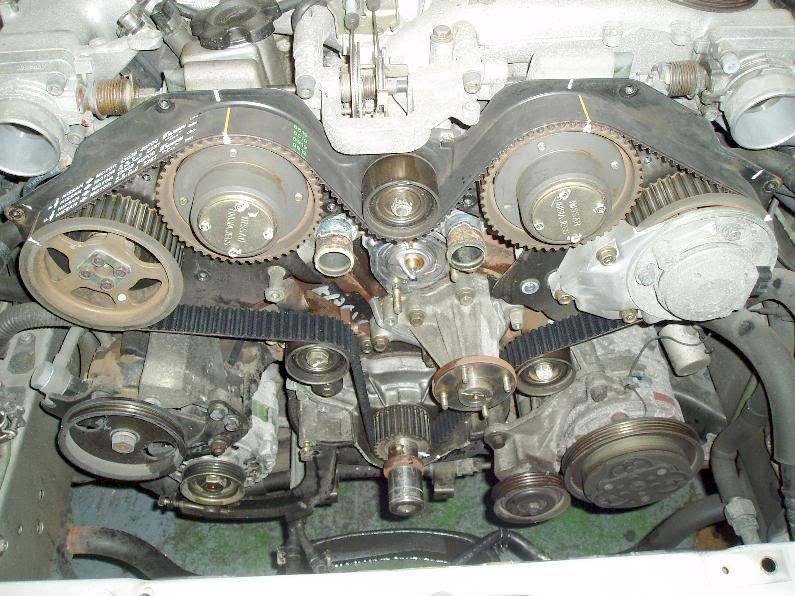

The following write up is not a detailed cam belt swap far from it, as requested by Andy Gp this just deals with the actual method of timing of the belt when replacing with a new one, the engine in question is in a scrapper we use for photo purposes hence the belt is all I have concentrated on.

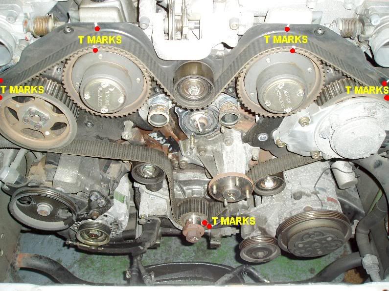

Here we have an old belt fitted with all of the reference timing marks highlighted

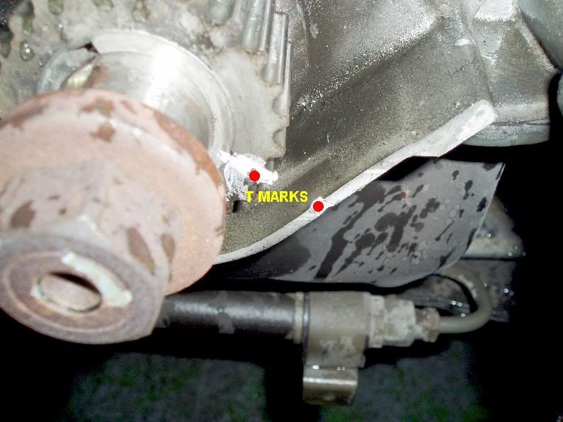

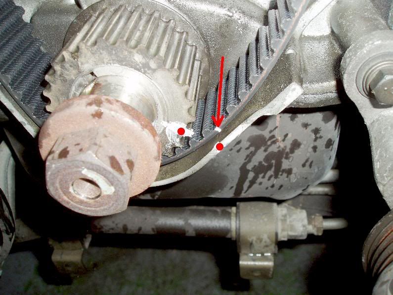

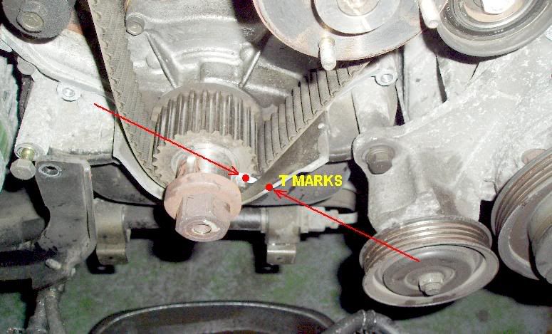

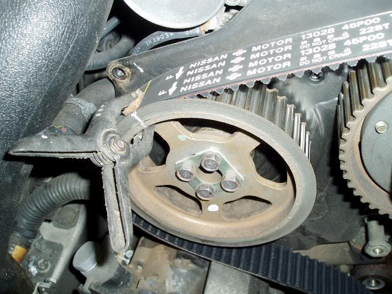

Here we have the crank sprocket, this is where most mistakes are made due to the marks been low down and less easy to see.

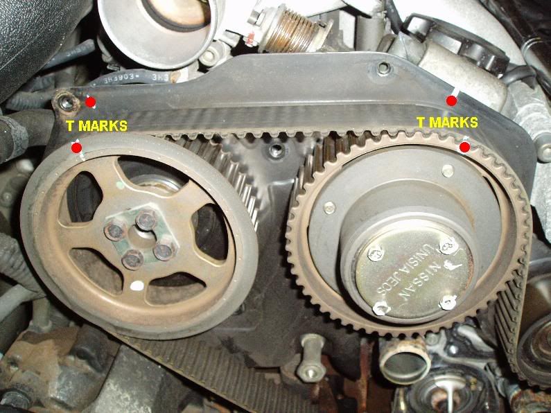

Left hand cams up close showing reference timing marks
Right hand cams up close showing reference timing marks
Bottom sprocket showing timing marks

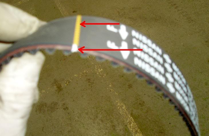

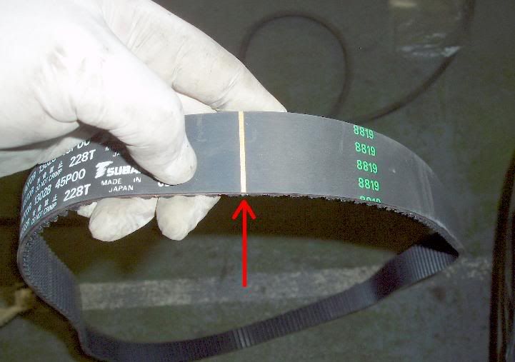

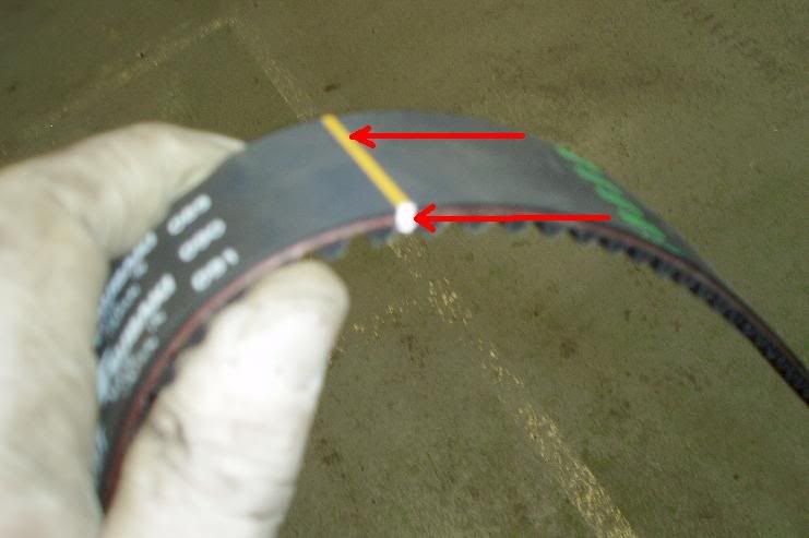

Preparation now, the new cambelt comes with all of the timing marks set out on the back of the belt in a yellow colour. A little trick is to mark the edge of the belt in line with the original marks with tipex, the reason for this will come apparent later.
cambelt timing marks
cambelt timing belt + tipex

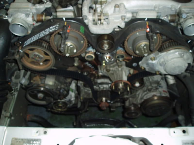

Having previously prepared the new belt marks and the reference marks on the top back plates, cam sprockets and crank sprocket the belt can be loosely fitted.
Starting at the right hand cam sprockets feed the belt on ensuring the marks line up, (TIP use bulldog clips or similar to hold the belt in place on each sprocket) most times this leaves the last cam sprocket on the left not lined up, use grips or similar to turn the sprocket slightly until it lines up, REMEBER and I cannot mention this enough, to be lining the BELT marks with the SPROCKET marks and NOT the back plate, they where only for reference, there is a set teeth count between the various timing marks and this is why the belt markings against the cams is the important settings, in fact the back plate markings will not all line up with the belt later do not concern yourself with this provided the belt/cams are ok

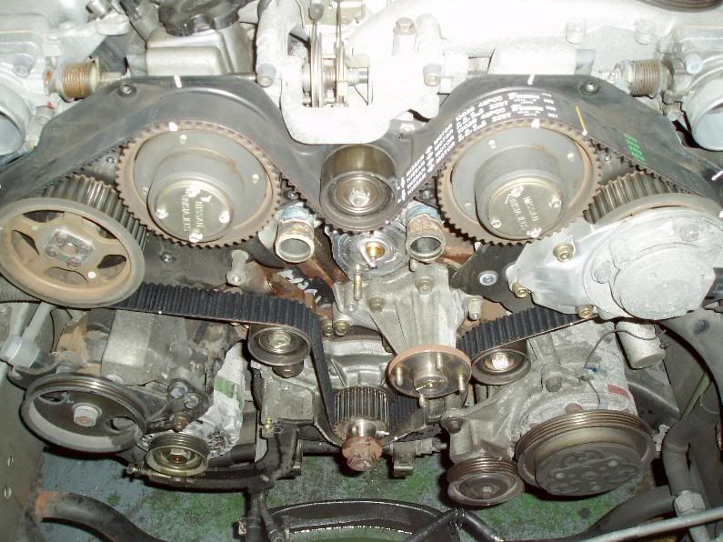

The belt is in place and clipped

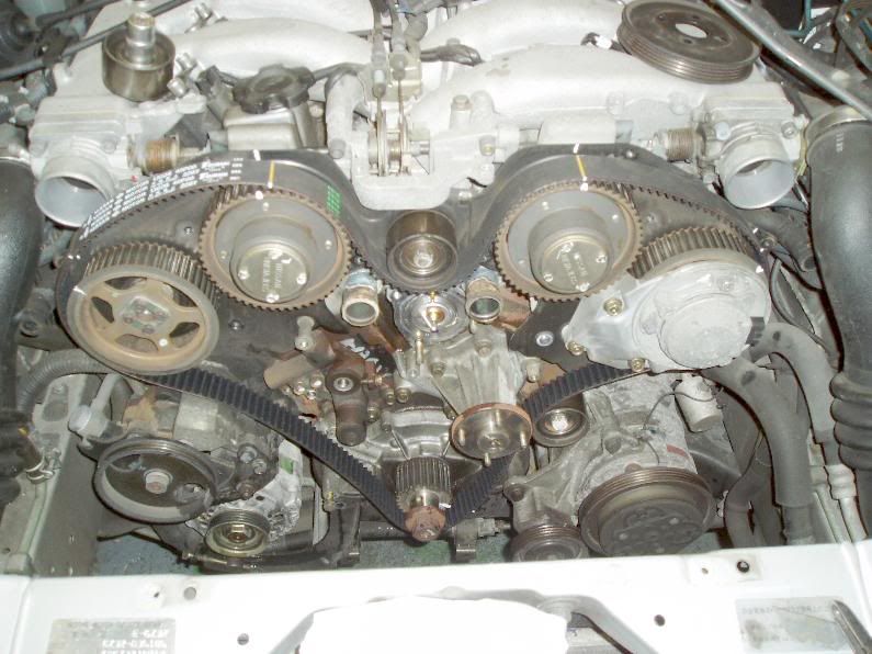

Overview of total belt fit ( loosely) with clips in place.

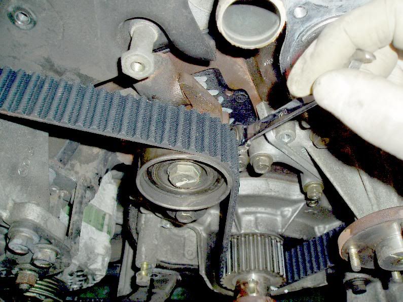

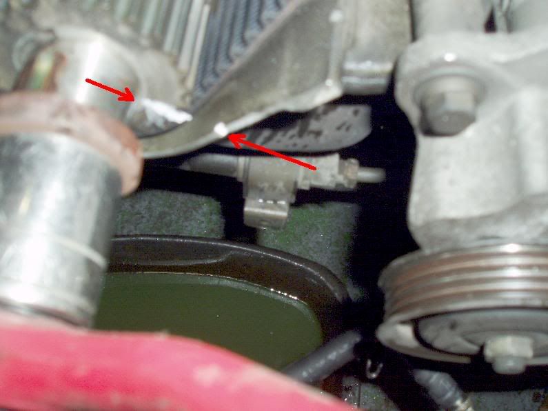

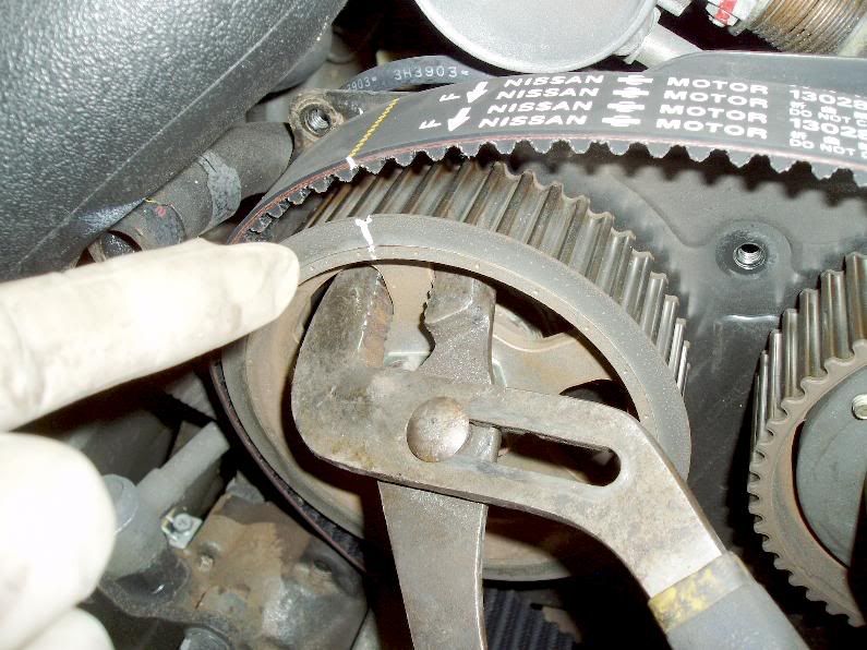

So now to the bottom sprocket, this is where most mistakes are made as the belt timing line is almost out of view from above, now the tipex marking on the edge of the belt makes sense, as shown the belt is still loose and the bottom sprocket is NOT lined up

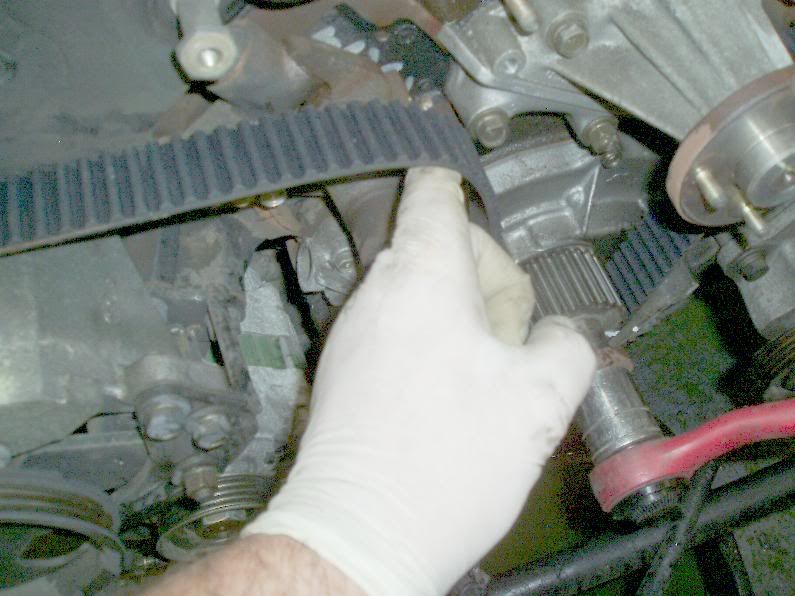

As the top of the belt is held in place by the clips the cranks can be turned slightly till the marks line up.
Bottom sprocket lined up.

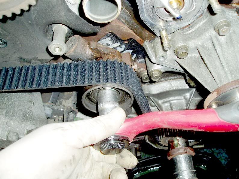

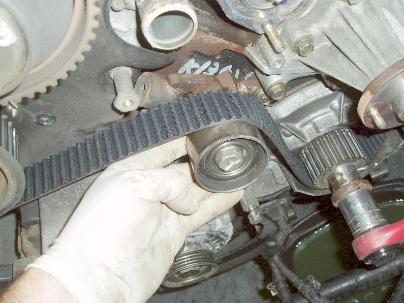

Introduce the tensioner pulley complete with 17mm headed fixing bolt, use the pulley to keep the belt tight as the pulley bolt is tightened make sure the belt does not slip
Tensioner bolt been tightened, belt almost done

Overview of new belt fitted but NOT tensioned

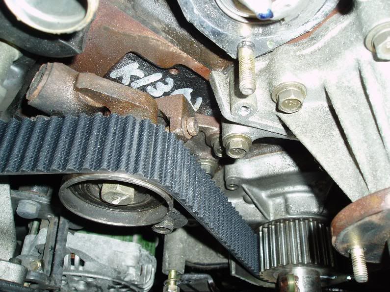

Now attention moves to the tensioner and the 10mm bolt that was used to compress the tensioner whilst the belt was changed, here the tensioner is still held completely in
Now check ALL of the timing marks, twice, and once again, remove the bull clips at the top
Undo the 10m bolt with a spanner, observe any movement at the tensioner, a slight amount will be seen but not fully yet, ensure the bolt is removed completely,

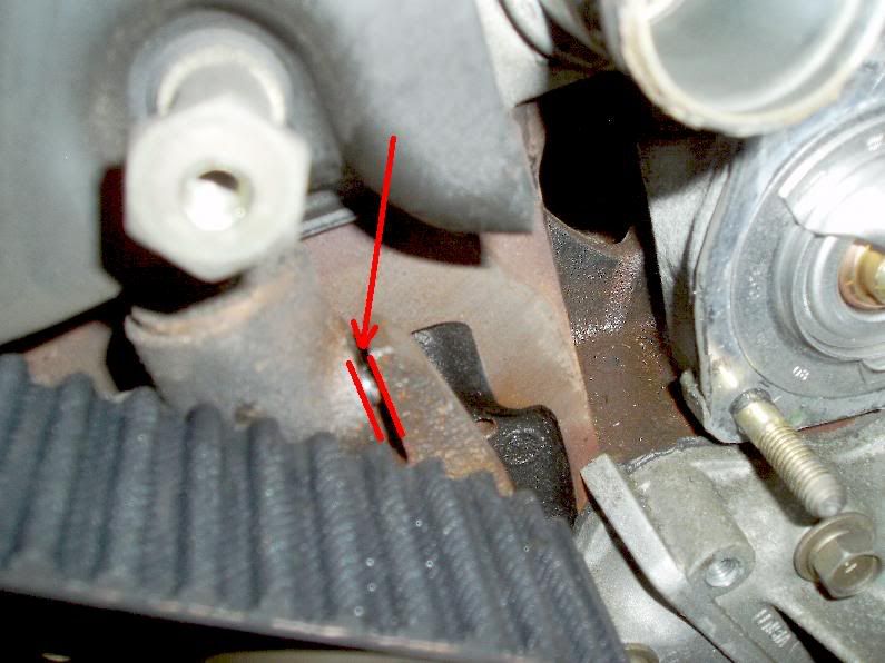

Turn the engine forwards one half rotation, then back one half rotation, now turn forward until the timing marks on the cams and the back plate line up approx. and of course the bottom sprocket, this should show more accurately (NOTE the belt marks will NOT line up at this point )
The gap in the photo is too small, approx. double that amount is preferred, if after turning the gap is incorrect the adjuster base setting on the block will need adjusting, this requires the 10 mm bolt to be refitted in the adjuster and tightened only enough to maintain the gap you have, loosen the 12mm bolts on the adjuster slightly, swing the adjuster block to loosen the belt slightly then retighten, now remove the 10mm bolt again and turn he crank observing the gap again.

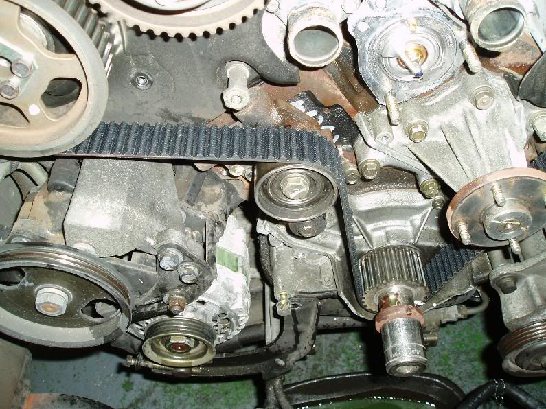

Here overview showing all in place tensioned and belt position showing the writing at the top right cams, one more final check of the timing marks and that's it.
