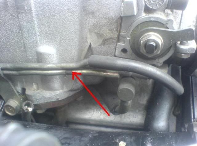

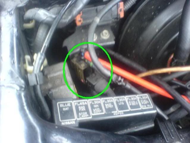

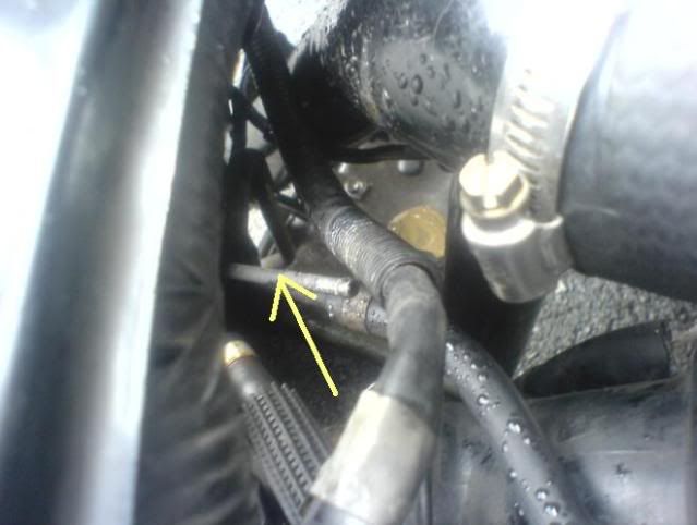

right think im gettin bit closer now, one of the coilpacks wernt on all the way, the 1 right at the top by the bulkhead.
ive noticed that this doesnt hard pipe doesnt have a pipe connected to it?
its on the driver side throtle body,
the metal hard pipe goes to this thing in the corner, by the fuses,
and also ive noticed this doesnt have anything connected to it, its by the passanger side, at the front by the light
when i put the ECU in, i made sure it was sitting correctly & in firm, as had that mistake before.
the clocks (speedo cluster) isnt conencted at the mo as ive swapped the dash, but il conenct it & see if any lights come on, after you advise on these pics....
