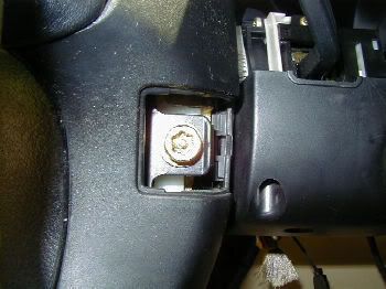

  • Replies 33
  • Views 1.4k
Terrible photos, but you get the idea. If I cut a profile into the side pod and sit it flush, it should look pretty good as much as by looking at it, the idea seems messy. Plenty of room, everything is at the right size/angle.

That looks good Si
You should find that you can just slightly move your finger tips to activate the cc;)
Indeed, nice and close and right next to the CC master switch. :)

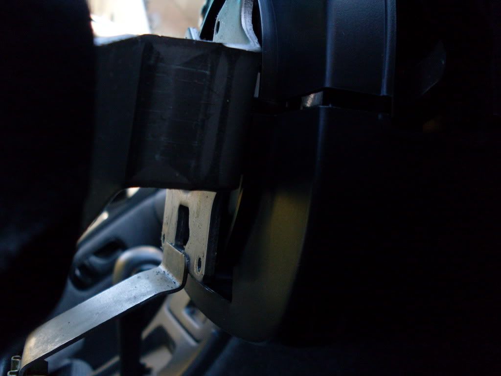

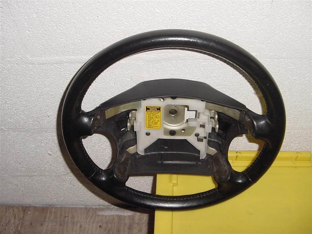

Here are photos of both types. Sure they are LHD, but look how much bigger the shroud is compared to the shroud of the non-airbag model. It won't fit as the hub will be in the way.

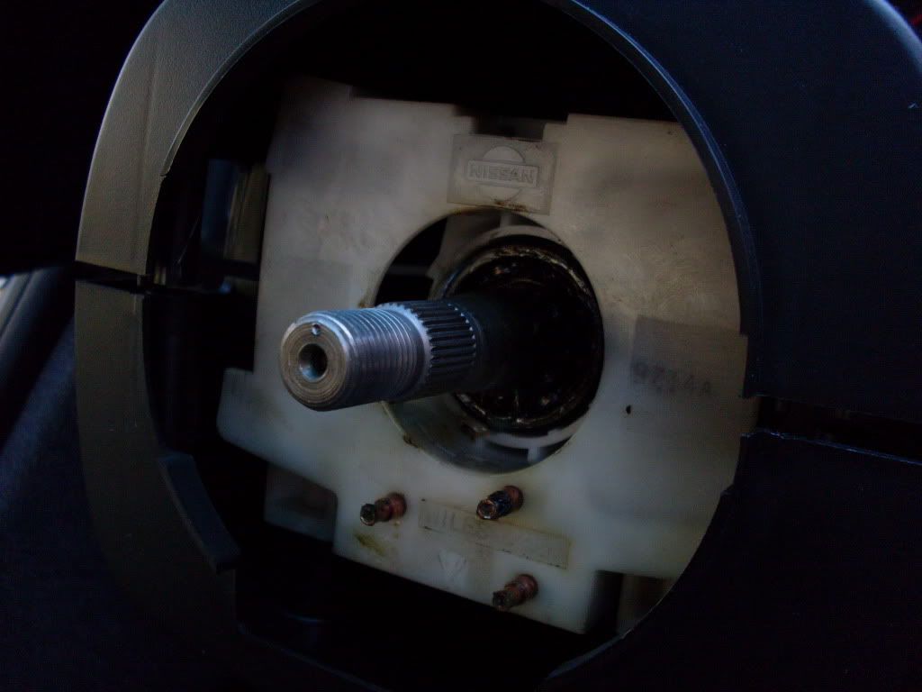

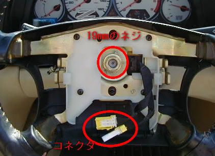

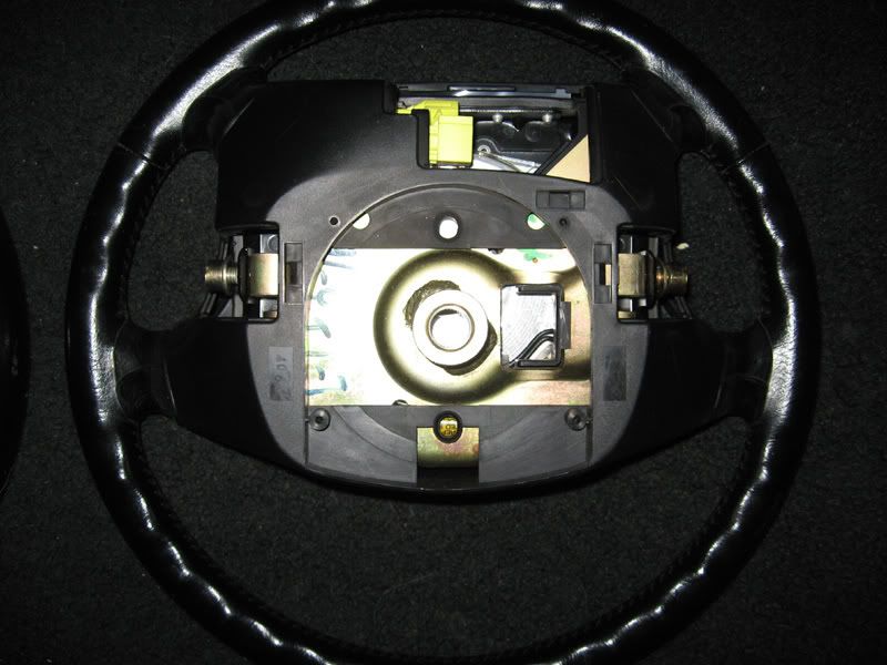

Yes they are visibly longer and the new column cover is proof of that. But the design of the airbag wheel is not the same as the none airbag wheel. Here are the photos of what Ive learned and recorded from my research on the matter. Even though Ive only been able to find LHD column as reference the internal parts are basically the same and in the same position.
As you can see the none airbag wheel when fitted back into place just clears the new column cover. The other thing i discovered was the combination switch for the indicator stork, still fits in the correct position for the new column to screw into so the indicator stork doesnt move for regardless of what wheel you have. But you need a newer style combination switch unit which im in the order of getting from japan atm. So obiviously the airbag wheel must be different.

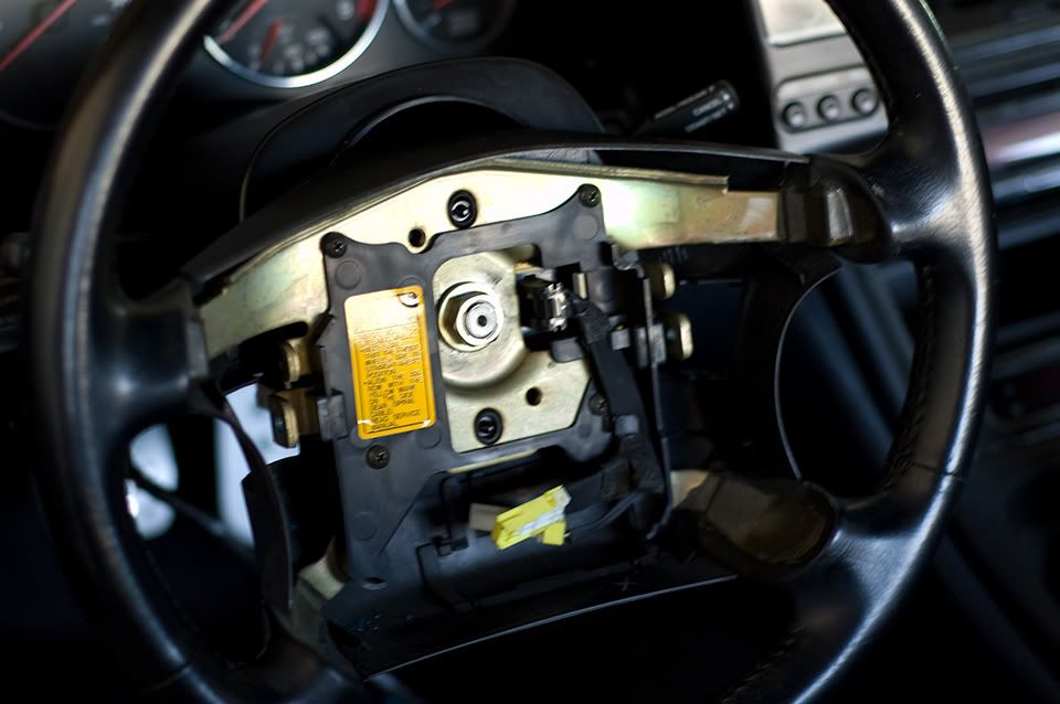

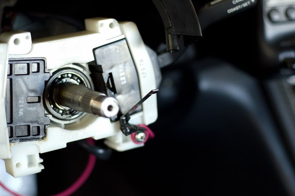

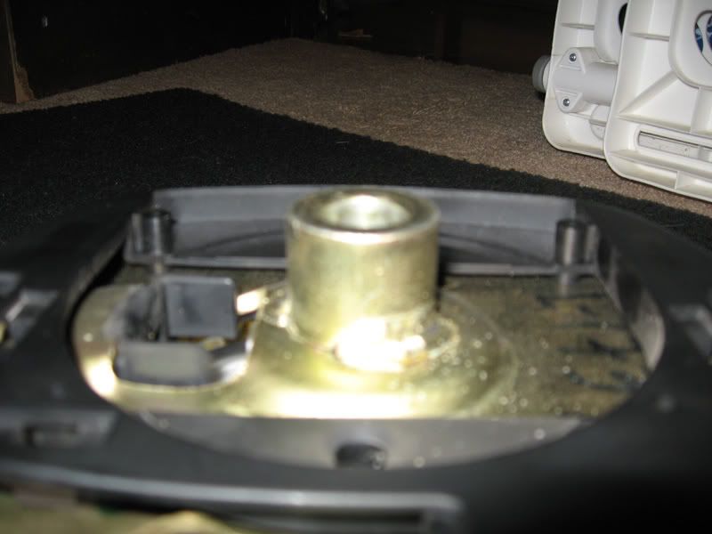

I forgot these 2 photos.
For me these photo are evidence it will work but like all things until i try it and see it in person i don't really know.
I'm still not convinced about the SRS CC paddel and shroud. Where will the steering wheel sit when it's got another 2" of plastic behind it? Be interesting to see a trial fit.
