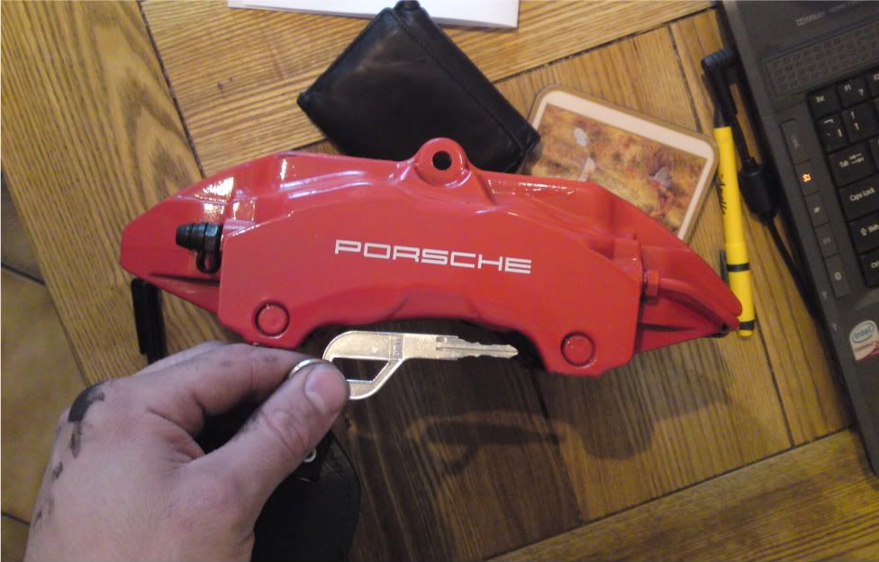

Got my hands on some 997 porsche brembos for next to nothing LOOK
Well after my epic fail of a track session at castle combe im now on a mission to improve my stopping power.

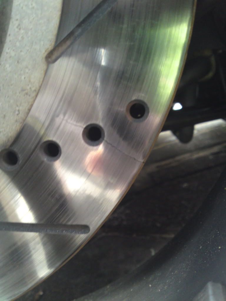

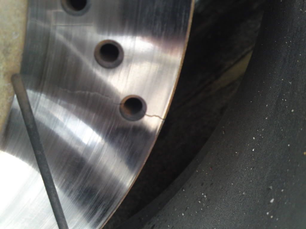

this is what happened to my discs whoopsy....

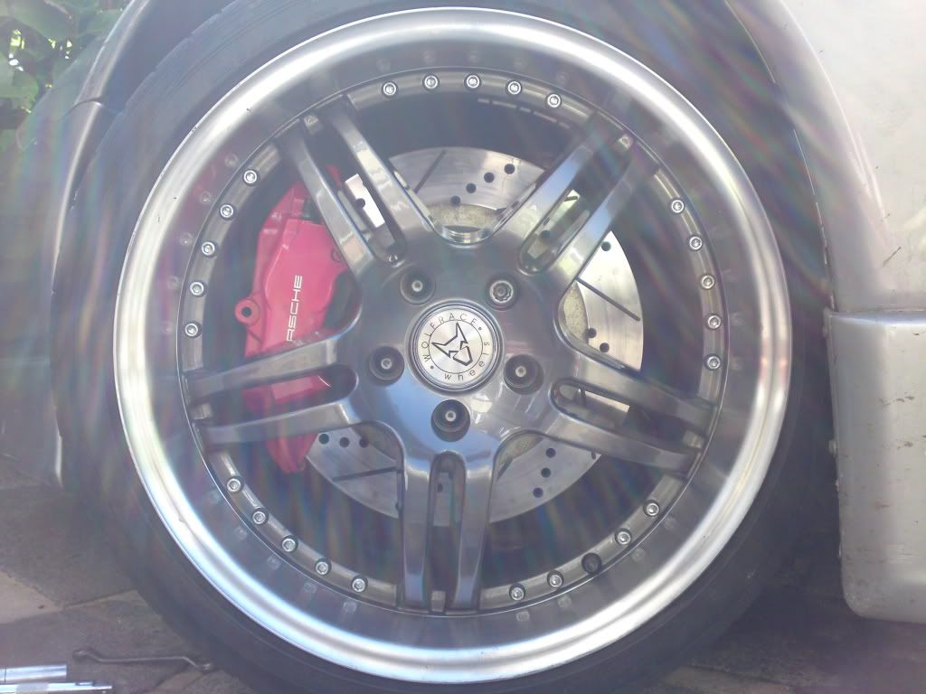

these are the puppies.....
:D
Now....where the hell do i start? do i fit some discs that i like then make the messurements to fit the calipers?

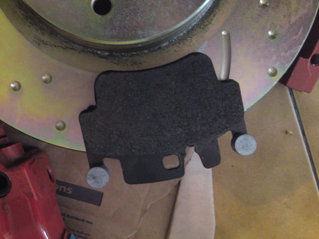

I was thinking to fit them on my discs i have at the mo then once i have them fitted buy the same discs but without the drilled holes and just slotted. But i have no idea what discs they are, il give z1 a call soon, maybe they can help. The only prob i had with them discs was the cracking, other than that the brakes always felt responsive and never had any fad even on the track.
obviosuly im going to have to clear the wheel spokes.
Anyone know of a good enginering shop who can messure and make brackets to fit these? they are brembos at the end of the day.

The reason your discs cracked is NOT because they were drilled, it is because you were using stock calipers/pads on a larger disc. As stated (by yourself) previously, the inside surface area of the disc was wasted. When using the brakes agressively (ie, track day use) the fact that you are only using a small proportion of the disc and poor heat dissipation of the caliper means that there is a much higher propability of the disc overheating. This is especially the case when you come to a stop after a track session and stay on the brakes too long whilst standing still. This will cause local overheating which in turn may cause the disc to crack. I have seen this on one other occassion on a 300 running bigger discs with stock calipers. Drilling/grooving discs introduces "imperfections" and reduces the effective surface area of a disc but it is a compromise between gas dissipation and effective braking.

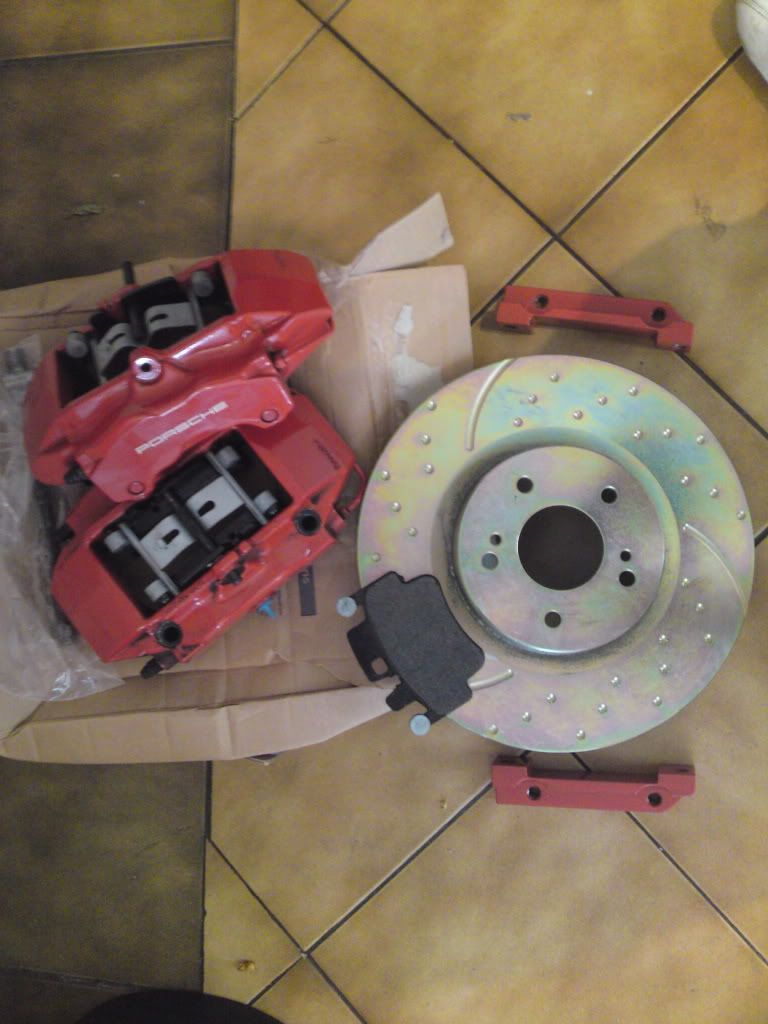

hmmmm The porsche discs are 318mm.
So 330 is enough? i think,
I did kinda gather the calipers were creating too much heat for the disc.

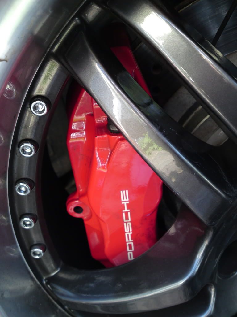

Anyway i test fitted the calipers just in place to check for any clearance issues. Looks ok to me.

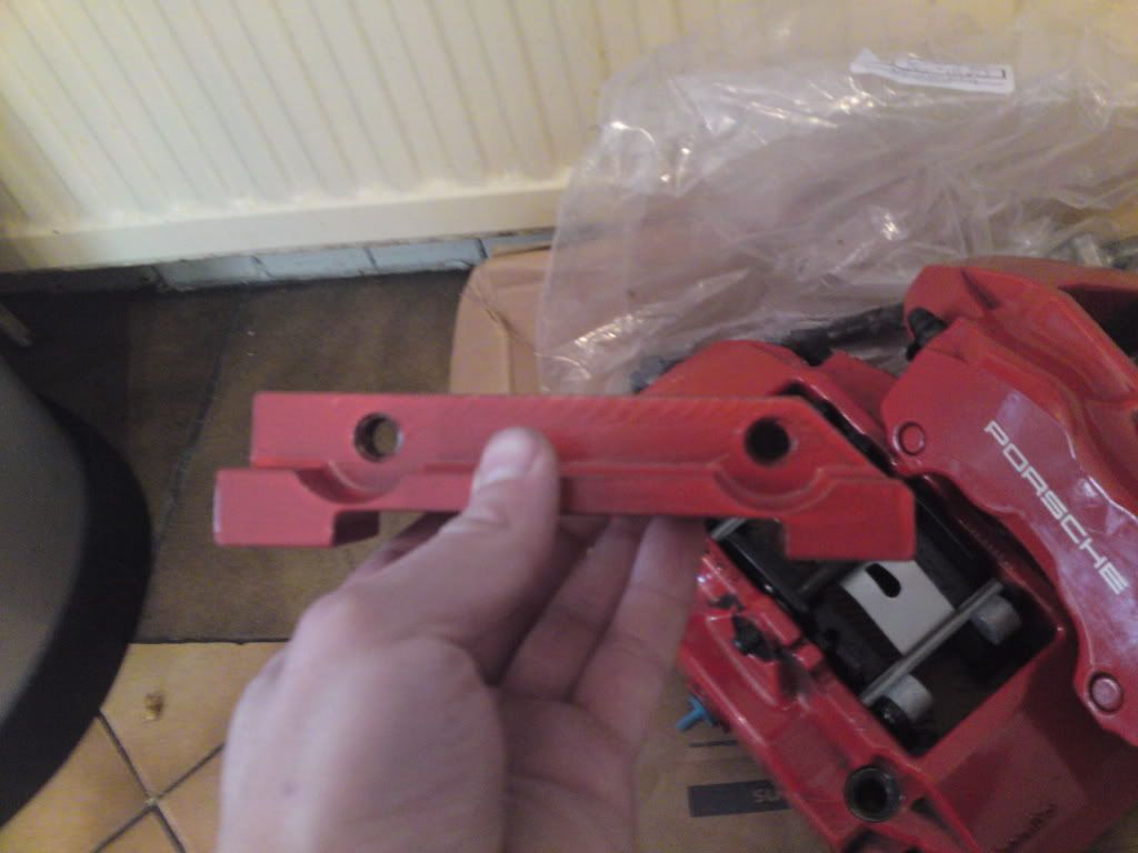

The brackets will be a job and a half. Will have to have a 90 bend as the caliper mounting holes face to the rear of the car.
As someone mentioned earlier i think i should borrow a front hub and send the disc caliper and hub to an engineering shop to be made up.
Anyone have one they could lend me?

Right ive spoken to a few engineering shops, One called J G engineers in enfield is close and they seem to be keen for the job, Im dropping off my spare hub 330mm disc and caliper with pad to have it measured up see what they come up with. I mentioned mild steel which he said is fine but will rust, what can be used to keep it from rusting?

Well the brackets are made which cost more than the calipers lol, I painted them to protect from rust. with good ol hammerite which will take the heat.
Bought some heat treated ebc 324 discs, dont know how long they will last before they warp but its a start :D
The pads are a perfect fit to the discs surface, what a flook.
And i got me all the bolts to fit them in :D
