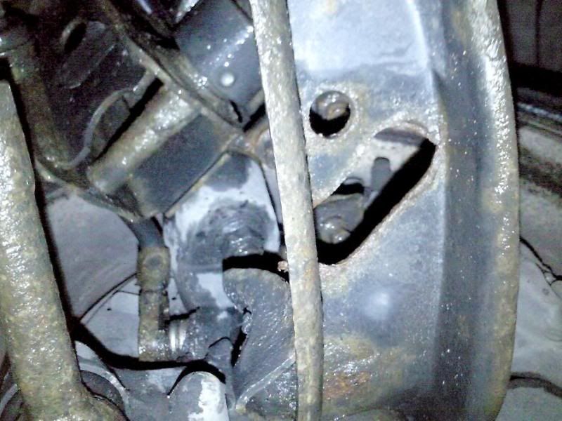

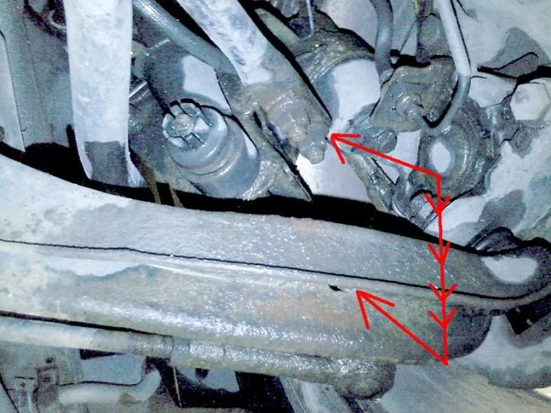

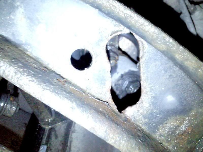

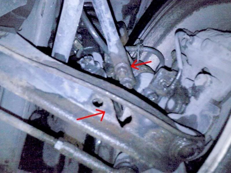

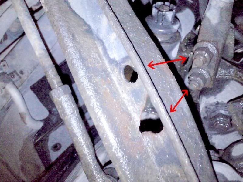

Check out the photos below, the tension rod arm fixings have become detached completely taken a section of the lower arm with it.
The arm was discovered by an RAC recovery when called to the car on the motorway with a puncture on the n/s front, the owner not really understanding the full implication continued to drive the car for a few days until the steering feeling eventually got so bad it was uncomfortable
With the wheel removal all was revealed, the tension rod arm was completely adrift and the lower arm loose to move, in fact the wheel was able to move so far back it hit the wing and so far forward it hit the bumper!
With a bit more investigation it came to light that the unfortunate owner had hit the wheel on a kerb in the snow when he lost control negotiating a traffic island in FEBRUARY!! Close inspection of the lower arm you can see the metal ripped, the impact had started a stress fracture and over the coming miles the eventually metal fatigue cause it to rip out completely, driving with the puncture was most likely the last straw.

Everyone should check for cracking in the lower arms where the Tension rod bolts through, not all that uncommon.
Jeff, can this sort of thing happen through normal road use? IE, with no impact damage, can the arms still fail?
Mmm as Legrath said worth checking on all zeds, 20 years of twisting and flexing, the real issue the load is not spread enough, a spreader plate under the nuts is the answer, will post a picture of what we fit to stop this once I find it in my photo files.
