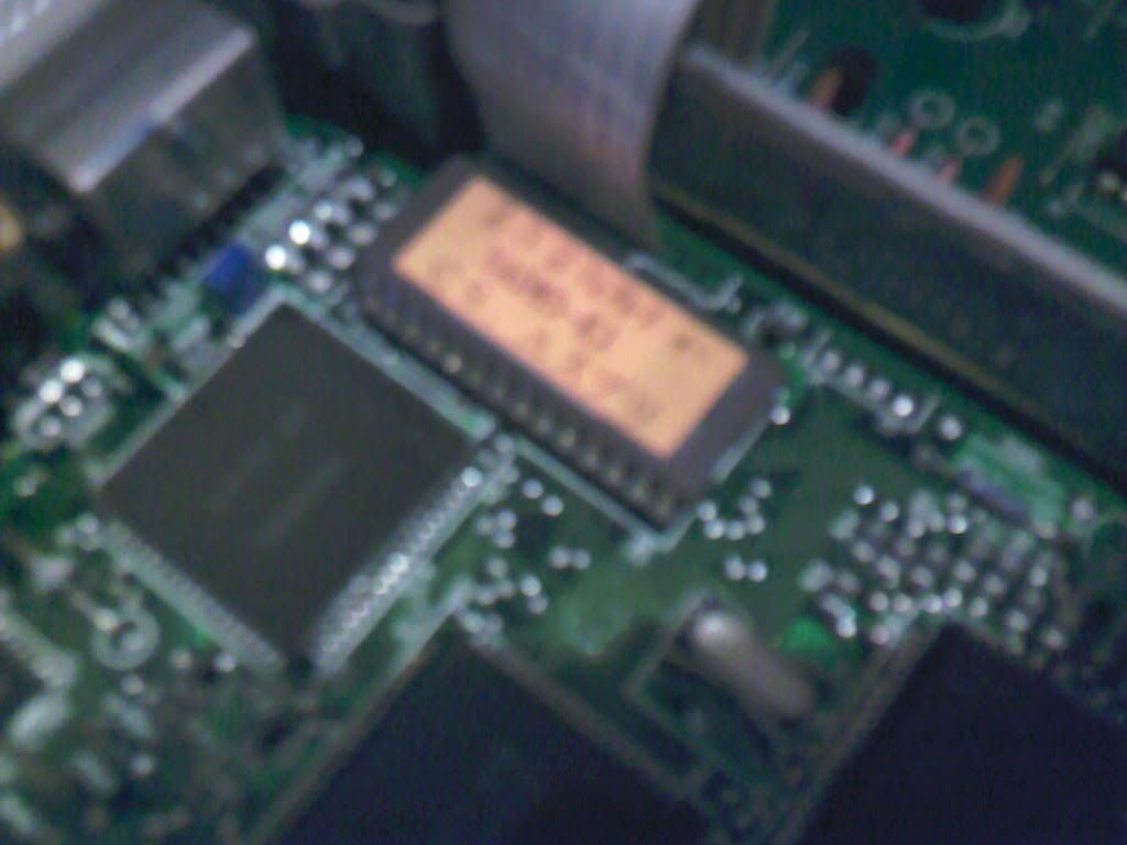

yet another chipped question. Basically JDM TT ecu is it chipped or not?
not great quality as i just used a camera phone, dont gt anything better:rofl:

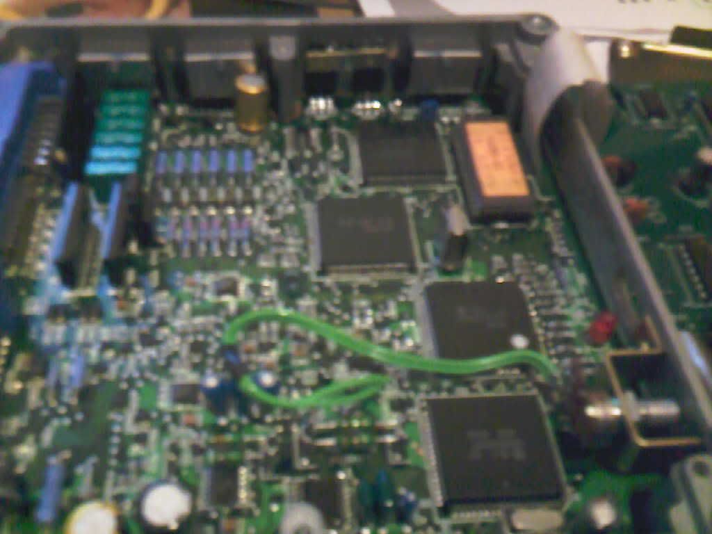

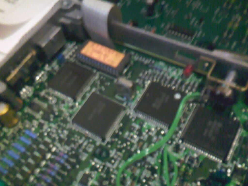

Can't really tell from the pic. You need to check if it's socketed. Looks like it might be.
The label alone suggests it is a replacement eprom ( chipped ) and typically when done in Japan they have soldered it direct to the board as the original Nissan one was and not in a socket, a quick check on a ConZult ( ecu plugged into car ) would determine what the mapping is.
Jeff TT
cheers. found it in the shed couple of months ago along with a F-CON V and both plenums. asked my bro about it and he said it was set for intake, exhaust and 740cc injectors along with some other stuff probably, well that what he thinks.
