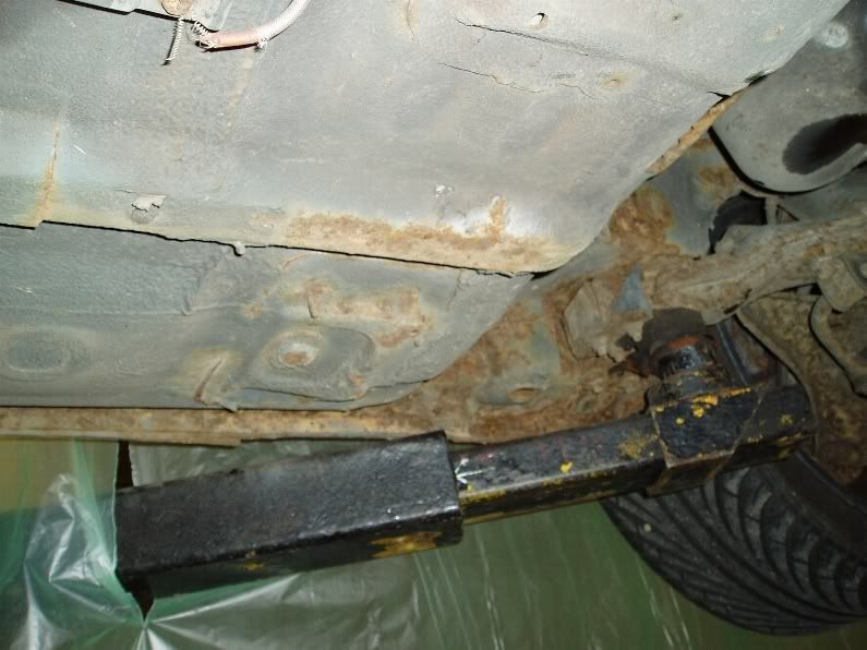

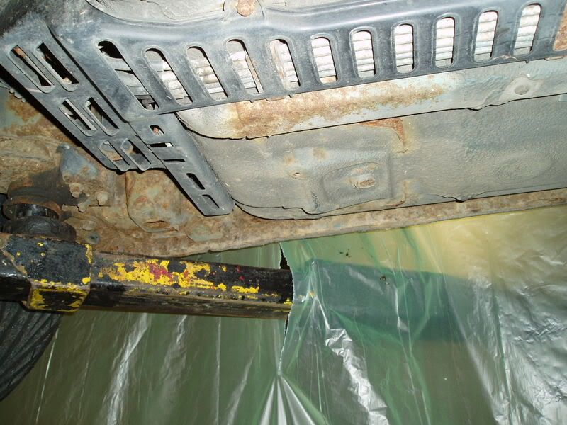

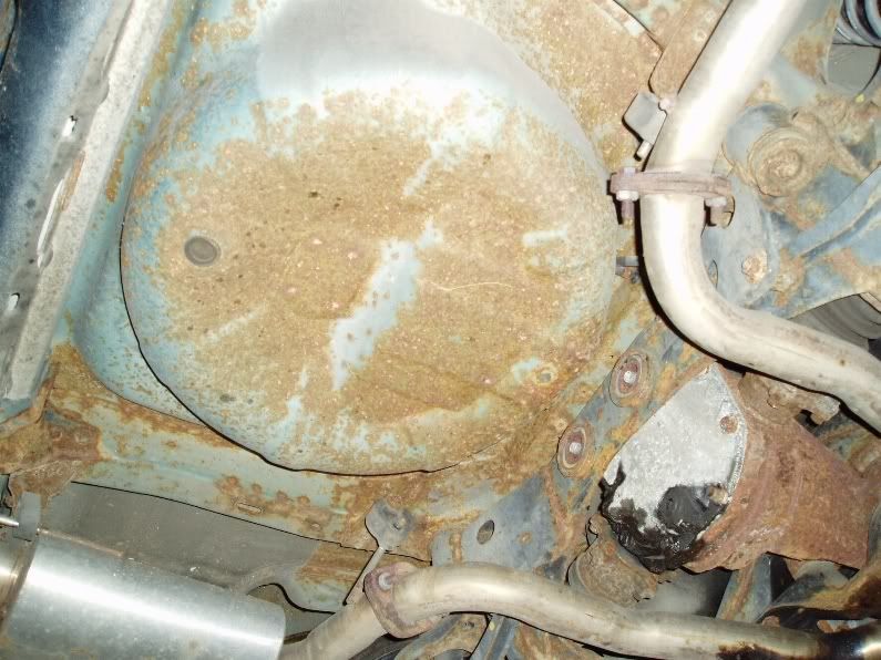

Well have loads of them, try this guess the year of this zed based on its condition
Jeff TT.
Thats not a uk car as i couldnt see any hicas.Its n/a & jap so i will make a wild stab in the dark and say a 91?
Genuine N.Reg :shock::shock:

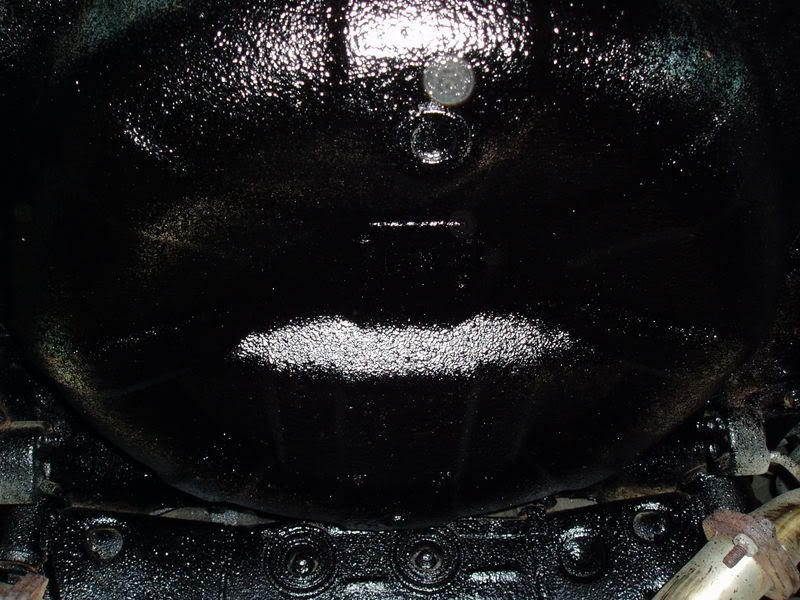

Later after much cleaning and coating it looked like this:

Nice one bud! Bet that took along time!
youve plastered it in under sealant hmmm nice, bet theres loads of dust stuck to it now lol
Will it still not rust under the sealant?
Most of the rust was removed with a wizzy brush in the air drill what could not be removed was neutraised then the whole underside zinc coated before high pressure final coating which looks like underseal but is an ever fluid gel that skin drys but stays tacky underneth the skin, this way it can self heal small impact damage such as stones etc.
Yes it flipping did.......2 days!
Jeff TT

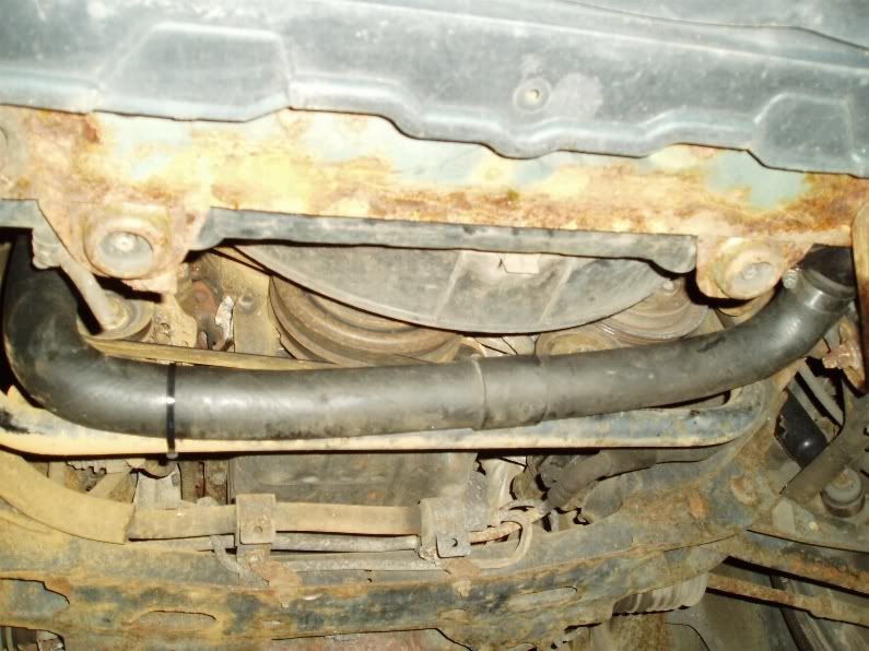

One area that gets overlooked is the front member under the radiator, especially if the undertrays are still in place as it hides it, worth a look on a nice day.
Jeff TT
Yes absolutely, the above car was an exception given its age and so went over the top to ensure its does not return, if your keeping on top of the small areas thats just fine.
Jeff TT
Yep i alreayd cleaned that up and gave it a nice coat :D wasnt bad anyway.
