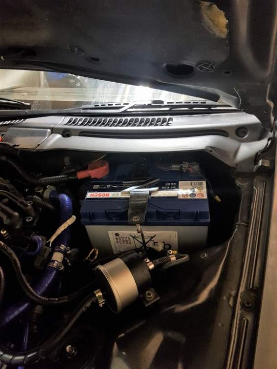

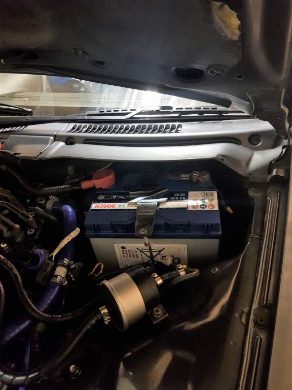

  22. Replaced the battery for a nice new Bosch S4 068 battery
