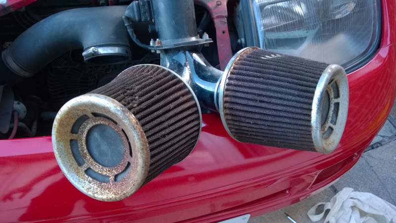

  1. Morning all.... I had a look at the MAF and the air filters. The Air filter has defo seen better days! Its non standard and looks pretty old.... Does anyone / Can anyone sell me the parts I will need to convert it back to standard? (Air box etc)

  6. I'll give that a go actually.... I also get the problem after I have washed the car so that kind of makes sense (the hose pipe squirting water throught the front grill) Mine has an aftermarket cover over this and it has the 2 vents... I know that the standard doesn't (do you think that is the reason?)

  8. Hi gary, again, not sure... I'll take a look when I get home later. I think it is the standard air filter though. That's brill Tom, its great to be a part of the club. Like I said I love this car...... just doing my head in as I feel like it has its own mind! One day it'll be perfect, others a nightmare... I only find out what mood its in when I start it. If the Power button flashes when I start it up its in a bad mood... if it doesn't then it'll be perfect :confused1:
