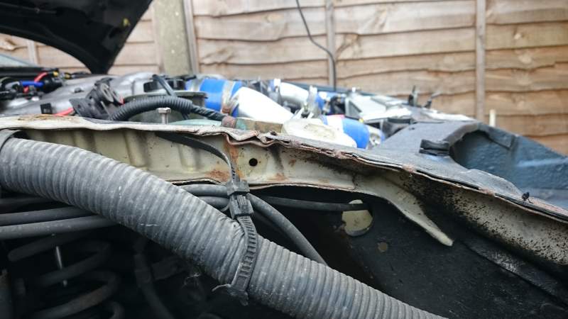

  11. Right screw it I'm going to do the work. I saw a blue 300zx go past with the targas out today whilst I was sat in the gt4 at buck barn traffic lights. Going to do all the rust, underseal and rust proof all of it then get it on the ramp just before it has its MOT as I know someone that would let me use it for a few hours. Going to reinforce the whole chassis so it'll be stronger than when it came out the factory.

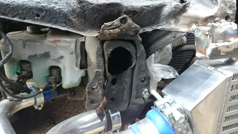

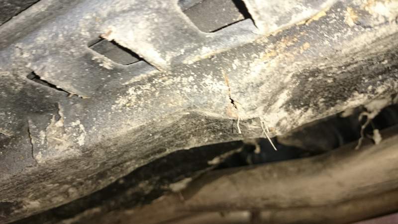

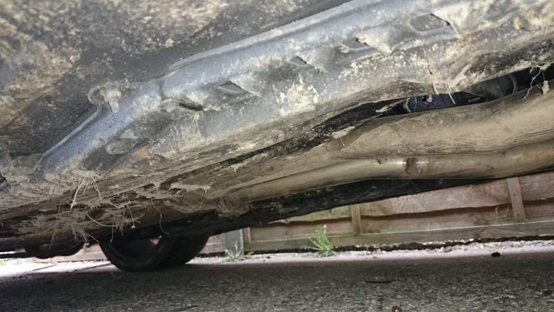

  14. Had my dad have a real good look over it take some measurements etc, looks like it is quite bent not 100% sure we'd be able to straighten it to the point where id feel safe driving it. I think me bottoming it out has revealed how badly it's been crunched before, chassis cracks, bent floor plan etc and without access to a ramp/pit is going to make repairing it interesting to say the least. Gonna have to have a bit of a think about this one...

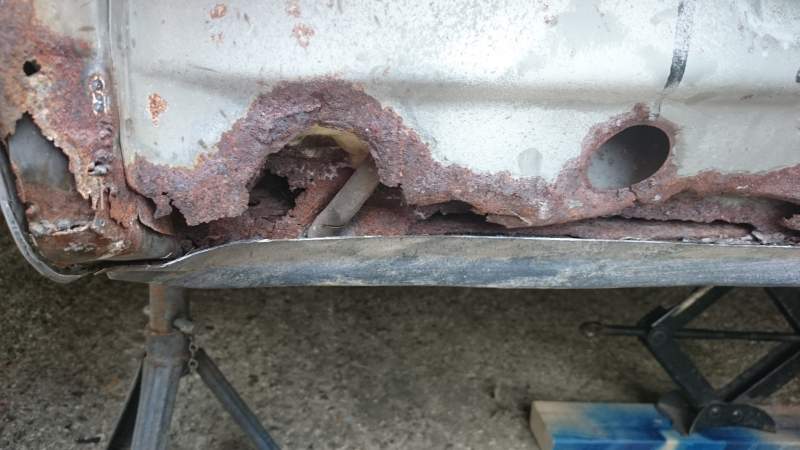

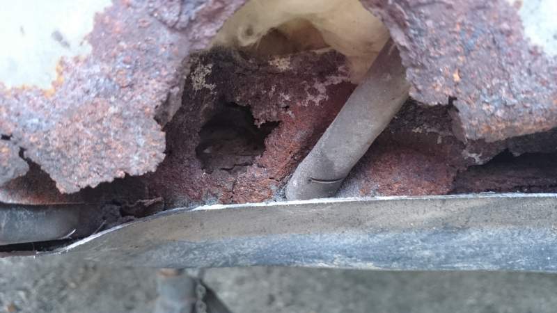

  15. Holy rust batman I've a bit of a lemon here... The 'repair' work that's been done is shockingly bad, rust inside all the inner sills and floor is dented. Anyone hungry for parts... No not yet!

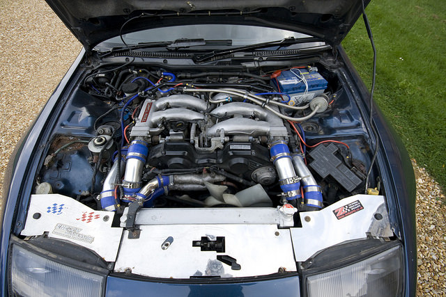

  16. At least when I'm finished I'll know she's all straight and rust free, should have a decent example then.

  20. Ok so it's actually a little more sinister than it first appeared. I knew it has had a front end collision when I took the bumper off as the crash bar is missing and where it would mount is all bent. However looking under the car the chassis is also bent with a crack in it so that also needs repairing, it has had shitty repair work done all round which I need to spend some time sorting out.

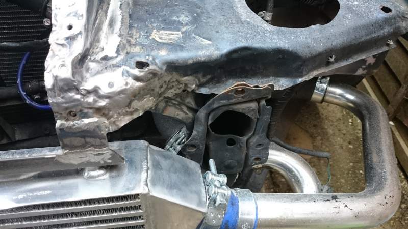

  21. Oh the joys of a UK spec zed. More Welding to do then!
  22. Bloody good job you did too! My dad has been in body repair for years, the welding that's been done on my car so far is shit to say the least. I have the sill to do as well and a bit on the boot, the whole boot has had a crap respray and is bubbling.
