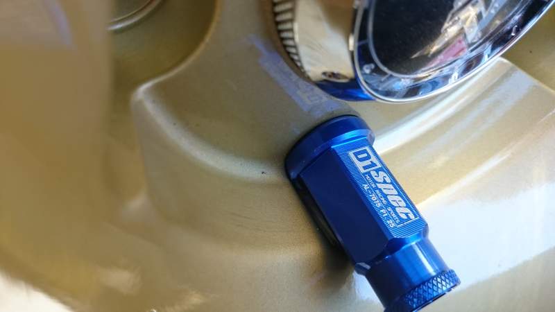

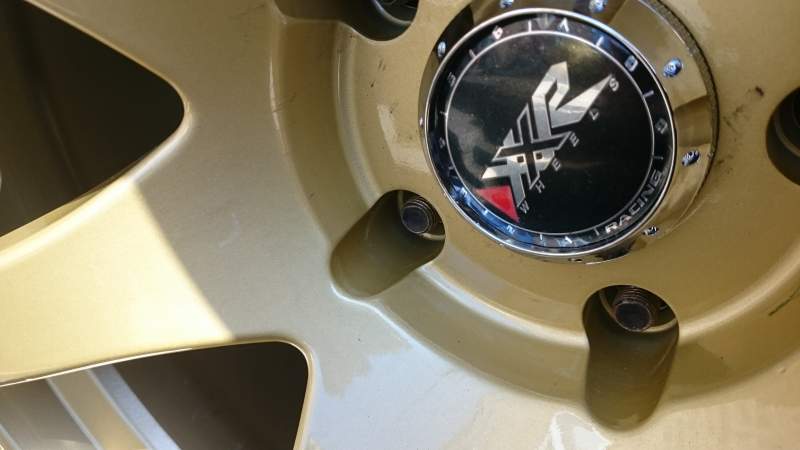

  24. Ok I bought some XXR 522 alloys for the zed, 18" 114.3 et28 9.5j all good right? Well my nuts don't fit... My originals were too small and I couldn't get a socket on the nut so I bought some D1 tuner nuts,they don't even fit in the wheel nut recess as they're too wide. What can I do to make these fit or can I not?
