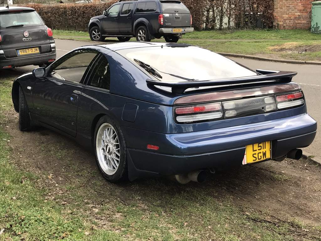

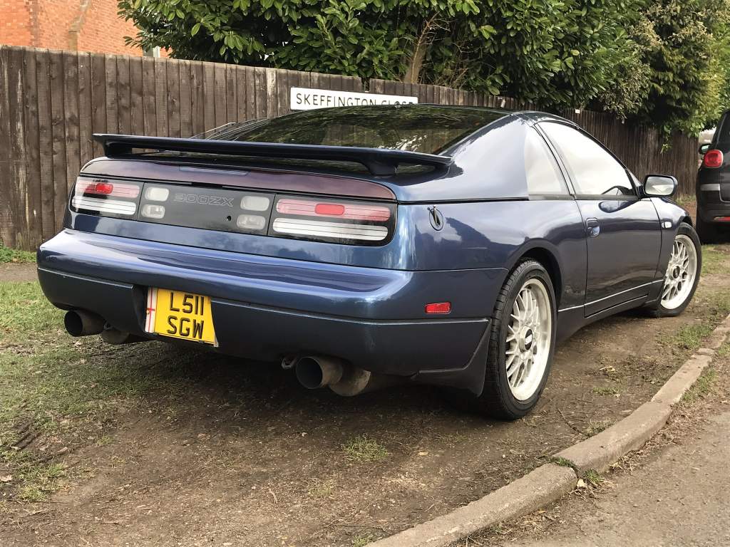

  7. Unfortunately I need to sell my Zed as I have a new business and need a van. Pretty much standard except for: BBS Wheels 99 Style rear lights (made by Bird) Steering wheel redone in leather by Mondo Phillips CMD310 stereo that allow an iPhone to dock / charge Refurb turbos were fitted last year and a know good auto box fitted this week both by PowerZed Looking for £4,000
