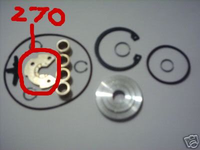

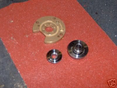

I would be looking at reworking my stock turbo's too, what is the difference with 360 bearings (sorry silly question but new to turbo's)..
360 bearing is just a collar which holds the bearing all the way around (360degress) instead of the 270degress you get with the stock internals. Just helps with wear.
360 bearings dont help with spool up. As Jimmy says its just a reliablity improvement.
