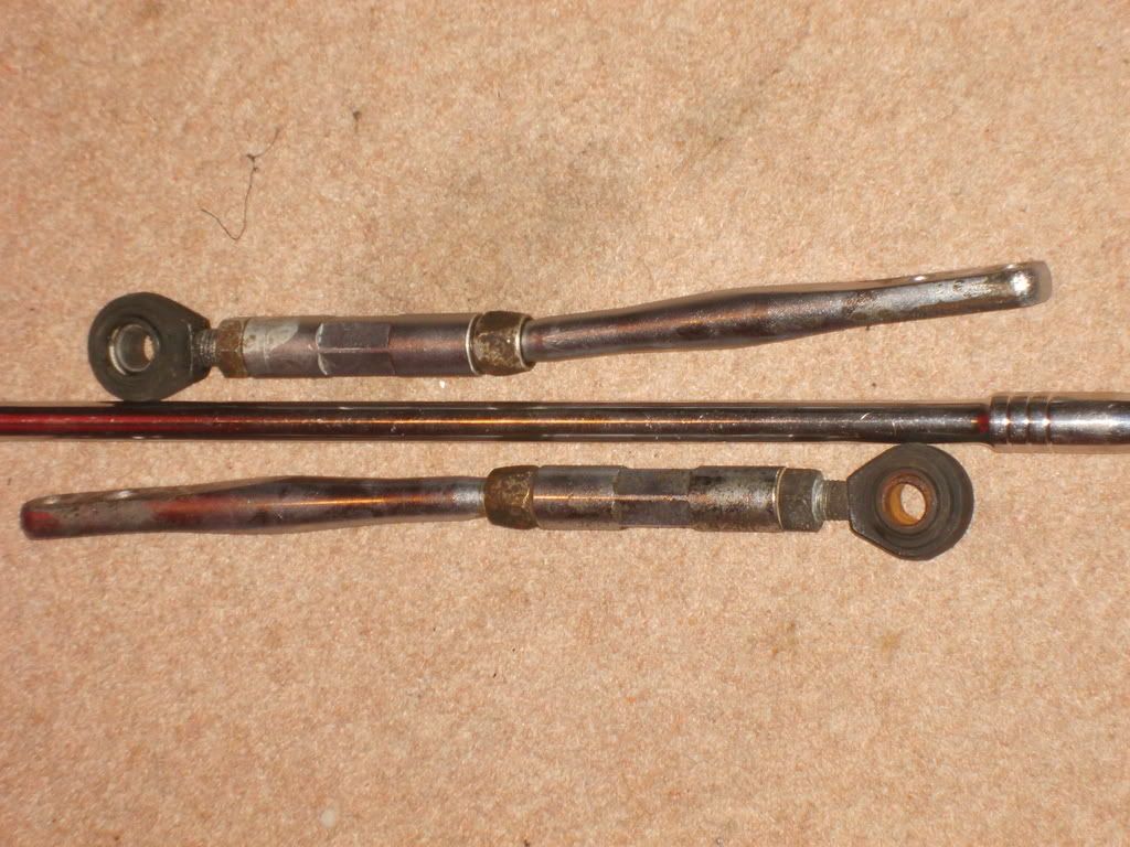

mine are powertrix and ive had no issues with them. never the less those have most certainly seen better days. Just trying to find a reason why they would bend like that. You havent had take of over a speedbump have you,lol. Cant see the thrust washer in the pic are they there???
