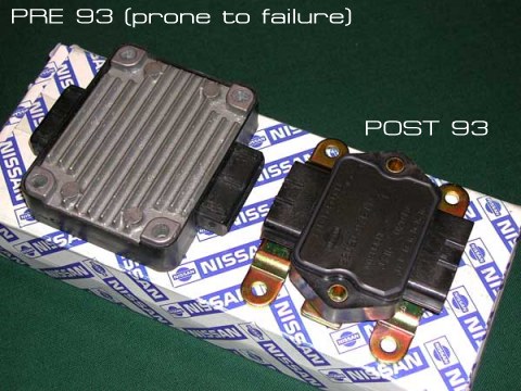

Is it the PTU (Power Transister Unit) you mean, that is basically an ignition timing unit and are prone to going. It is a little black box located on the left cam cover.
If so, easily sourced. I would try SWZ in the traders section for starters.

If its the ptu the series 2 are supposed to be non breakable

Yep, chances are it's the series 1 that's gone. It'll be in the same location (front left cam cover) but it's silver and about 3-4 inch square.
To be truthful the correct ptu comes off a series 4 car that is the upgraded one, I don't know where the series 2 blarney came from!

Actually the pic is slightly incorrect, the it is late 94 the ptus changed over, unless it was earlier in the states?
I think they're referring to second series of PTU, not in line with the model revisions.
True I think some people believe the PTUs are upgraded on series II cars, when it is the 2nd series of PTU that is fault free :)

Yeh, Ignition Ampflier is PTU. All 89-93 came with a series 1 PTU. 94 onwards came with Series 2 PTU.
Both will work, but the Series 2 is much more reliable.
Can pick up a used Series 1 PTU for about £30. A series 2 PTU will cost you around £120 I believe.
SWZ will have at least a dozen or so Used tested PTU's on the shelf. If you want a New Series 2 PTU then best people to speak to would be DTA or MJP. (Contact details are all in the forum traders section)

The ptu has a fault inside it, it saves the potential drama of sods law, i.e. it will break on the M1 in hurricane style weather, plus also having an inferior spark on a turbo engine is not good :(
Its a reliablity upgrade. The S1 PTU's are flawed, In the U.S the Nissan dealers did a recall of the S1 PTU's and replaced them with S2, but unfortuantly UK and Japan did'nt.
