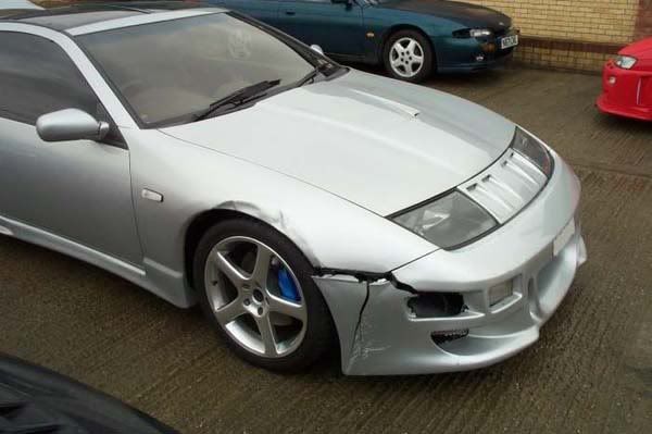

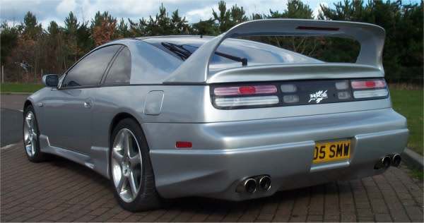

I'm not sure what possessed me at the time but I decided to go for a UK rear bumper with a lip. Sprayed and delivered by PPS.
P1001598.jpg?t=1221335222

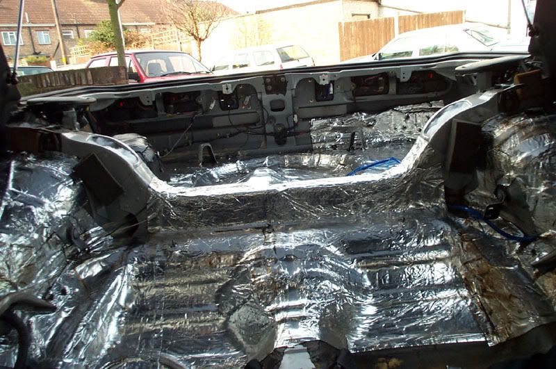

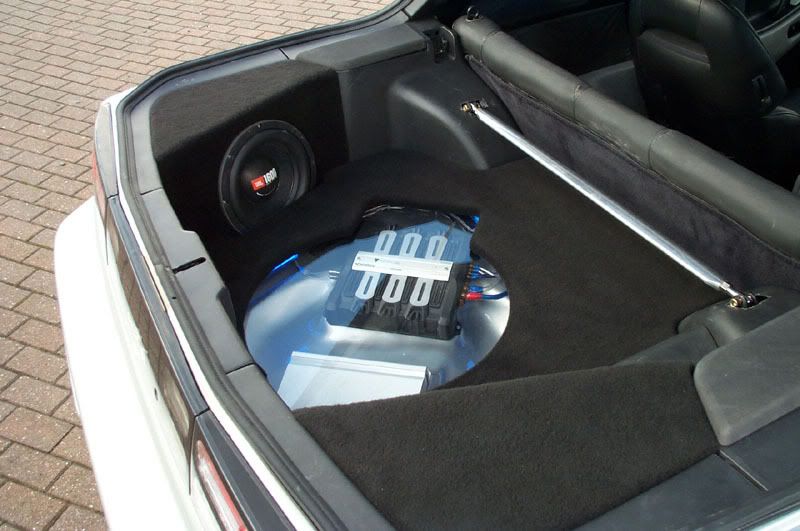

I wanted to get rid of the road noise inside the car so I sound proffed everything.
before
ICE1_small.jpg?t=1221398424
during
ICE4_small.jpg?t=1221398280
ICE3_small.jpg?t=1221398259

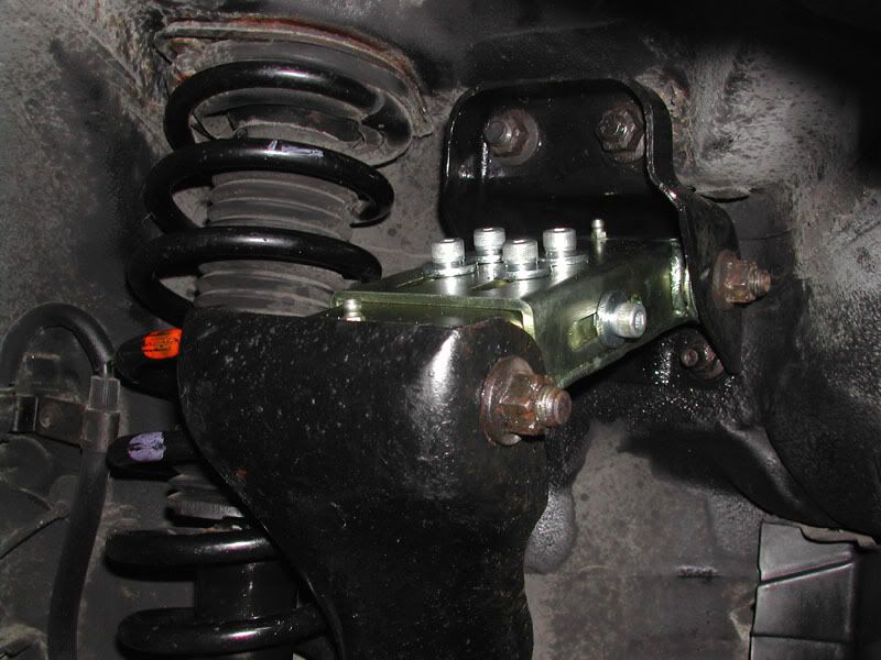

I then added a front and rear strut bar.
strut009.jpg?t=1221335692

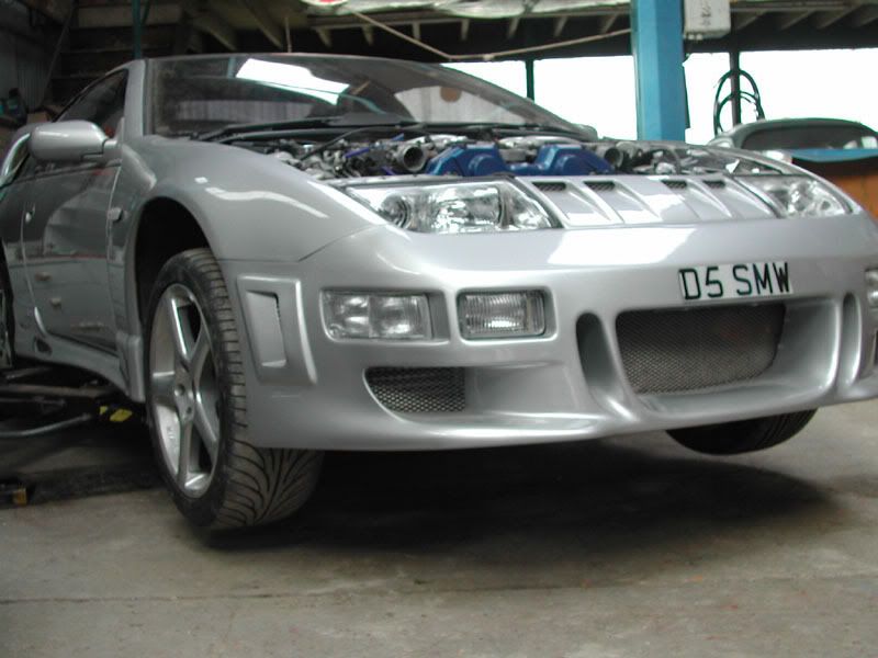

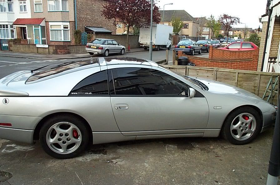

June 2003 was the time I changed the look of the car. Booked myself in at PPS in Newcastle (300 miles away), didn't trust anyone else. At this stage I kept the rear bumper but deline and smooth it. I replaced the front with a stillen. I added a bonnet bulge and a high level rear spoiler along with Wings west skirts and delined doors. I also swap out the rear lights for 99 specs.
SMW1PPS7.jpg?t=1221335526
SMW1PPS9.jpg?t=1221335544
Had to get rid of the stock wheels and came into some R34GTR calipers as well, so new discs and pads to go on with the new wheels.

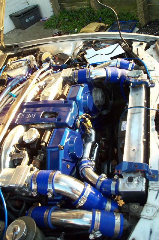

For the next big mod I got James(jaffa) to give me a hand. We upgraded the stock IC's with Greddy's, the rad with a Howe, Viscous fan with an electric, Underdrive pulley with a lightweight, stripped out loads of stuff I didn't need like AIV's etc. Painted the cam covers, changed the belts, added hard pipe boost hoses and rad hoses.
Some comparrison shot's...
Greddy IC's
mods007_small.jpg?t=1221397615
Oil cooler
mods009_small.jpg?t=1221397669

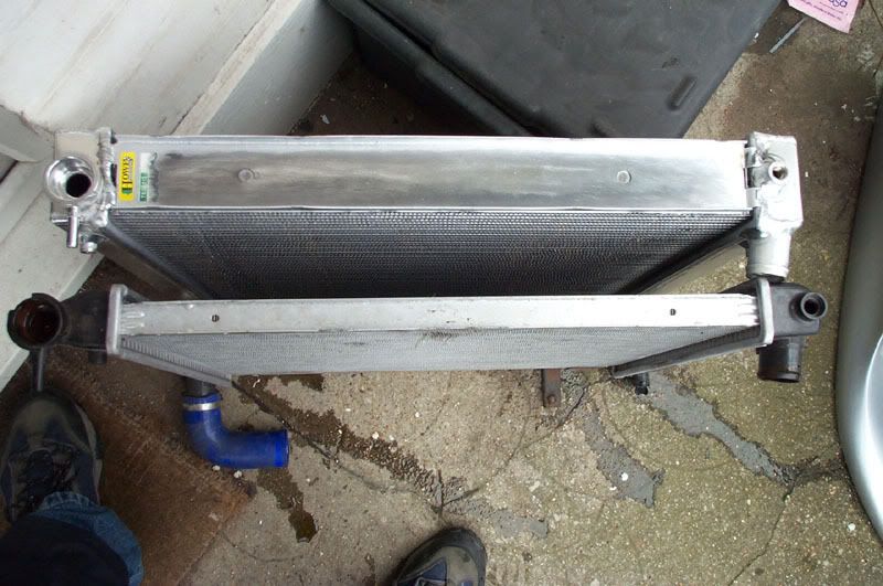

Howe Rad
mods017_small.jpg?t=1221397693

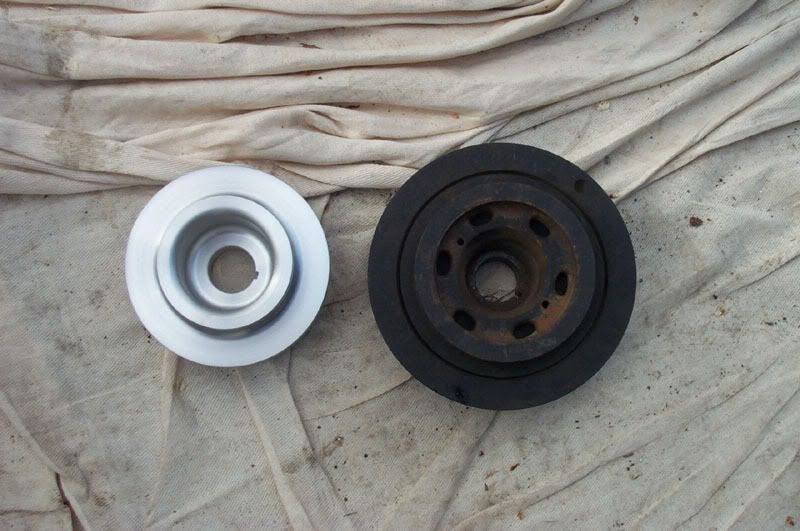

Underdrive pulley
mods021_small.jpg?t=1221397744
New electric fan
mods033_small.jpg?t=1221397829

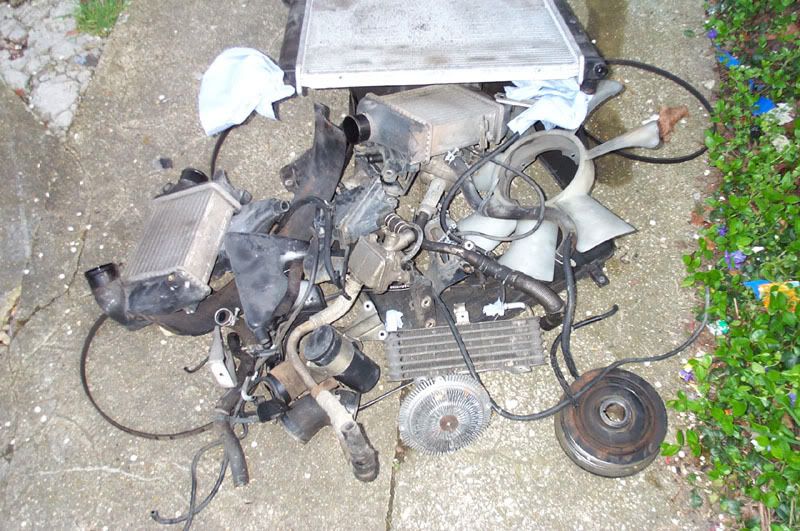

This is the pile of old parts and parts no longer needed tat we were left with.
mods030_small.jpg?t=1221397783
This is what the car looked like once we were done
mods038_small.jpg?t=1221397844
mods039_small.jpg?t=1221397870

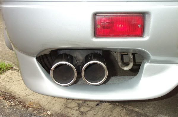

Next up was a replacement exhaust, I originally had a rusty greddy, but decided to get a powerflow made and fitted with decat test pipes.
Zorst1.jpg?t=1221421528
This exhaust lasted 2 months before I got bored with the sound of it. I decided to have a custom exhaust by an american company called pipecraft.

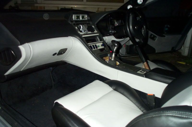

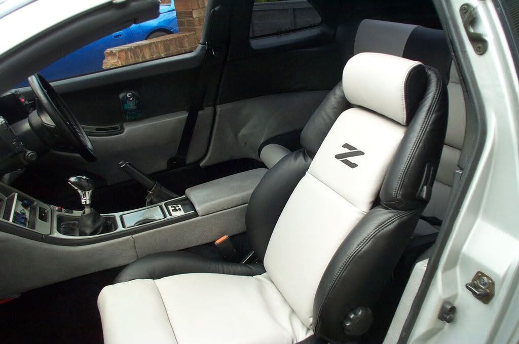

We are now well into 2004 and wih Billing just around the corner I had to get the interior finsihed.

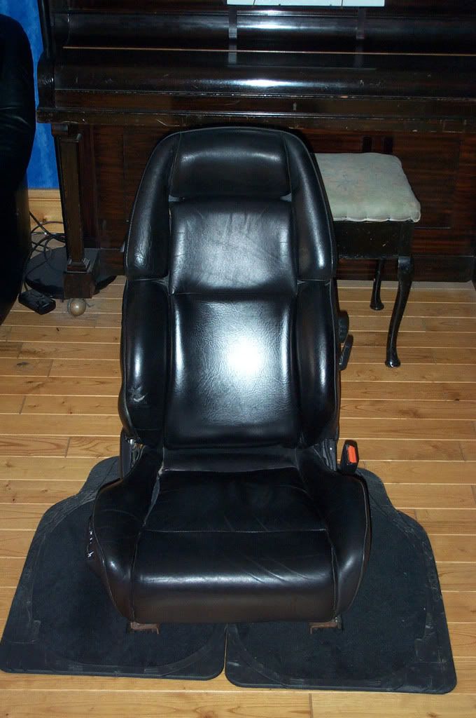

I ordered a katzkins set in dove grey and black with logo's stiched on the seats. Took me a while to fit this. I also ordered an extra hide of dove grey so I could trim the boot area.
before
seats001.jpg?t=1221398682
after
seats022.jpg?t=1221398729
seats035.jpg?t=1221422142
P1002936.jpg?t=1221422198
Still had to get the gear shift and handbrake gators done. But managed in time for Billing 04.

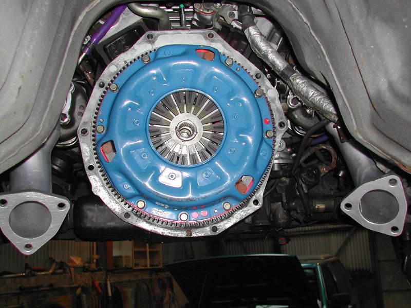

Unfortunately on the way back from billing. there was a little smoke, then a rattle, then no boost past 0. Yup the dreaded turbo's had gone.
I decided as I was driving home, I would go straight to my parent house and leave the car there (35 miles from my house).

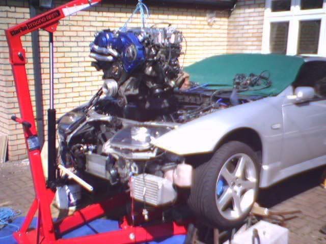

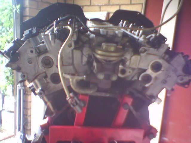

I was now confident to swap them out myself. So a week later, I started work with a some help from Mark Hanley, MTL and mike Groves.
Engine out..
IMAGE_00024.jpg?t=1221422515
Started stripping..
IMAGE_00029.jpg?t=1221422575
IMAGE_00043.jpg?t=1221422592

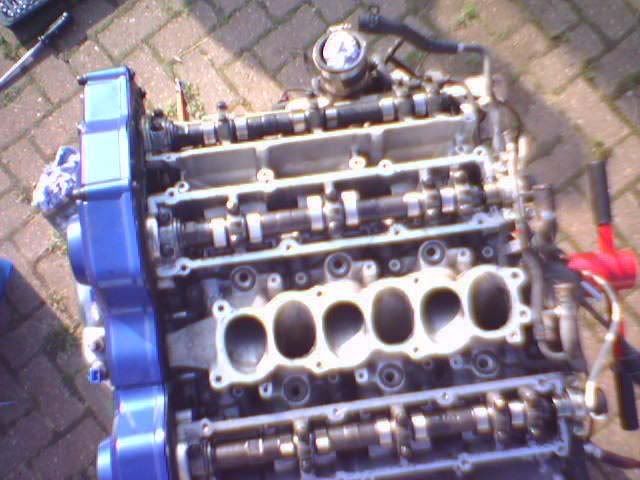

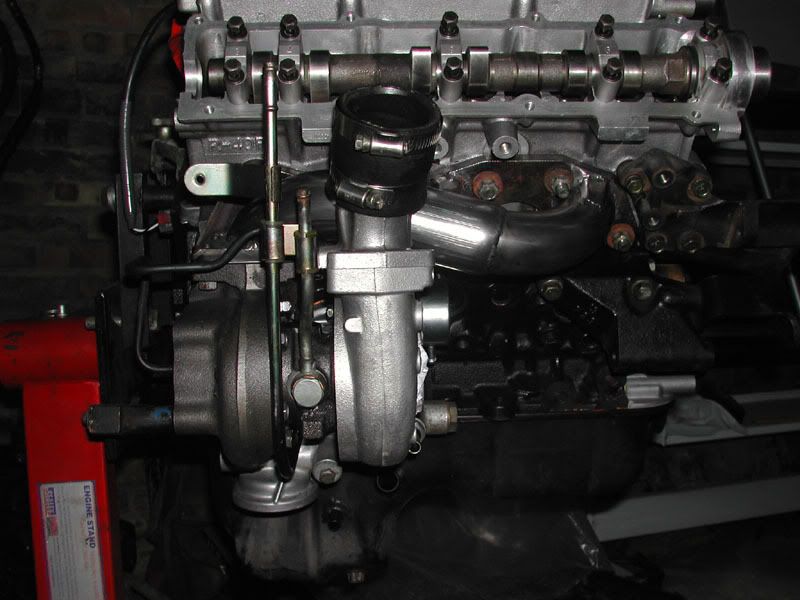

I stripped it all down to the bare block to check for bore scratch as the passenger turbo wheel had grinded with the housing.

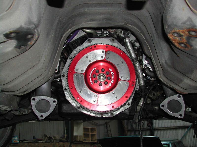

It was at this stage I decided to upgrade a few more bits. Weisco pistons, jwt530bb turbo's, nismo 555 injectors, rps max street clutch, billet flywheel, carbon single piece prop shaft, gred dupree manifolds, greg dupree downpipes and flexi pipes and much more.
I sourced all the parts along with another lot of 60k service items, new water pump, new gaskets, egr blanking kit, plus every thing else I needed for a rebuild, even a set of chromed headlights and clear rear side reflectors. If you are still reading this thread, I'm impressed, prove it and reply with the word stuffybum in you reply.
I used CMS is dagenham to bore the block for the new pistons and at the same time balance the crank, underdrive pulley and clutch/flywheel.
Driving 35 miles each weekend was getting painful, at the time a new garage called Zen opened up. I decided to get a guy called Martyn to finish the job.
Very long story short, it took him 3 year to get the job done, it nearly went to court.
Some pics from the engine build.
RPS Max Street/GD Downpipes
800.jpg?t=1221424958
in it's case
h2.jpg?t=1221425192

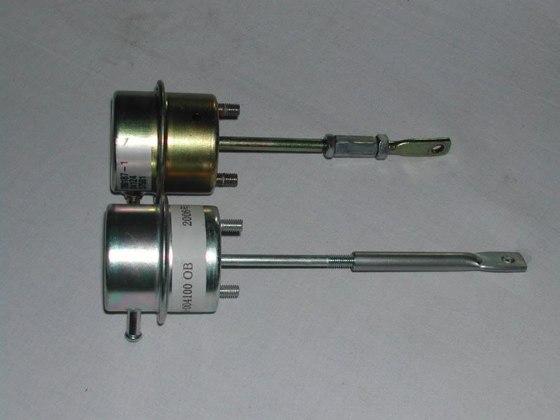

JWT 530bb's with HKS actuators and GD manifolds
a12.jpg?t=1221425002
HKS v Stock
a3.jpg?t=1221425069

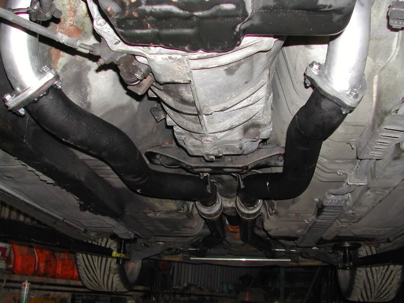

GD Downpipes and flexi pipes
i6.jpg?t=1221425225

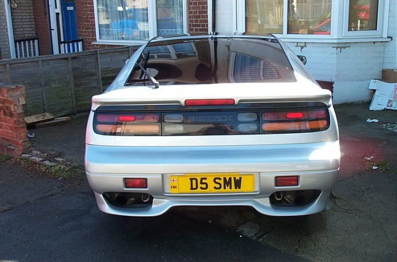

PPS Customised Rear Bumper

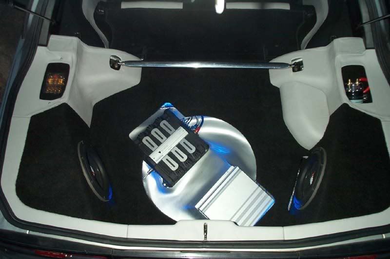

Custom Boot Build with Leather Trim
