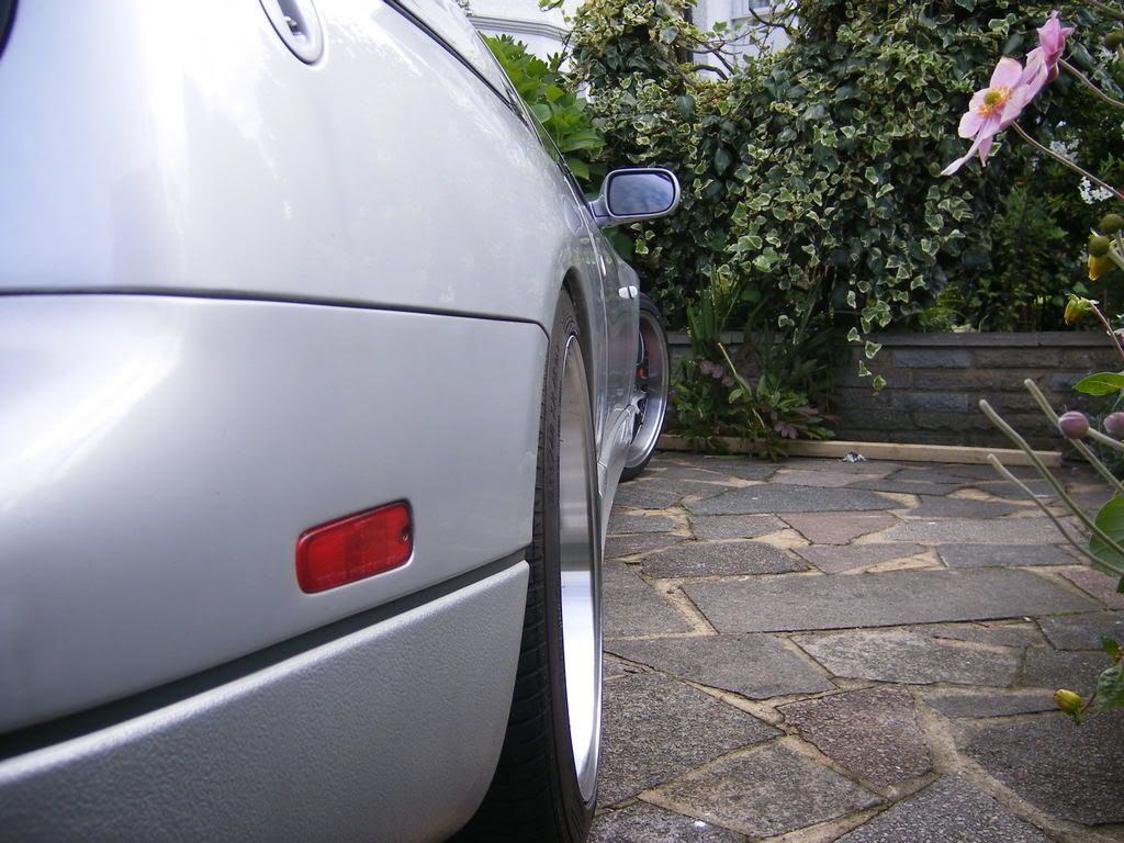

Offset will also have a big part in whether your tyres will rub. I'd rather fit a 285 to the rear of mine as I prefer the flat tyre wall look over the stretched look. Gives it a more aggressive and purposeful look.
Unfortunately, I think my rears might be to positive on the offset to except a 285 tyre, so will stick with the 265 for the time being. My fronts could easily accept a 245. They are currently a 235, on an 8.5" wheel with a +25 offset. Almost on the limit there without having to roll the arches, but still some space to play with.

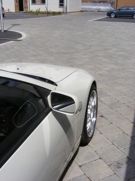

Before @ +45, 245 would not have rubbed....see the horrible amount of ugly wheel gap. LOADS of room to fit very wide tyres. But, I hate wheel gap. So, that had to be the first thing to go!

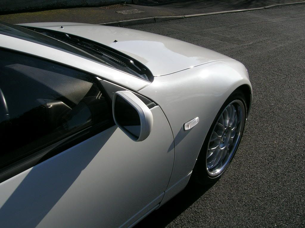

Now with +25 offset and camber correction. It has a higher likelihood of rubbing, but still some scope for a slightly wider tyre.
If one was to go up a width AND a profile, then you have a higher chance of rubbing than you are with just a marginally wider tyre.
....it also depends on what suspension setup your car is running. Whilst stock suspension will be more forgiving, if I was on coilovers and lowering more than I am now, I may find rubbing issues.
