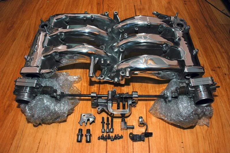

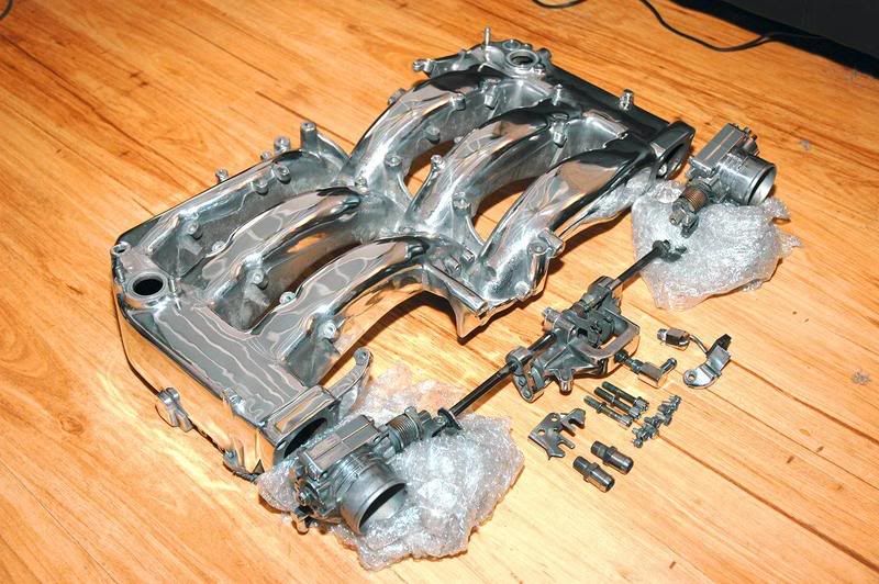

In the finest Blue Peter tradition, "here's one I made earlier"
(I hardly ever did the TB's and linkage. The above was a one off ;))
That Leigh is a very impressive bit of polishing !
Ta very much Dave! :D :)
Think that one was the one John saw me working on when he was over and I kept threatening to sully his, then VG30DETT'ed Z32, with some...gasp...bling!
I'm still glad he didn't hit me...lol!
:D ;)
Did you use any power tools on that or is it all done by hand, it took me long enough to get a bit of a shine on the cas, how many hours did you put into the plenum.
Jesus, I wouldn't like to do one entirely by hand! ;)
As far as how many hours...I honestly don't know. A lot! lol. I did it in my spare time over the course of a couple of weeks, putting in about an hour a day, more at the weekends.
