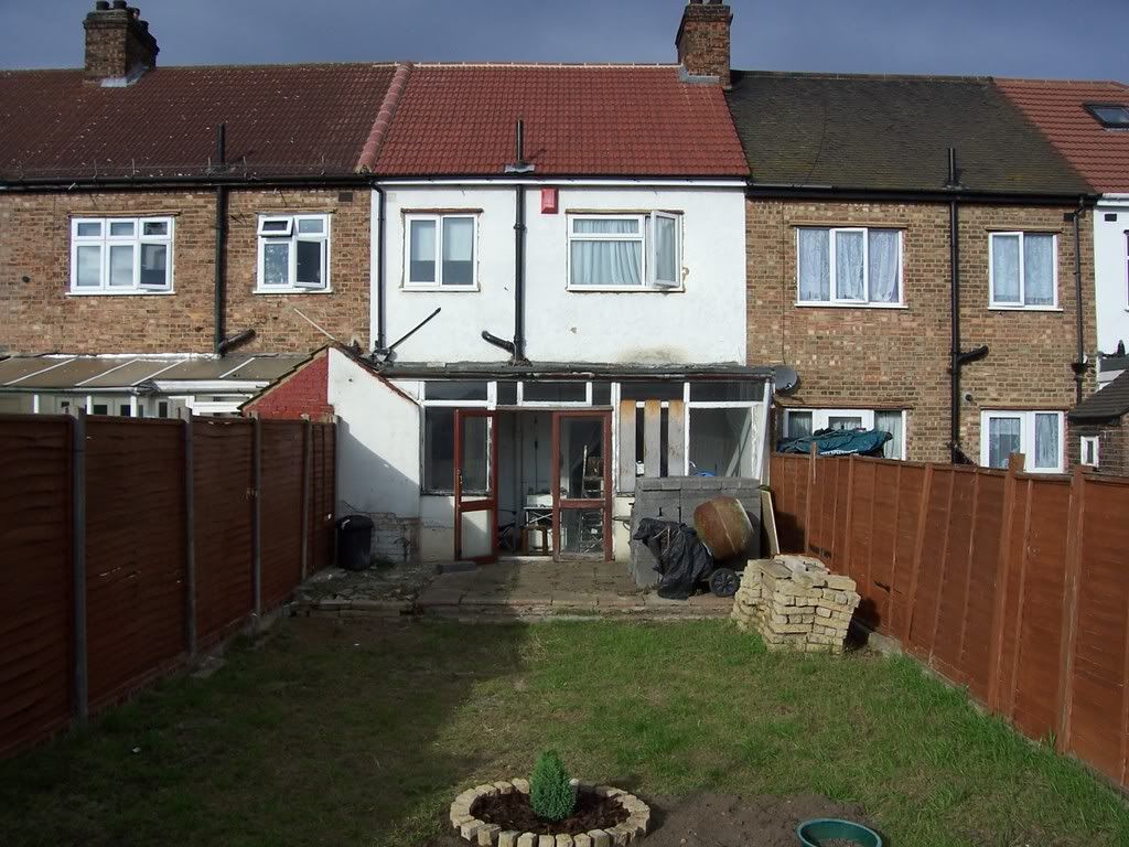

before it all started...

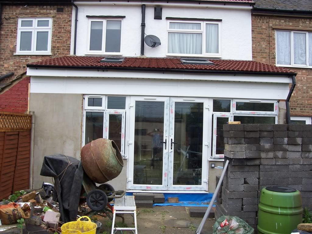

extension replaced...
b.jpg?t=1218965357

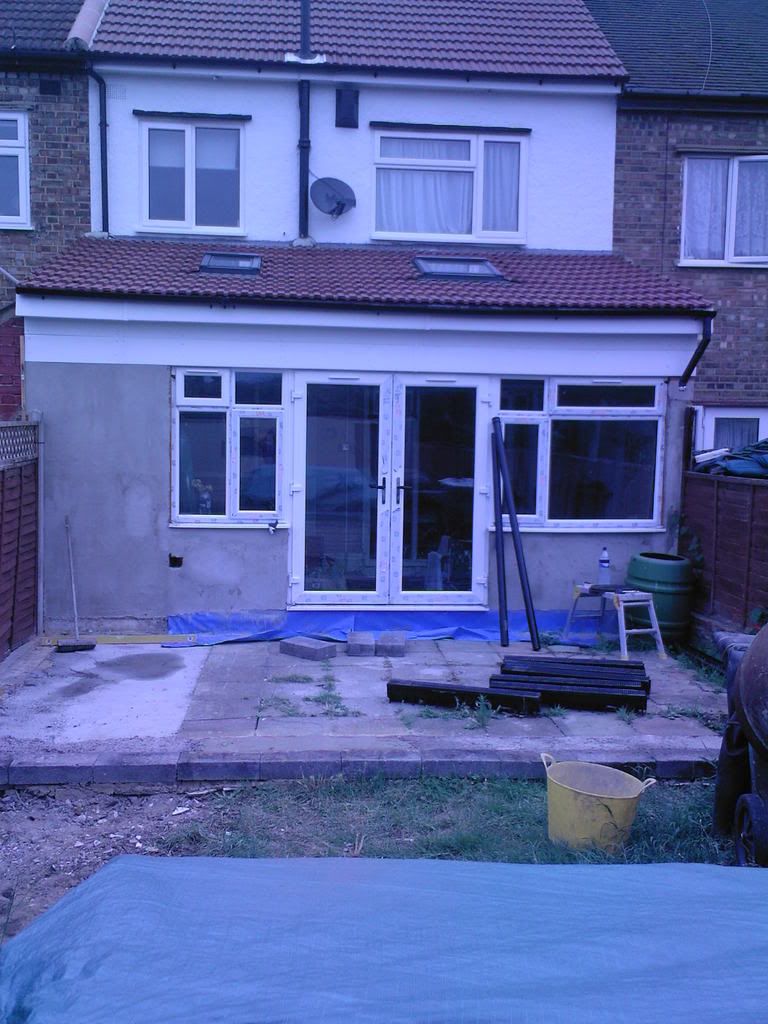

patio concreted and leveled...
c.jpg?t=1218965394

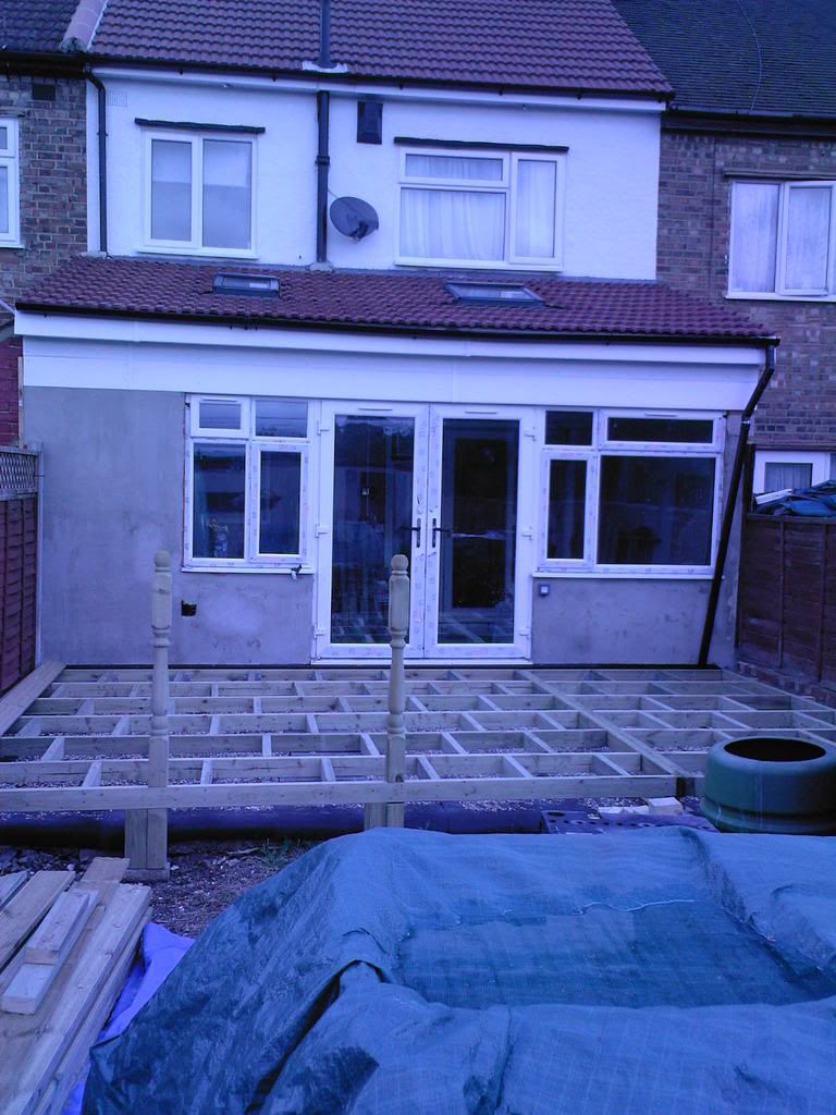

frame built and levelled...
e.jpg?t=1218965457

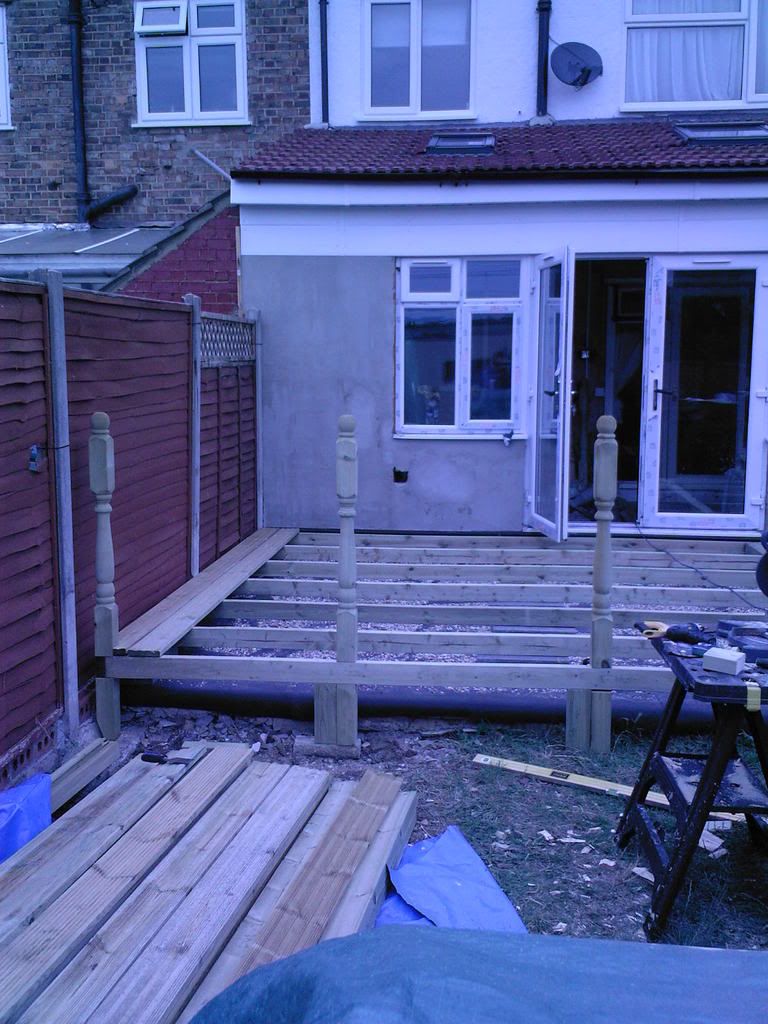

noggin's attached...
f.jpg?t=1218965489

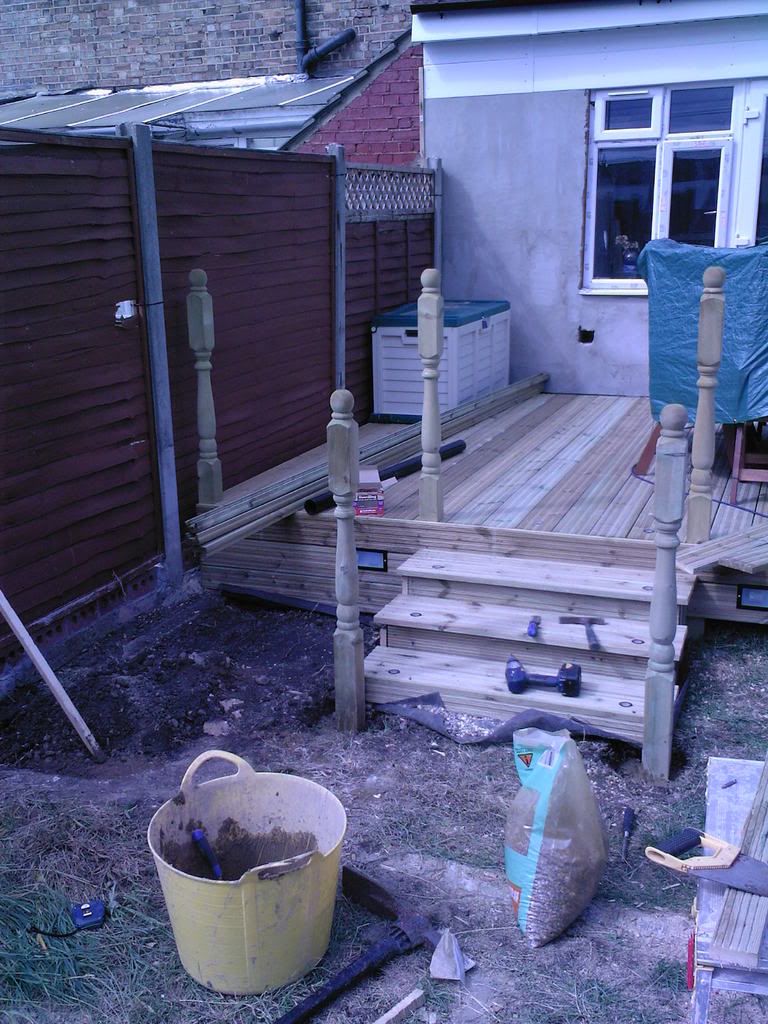

stairs started...
h.jpg?t=1218965544
stairs almost done...
i.jpg?t=1218965578

That's all I've done at the moment. So far it's taken me almost 30 hours labour to get this far. I started with 145 meters of 4"x2" in 3.6 meter lengths, so the time it took to measure and cut the noggin's used up a great deal of that 30 hours.

Finished one spindel / handrail on the left side of the stairs looking at the house. I need to do another three (one on the right and one either side of the stairs).
Hope to have it all finished by the time she gets back, however I'm not cutting any corners so if it's not finished then I guess it's not finished, we'll see.
