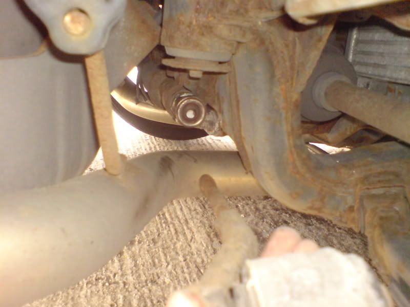

snapped hicas arm

will be ordering them 2mora and will hopefully have me grinder and hammer out on wed night
you wana get the wire brush out while your there and get rid of some of that rust ;)
try that new hammerite magnatised paint thingy, thats should work
Bloww some Waxoyl everywhere especially box sections but except brakes/exhaust- creeps into threaded surfaces and has rust killer/inhibitorsd- swear by it!
Get the black version and it looks absolutely fantastic as well!
One 5l tin at around £18 or so should do the car- use Sholtes gun & compressor- no need to clean off rust etc, just thick mud of course..
By the way- if you want another arm I have one you can have- just pay postage!
