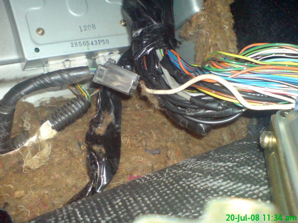

your ecu wiring looks as it should do.The looms do have tape around like that as there are splices of common live wires to all the sensors in the engine bay.Most of the sensors will have a red/black live which is shared.Test this at the o2 sensor in question.You should have an earth and a shielded wire which is in the middle iirc.If you connect a multimeter to the signal wire and rev the car to around 2500rpm the voltage should rise and fall rapidly.If you need the ecu pin numbers for the sensor drop me a pm.

Right, basically there was no reading from the passenger side O2, nothing at the sensor connector and nothing at the ECU pin (conzult had nothing so a multimeter was used at the connector and ECU pin). From what I understand, the ECU has been changed and still the same problem, nothing out of the ECU pin for the left O2.
