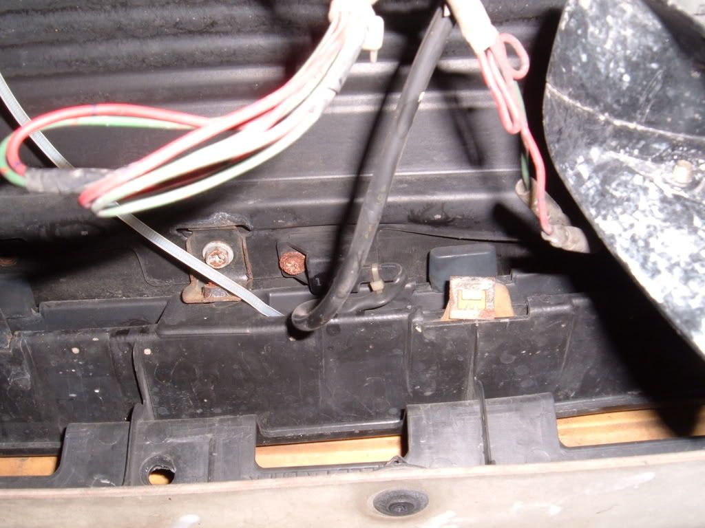

My temp reading on my air con is reading wrong. Its always in the 30's. I know there is suppose to be a small box behind the bumper that reads the oncoming air temp but i cant find fook all. It has happend since the recent engine change. It must be hiding somwhere. Has anyone a picture or reference of this mystical box;)

mines behind the bumper , just under the drivers headlamp, a bit to the center.
how big is it??
[sIGPIC][/sIGPIC]
cheers buddy, will look tonight.
