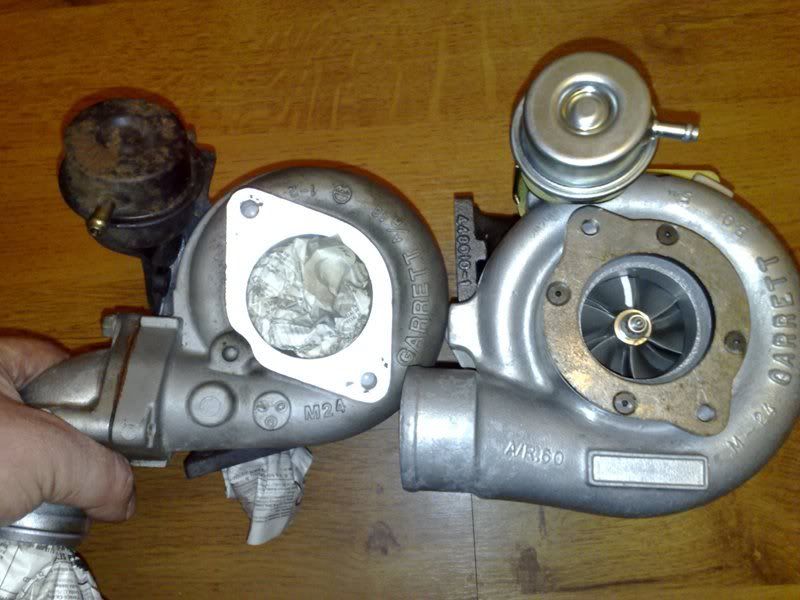

Was it the 600's or 700's that they call disco potatoe ?
JWT700, also known as the GT28RS or Z1 675 kit ;)
ah gt28rs makes sense. thats what i no them as off the 200sx.
why is there different names for the same turbo?:wack:
That will be the one on the right - the GT28RS or in my case Z1's version the GT675RS
