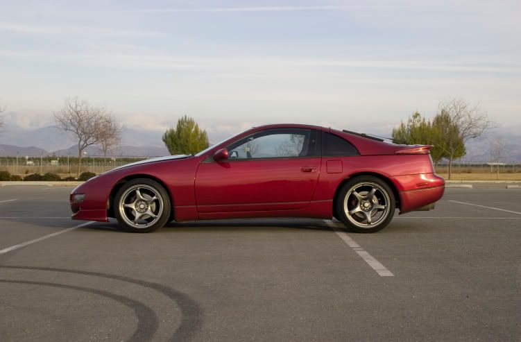

Wheels point more outwards? Not sure I follow? You mean like this? (see front wheels)
no i mean the toe is affected an the wheels point outwards like when you look at the car from the front not from the side.
toe-in cast-out ;)
