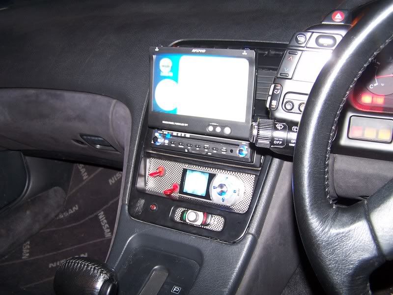

My car's been in safety mode since i bought it (un-known to me at the time) and i just spent the day fitting a blitz sbc-i colour boost controller. Took it for a very carefull test drive and :bow: :bow: ITS ****ING AMAZING!!!!!!!!!!!!!!!!!!!!!!!!!!!!!!!!!!!!!!!! I had the nose panel off and the targas off. Its a boost monster !!! the BOV's are bloody loud!!
Its like having a new car, you actually have a rush of acceleration on boost. Never had it at 7 psi and im only pushing it to 11 psi now!
All the money spent, repairs that have been done hours spent working on problems with it don't mean shit now!, i couldn't care less that its still high idling now and then and i may need a new diff............For now i'm happy :dance::dance: :D
