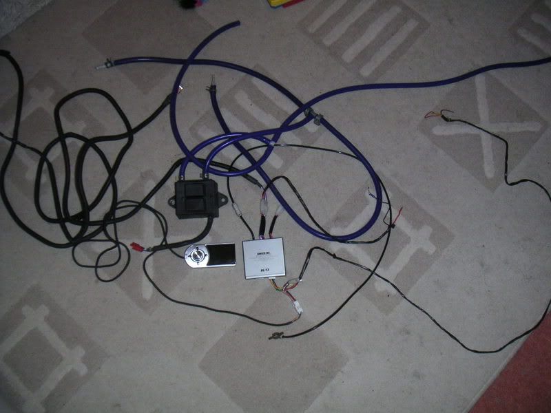

Just got a Blitz SBC I-Colour :dance:
And it looks rather complex, lol. I have a manual for it but was asking if anyone has fitted one and could give some pointers?
I'm guessing fitting the EBC's valve is fairly straight forward, i just plumb it into the existing system.
Where do i pick up the speed and RPM signals from to attach my wires to? ?
I also have an oil pressure sensor and water temp sensor, Both are metal and have a thread but don't want to be drilling and tapping my engine!! are there any places to fit them ??
This is the box of bits!!
