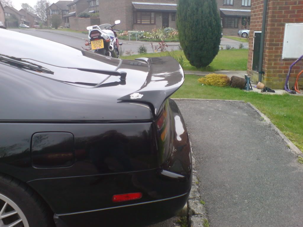

Ive come across a little problem. With the combination of being poorly fitted, someone nudging the spoiler in a carpark and lots of speed bumps, my high level bomex spoiler has managed to work itself loose.

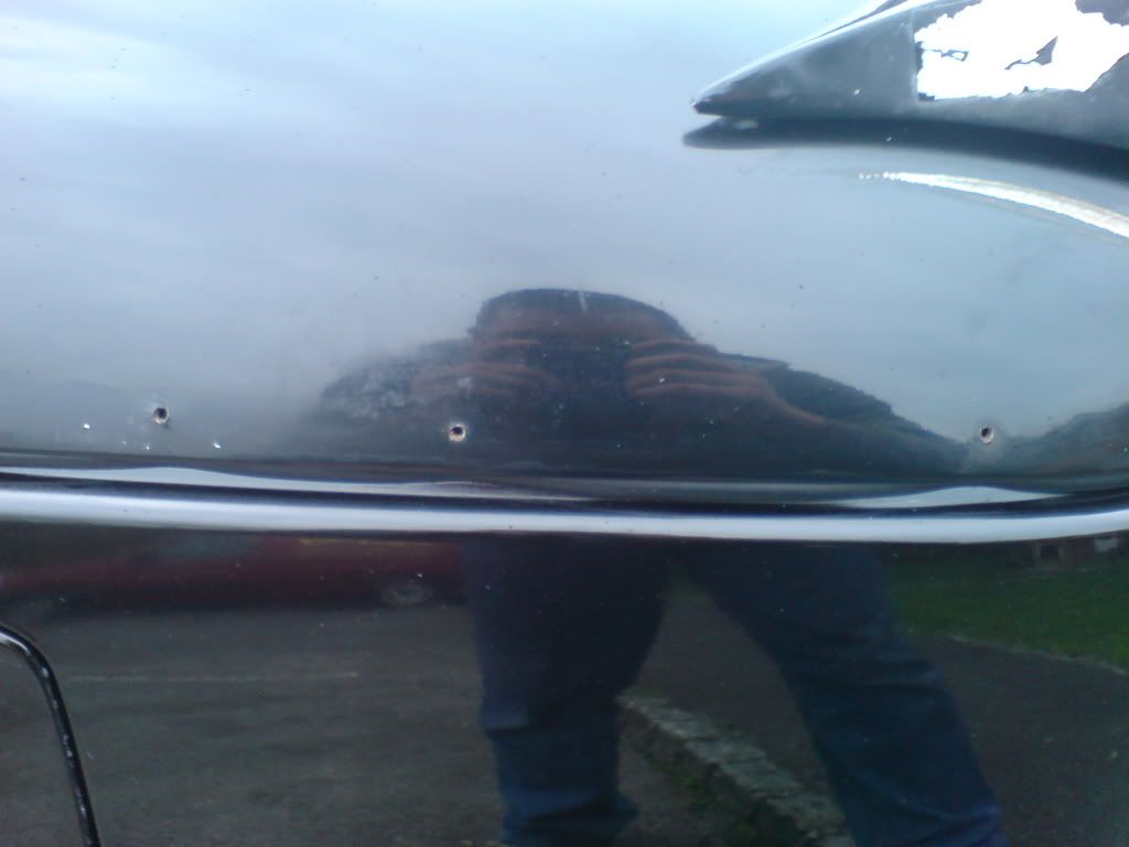

To be honest im pretty appauled to the standard it has been fitted, with a combination of self tapping screws and double sided tape, see below. It has always been 'loose' since buying the car and has always wobbled a little bit.

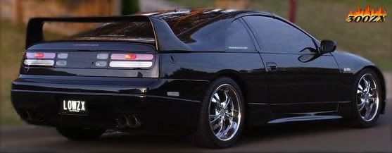

you look rather short in that pic nick. pmsl. mine is bonded on with something similar to that awful bloody stuff that the rear lights are held in with. plus 2 screws on each side on the inner lip of the boot.
