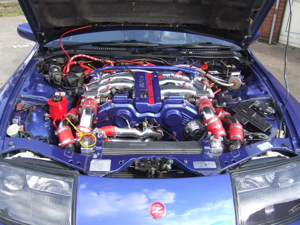

I am putting a higher preasure rad cap on my Koyo and don't like the look of the black plastic cap on the top left.
Can I replace it with an alunimiun one? If so, where can I get one?
