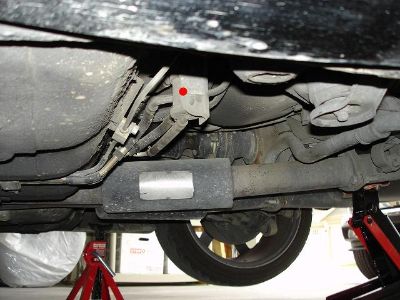

There's a roll-over valve in the vent line from the tank to the carbon cannister that allows the pressure to vent to the tank, as far as I know the cap valve is vacuum relief only.
Worth checking that the valve is working OK and not stuck.

are you refering to the fuel vapor vent line check valve on the drivers side behind the tank ?
