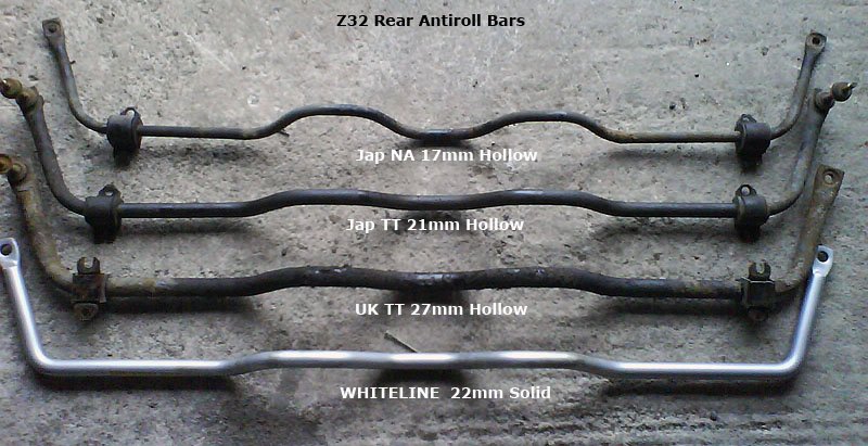

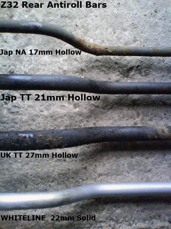

With the recent "Antiroll bar size" related threads recently, and since I had each of the various types lieing around I thought I would take a few pics and measurements for future reference.
The U.S spec Bar shares the same size bars as the UK TT, and the pics clearly show why the U.S Sourced Polyurethane Anti roll bar bushes wont fit the Jap roll bar.
Jap Import Non-Turbo - 17mm Hollow
Jap Import Twin Turbo - 21mm Hollow
UK Twin Turbo - 27mm Hollow
Aftermarket Whiteline - 22mm Solid

LOL @ the N/A one. Looks like a string of spagetti in comparison. As always, UK ARB is rotten! :rofl: ;)
Quite up for getting a whiteline ARB. Pretty good reviews in the US.
yeh lol the NA one sure does look pretty pathetic. The TT antiroll bar (27mm) is a popular upgrade for NA's in the U.S.
I can't believe they are hollow either. I know they have been, but I still don't know why they made them hollow.
Because torsional stiffness is proportional to radius^2 so a hollow bar of slightly larger diameter is as stiff and lighter than a slightly smaller soild one. The extra material in the very centre of a solid bar makes relatively no difference to the stiffness but adds weight and makes it easier to manufacture.
I know you're correct I'd never question that, just wondering why whiteline's are solid? Are they that way for people like me who are not so mechanically literate who think it's an added bonus? Might just stick with getting hold of a good UK spec one and getting it shot blasted/powdercoated.
Would guess just for manufacturing ease or that it's cheaper then buying thick walled pipe the right diameter.
