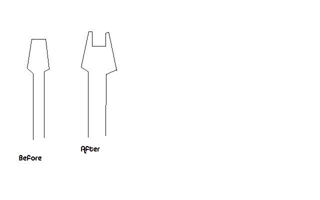

Not ideal, i know! But can you not just modify a slot headed screwdriver like in the very crude drawing below, a grinder should do it :)
